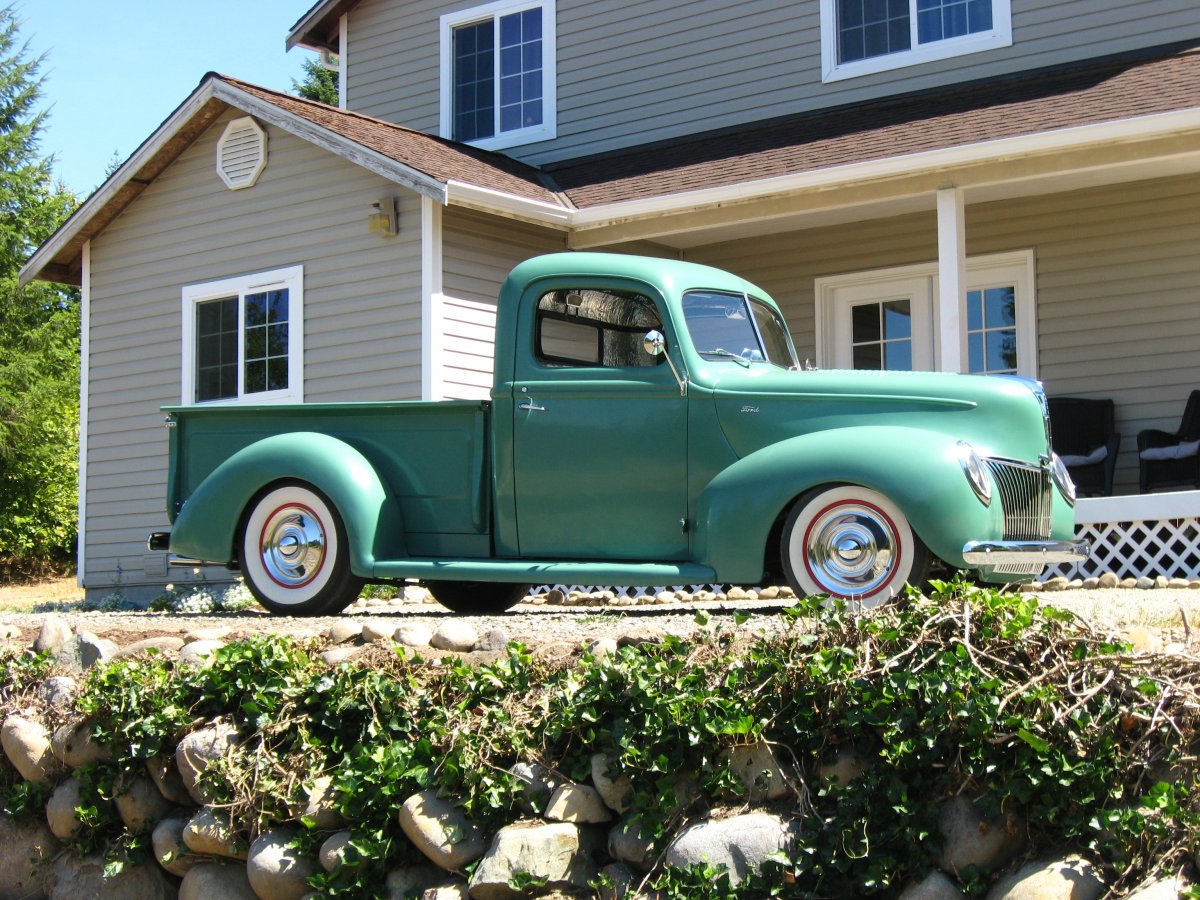

    That is what I used along with 3" lowering blocks, I also opted for their rear stabilizer kit. Very easy to install.
    The front is their MII kit with 2" drop spindles, they use a Heidt's front crossmember. I also opted for their front stabilizer bar kit. IMG_1567.JPG

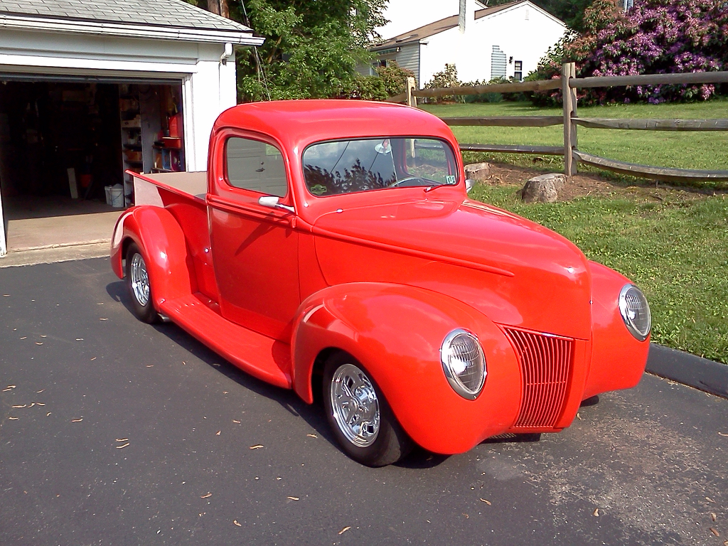

    I did my '40 pickup (actually a '41) with CE rear springs 3" blocks
    4" front CE dropped axle reversed main leaf and sway bars all around 235/75 15" back 8" rim, 185/75 14" fronts on 6" rims
    I always thought it sat nice, see photos, you decide

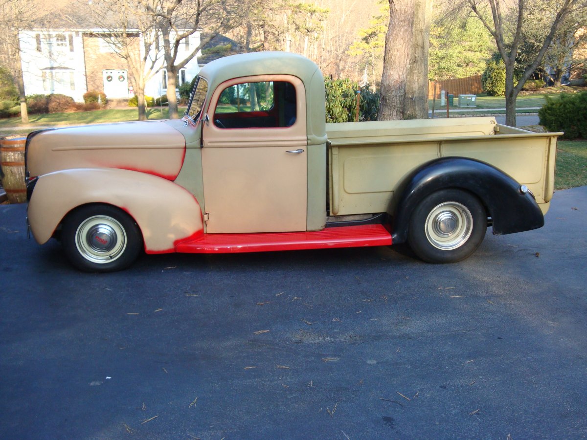

  8. I used Heidt's front crossmember with stock MII suspension with a half of a coil cut off the springs. In the rear I used Chassis Eng. rear leaf spring kit with 1" blocks and their sway bars front and rear. The truck rode really well and you could just get a beer can under the grill in front. Sold the truck several years ago.

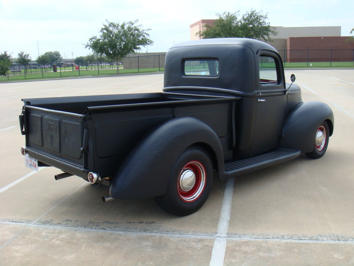

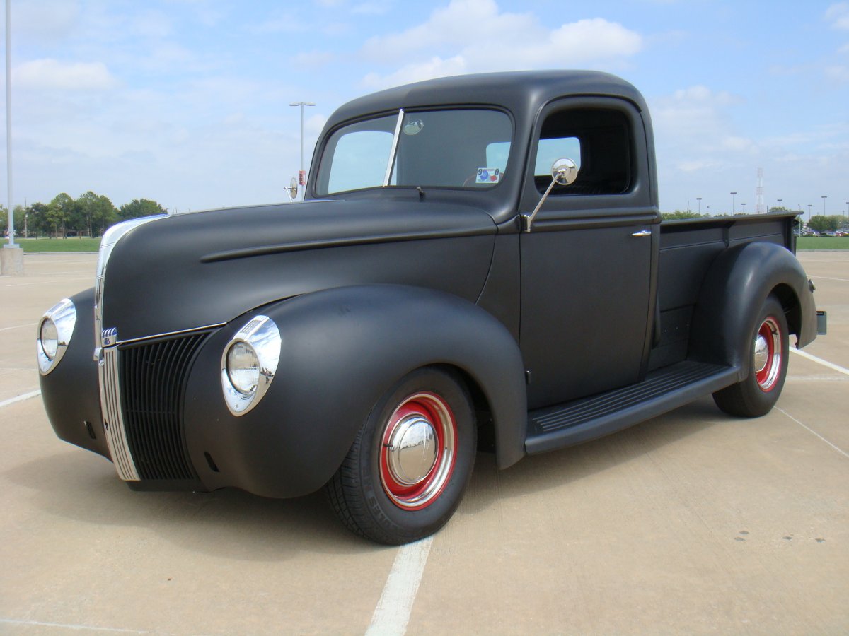

    I also used MII front suspension with a half coil removed with a sway bar. Rear suspension is the CE kit without any blocks. Front rims are 14x6 with 185's. Rears are 15x7 with 235's. Truck handles and rides excellent.

    Olskool32 - Looks like it's got a 2 inch chop and you've shortened the bed. Nice little truck.

    BreadVan- that's correct, 2 in chop. The bed, which was bent up at a truck body shop, is 6 ft about 6 in shorter than stock.
