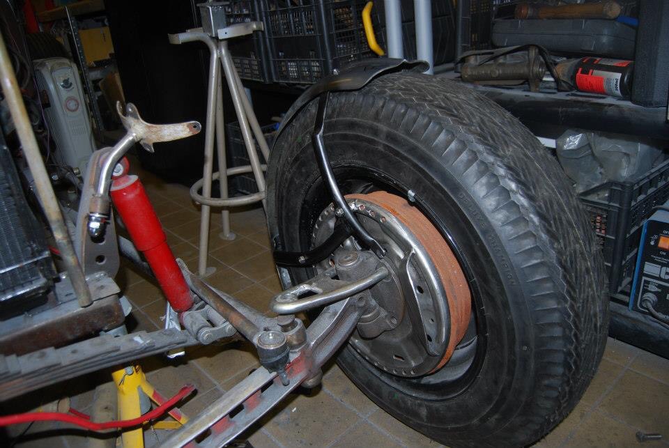

    First, a comment on Jimmy Shine's rod. I admire the clean construction shown in the various photos, no matter who built it or if it has been on a trailer. Nice work!
    The photo posted by Unkl Ian shows the small clevises on the single blade (probably 3/8") batwings. An option is to use the double sided batwings such as those sold by Speedway. These use the larger diameter bolts, 1/2", running in steel sleeves and nylon bushings connected to the bat wings. These would be substantially stronger. Using hairpins or 4-bars will give a space to run steering rods. Springs, shocks, or coil-overs can be mounted to gussets on the hairpins. Like several others, I am in the imagineering process and gathering parts and ideas. I've committed and bought the 4" drop axle and the double sided stainless bat wings. I am leaning toward coil-overs connected to the hairpins but have not bought them yet. The object is to keep just the big smile of a tube axle out in front with as little clutter as possible. Thanks to all the contributors on this suicide axle thread. [​IMG]
