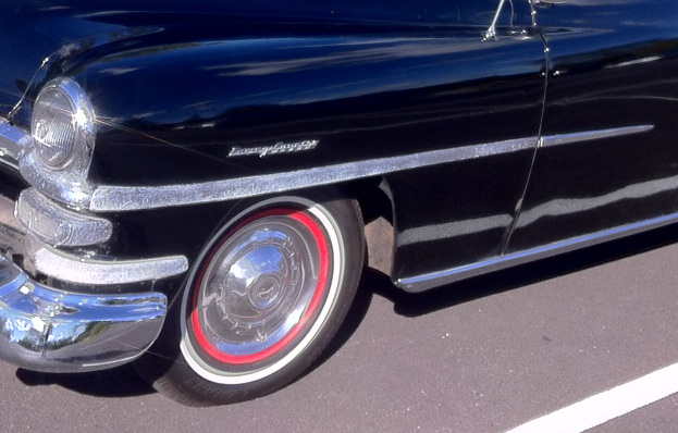

    And yet, I think if I keep my expectations really low, I might still be better off with spotty or peeling faux chrome than the "lunar surface" I have currently.
    The worst part is how the perfect, stainless spear on the door accentuates the transition to pot metal on the fender. It's like looking at a timeline of my complexion from 5th to 6th grade.
