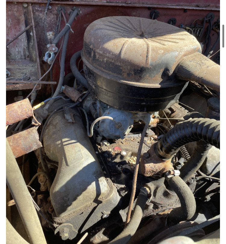

    gotta raise the hood
    This one is in a fire truck.

  25. Now that you say that, the truck I was referring to could have been a 348 too. It was a C-80 with a W engine. I don’t recall any identification on the engine itself.
