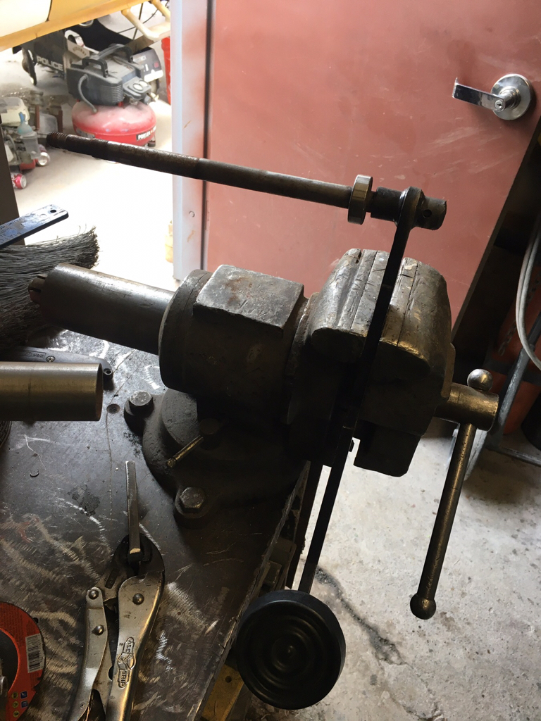

    Speedway.....................yikes ! I have a '34 Ford pickup with a new firewall so I needed a brake and pedal cowl mount setup which I purchased from Speedway. The set up is a normal application consisting of a bracket that provides the brake and clutch arms. I got the thing mounted and it fit the bill and all went well until I tried to mount the clutch pedal to the arm. When I tightened the pedal nut the clutch arm broke off!! The arm didn't snap or bend off it just sorta oozed off like it was applied with silicone. I couldn't believe it. The clutch arm is one piece flat piece of 1/4" steel that was advertised as Made in the U.S.A., and it simply broke off, no warning. I examined the break and could see shiny smooth surfaces on both the the broken arm and the broken off piece. The pieces showed no sign of metal weakness or wear. It was at one time, one piece. I called Speedway and apprised them of the situation and stressed the fact that it was a driver safety consideration and that they should examine the defective product. I was amazed that the worker, Natalie a seemingly nice person on the phone was not interested in viewing anything and sorta just blew me off saying only that I would receive a new clutch arm which I did. I wasn't happy about the new part already knowing their lack of quality control and their non interest in driver safety. The damned thing breaking off in CA traffic could have killed me. I was pissed but unsure about what to do about it.
    While waiting for the arrival of the new/improved clutch arm and I attempted to attach the brake pedal to the existing brake arm that I had just installed. I torqued the nut just slightly and the brake arm and the pedal broke off !! AGAIN !!! It broke in the exact place that the clutch arm broke and had the same shiny smooth area where it broke. See photos. SANY1373.JPG SANY1374.JPG
    I was dumbfounded !! What if this had happened in traffic. I'm 75 and have an 6 year old hot rod grandson who drives me nuts most of the time but he loves riding in my '34. What if....??? It's too terrible for me to even contemplate. I was even more pissed !
    I called Speedway and demanded to speak to a supervisor which I did. She informed me that my situation had not happened before and that she was sorry and that she would send me an entirely new bracket. But that wasn't what I wanted from them. I explained the safety issue, an issue that I thought others could benefit from. I told her that I would send them the broken parts so they could determine the cause of the part failure. She declined, stating again that it had not happened before and that all was well. To my mind all was not well. I could have been killed and as I write this, others may suffer the same consequences. The lady's position that It had not happen before stuck in my craw . Speedway is waiting for another situation involving broken clutch and brake pedals breaking and the consequences of that to happen before possibly/maybe acting to examine the damned faulty product ! What kind of thinking is that ?? The world is getting more and more nuts.
    By happenstance, I received a generic "how'd we do" sales survey from Speedway. I answered right away informing them of the above situation. A worker bee ( a person with no power) sent me an email request for the broken items. I haven't sent them and don't intend to until I can get more information on how best to proceed.

    That is totally NOT how those pedals were designed! They beauty of the design is that the tab is bent from the arm. NOT welded on like yours! Something is fishy. I doubt they would sell them like that as it adds about 3 steps to production. Wonder if they were bought, cut and welded then returned? Got dropped back into a bin and resold.
    And that is a version of the shitty gas pedal I referred to in the other thread. Yours looks better than the 5th grade art project I received.

  7. Good pics,,,,,,,like Tman said,,,,,,those don’t look right. .
    The bottom bend is supposed to always be one part,,,,with the arm,,,,,,formed into a bend,,,,,not welded .
    Those look like crap ,,,,dangerous too .

    1. By the way the arms "appear" to be designed, there is NO need for a two piece arm, therefore, there's NO reason to have a weld in a VERY susceptible location.
    2. PISS-POOR design.
    3. PISS-POOR welding (little to no weld metal penetration). No weld along the side of the arm.
    It sounds like you should do what's asked of you. Return the kit as requested to the person that requested them.
    But before you do, take several pictures from a coupla different locations, including closeup's the the weld(s).

    I'll BET somebody ordered....cut'em....welded 'em ....and then ground ALL the bead off trying to cover their work until they could send them back for a refund!!

    If the part would have been welded correctly it would have never broken . The part should have never been welded in the first place as previously discussed , also . All I can say things like this give us all a bad name when tragedy strikes because of shit parts like this . I do think I would have looked very closely at the pedals before installing , looking at them it’s obvious the welds were completed by someone of the second grade level not a qualified welder . I was always told “ you pay peanuts , you got Monkeys working for you ! “ I’m just thankful no one was hurt , you can replace the broken part , but not the human damages that easily could of taken place . Again , please try to be as safe as humanly possible , peoples life’s are at stake here .

    I drilled the holes in the shank and painted it. Ain't proud, or tired. The part that I'm referring to that broke WAS NOT WELDED ON. Let's get that straight. It was one piece. The broken pieces show no evidence of a weld or a tack weld. IT WAS ONE PIECE. And it was not a "clearance item". It was new. Nobody cut or modified the darned thing. that I can see. Examination of the new part that Speedway sent shows no evidence of a weld either. The piece is smooth and bare metal from end to end. What's important to me is that maybe some guy has a similar set and is unaware of what might happen when he steps on the brake. Somebody please pick up on the safety issue. Are there any legal issues involving the defective brake/clutch arms. The parts are obviously defective. That's a fact and I have the evidence to prove it.. It's a safety issue that might at some point affect any one of us if we continue to kick the can down the road. What can be done ? Must some poor slob maybe die or become injured because, according to Speedway, that's a condition that must happen before any inquiry ? Am I missing something somewhere ?

  22. So the pedals actually are made from one single piece of plate (as they should be) and they BOTH broke in the exact same spot, leaving a perfectly straight cut line when they failed? How is that even possible? Did they hold the pedals in a shear when they bent the ends?
    MCjim, Blues4U, 210superair and 4 others like this.

    From what I can see the pedal ends were cut off and tack-welded back on. If you want to know for certain, call Speedway, find out what the overall pedal length should be from the pivot bolt to the center of the brake pad bolt hole. I think you'll find your pedals are a few inches short.
    Also, from what I can see, the holes you drilled in the clutch pedal are way too big and seriously compromise the strength of the part. Best of luck with your project.

    Extremely unusual for 2 to break so cleanly in exactly the same spot.
    Maybe they were cut and siliconed on.......
    I would not recommend drilling ‘lightning’ holes in such a crucial part either !
    You really need to post more photos of the broken ones and the new ones if you want some educated opinions from the good people here.........

    Unfortunately the pictures aren't focused on the break as it would be interesting to see what the metal looked like there. But even if they were originally good parts, the holes you drilled in the metal would be a safety concern to me.
