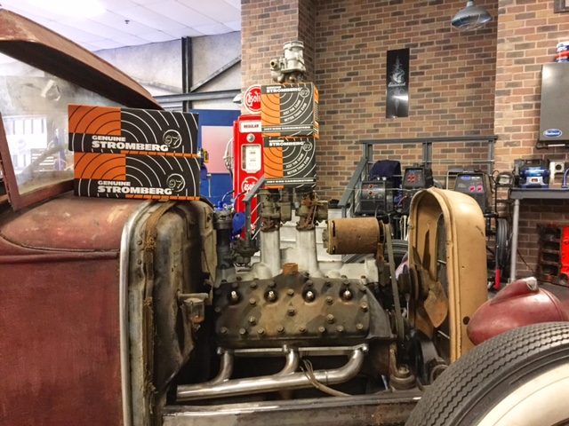

    Courtesy discount on all Genuine Stromberg carbs and parts is extended to anyone reading this.
    I am also the U.S. warranty guy - what little there is - No questions asked; parts, labor and free, fast return shipping.
