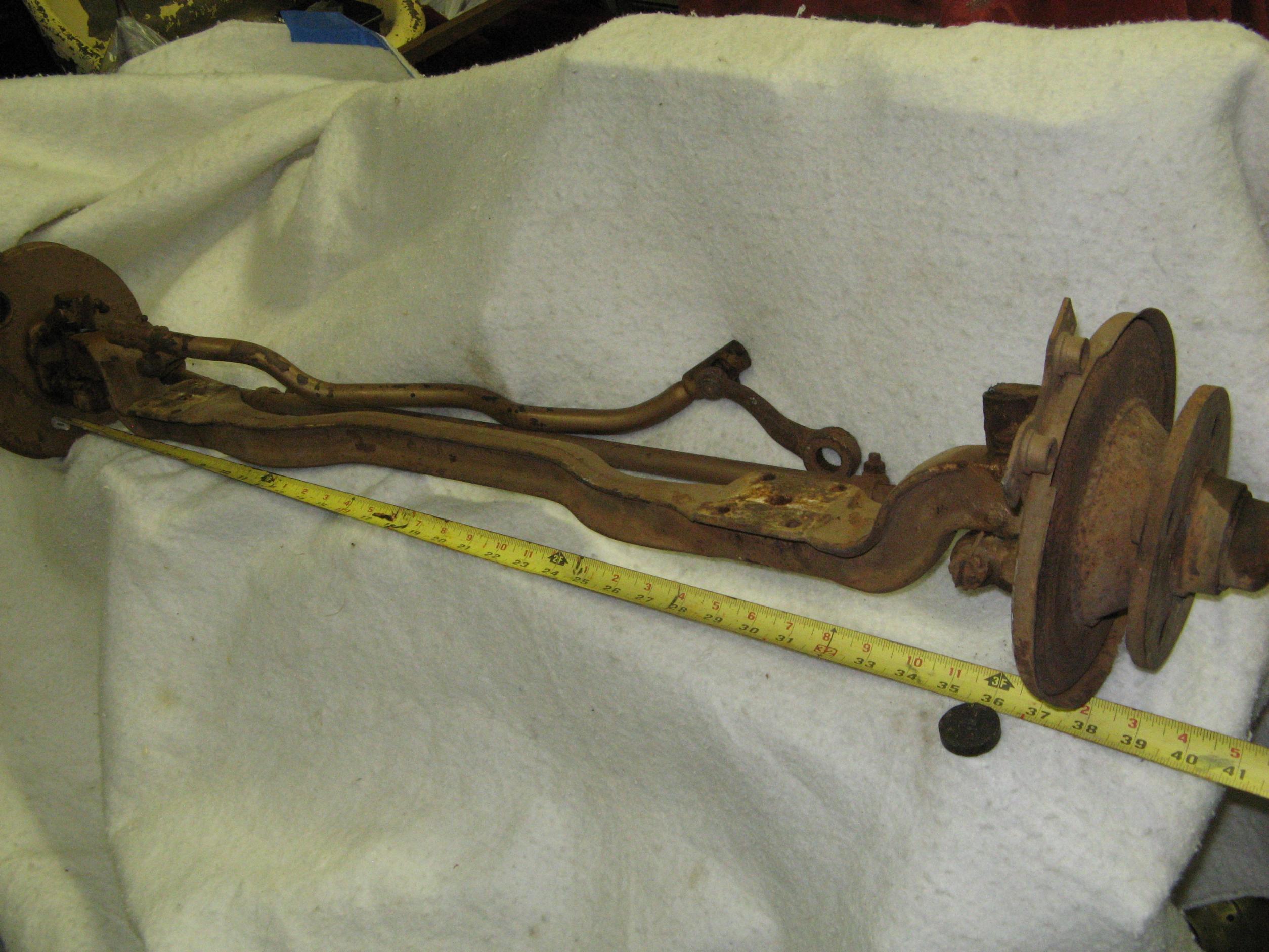

  28. One other thing to throw out besides Econoline or Speedway... somebody had a thread on here recently that showed Jeep "mail truck" front axles...
    Found it; 8FLEET9's Nova street freak thread.
    A couple quotes:
    Just a 'plan c'.
    BTW, for anybody who's into the idea of discs and wants to go traditional, you can look into Crosley stuff; I remember reading about those in some old '60's mags.
    -Bill
  29. jpm49c
    Joined: Nov 23, 2006
    Posts: 397
    jpm49c
    Well, a Crosley axle is not the strongest. The king pins are only 1/2" and 36" from pin to pin. That little black dot is the disk brake pad! Yes it's 1 1/4" across. Rotors are about 7 1/2" . And this is the heavy duty axle .
    John
