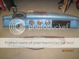

    I picked up a 55 Ford passenger car dash. I think it will look great in the 34. It is a wrap around type that extends onto the doors. I still need to pick up the side pieces from the guy. Not sure if I'm going to install the door sides though.
    Below is a pic of an original 34, as you can see I have to narrow it alot. I'll probably remove the glove box section and keep the center controls section. Not sure yet.

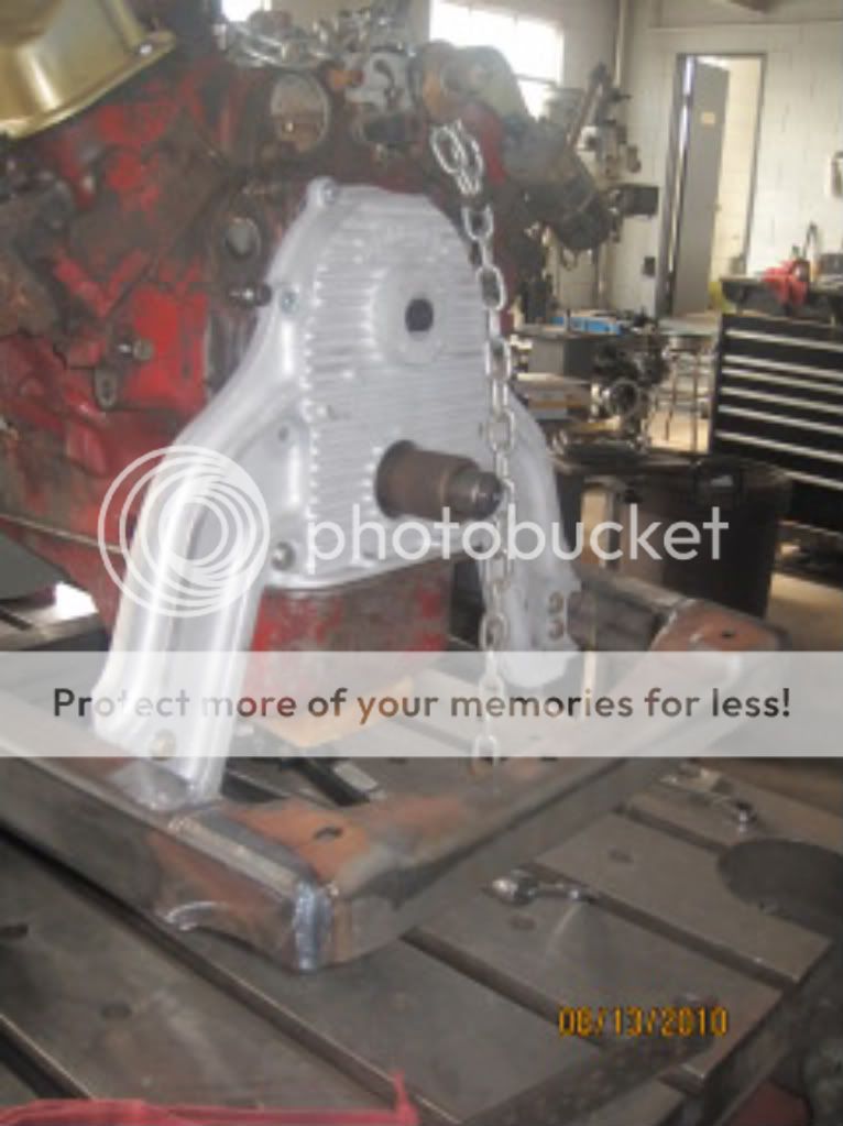

  13. <HR style="BACKGROUND-COLOR: #000000; COLOR: #000000" SIZE=1> <!-- / icon and title --><!-- message -->
    couple shots of my rear wheels and front motor mount plate installed at HRCC.
  14. some more eye candy frome HRCC.
  15. Jeff Norwell
    Joined: Aug 20, 2003
    Posts: 14,846
    Jeff Norwell
    MODERATOR
    Tell me about that funky Front mount... and I see your running a 5 speed.... what kind of bell/adapter?Are you running a tremec?
    Jeff
  16. Whoa! That front mount is rad!
  17. The front motor plate is an aluminum Diebolt. The 5 speed is a Tremec TKO600.

    That front motor plate is wild.... looks like you won't need an arm rest with that transmission sitting next to you........

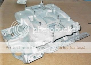

  23. What intake are you going to run on your FE? just curious.
    I just bought an Edelbrock cross ram as something a little different.;)

    The front mount is spelled "Debbold". I've not seen another, but I'm sure they must have made them for more than just FE. I'm sure there is a vintage boat guy on here that could illuminate all of us on them.

  25. A little something different for the FE from the sea of tripower and six deuce set ups.

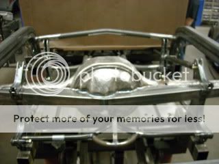

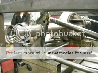

  27. Not much of an update but the chassis is getting an 8pt roll bar now. I am going to go to the track with the truck now and then so I need it to pass tech. Found a donor door to fix my passenger door thats FUBAR.
    New rearend is being built this week.
  28. some more progress...
