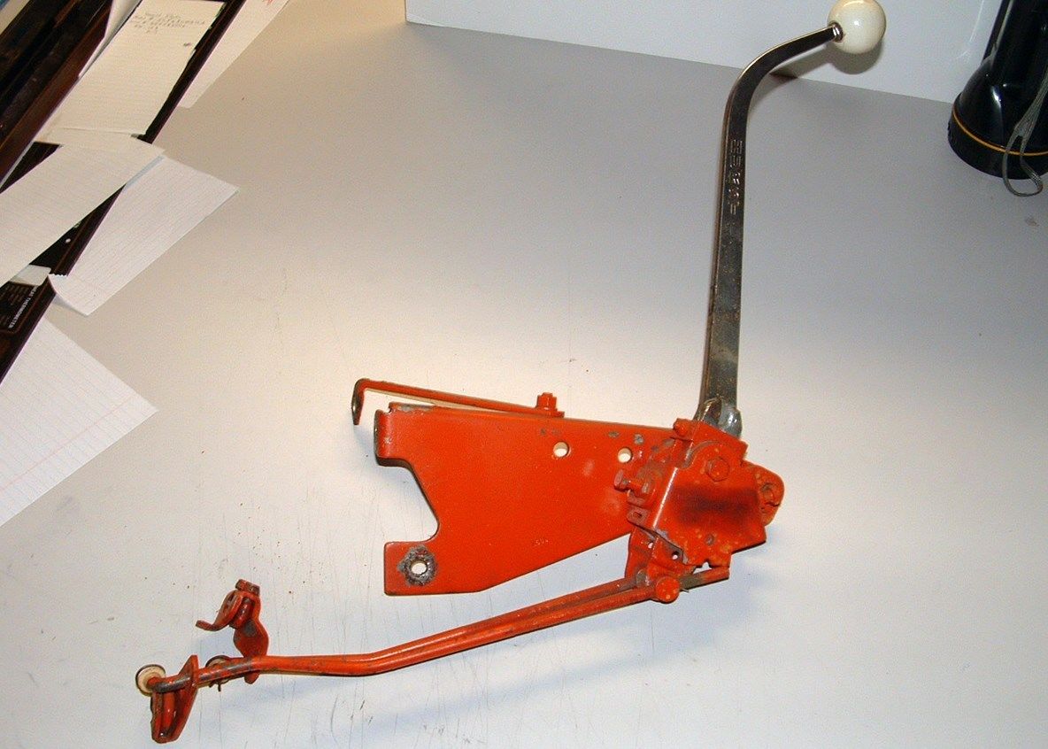

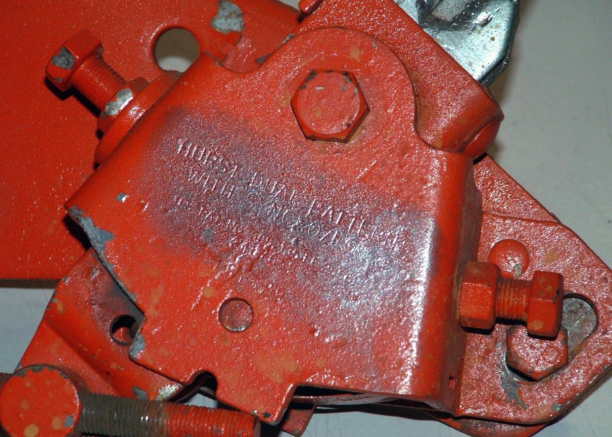

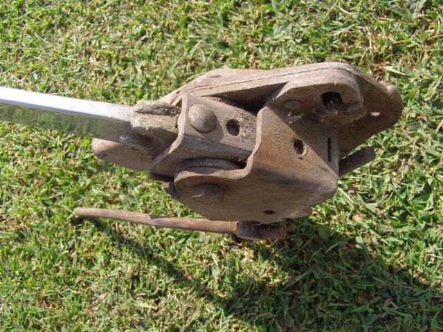

    I'm not very savvy when it comes to these shifters. I've seen alot of information here on the HAMB, and it looks like I'll need a Hurst 4954? My next question is: I see these on the Bay - the part numbers I see don't jive but they all look the dam same. Here's one I'm looking at. But I just sit here and wonder...will it fit? HurstOrg.JPG

  20. 56sedandelivery
    Joined: Nov 21, 2006
    Posts: 6,695
    56sedandelivery
    It looks more like it was for a Tri-Five, but you should be able to modify it to work. You mount the arms to the trans so they are facing "UP", and have to file a groove in the shaft for the bolt to clear. You may also have to move the shifter "tower" forward or backward. Use a 1/4 inch drill bit through the shifter tower levers to set the neutral slot and adjust the rods to fit the transmission arms. You may have to drill a large hole for the speedometer cable to pass through the shifter adapter plate. At least the "floorboard hump" is removable to make the job easier. It may take a little work, but you should be able to adapt that shifter fairly easily, if not even having it just bolt right in. I am Butch/56sedandelivery.
