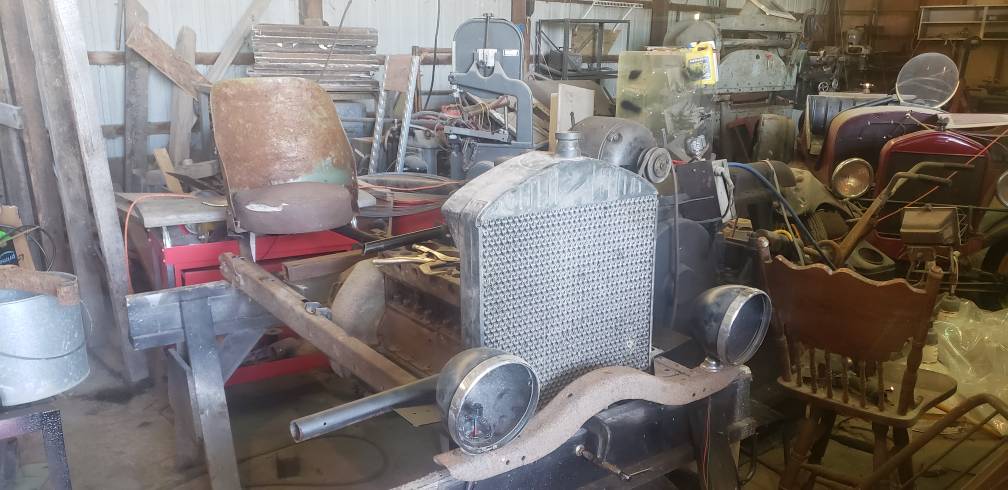

  5. Finished the radiator shell for the most part... it got its coat of primer sealer. It started as a 24 overland radiator shell that had been beat to hell and back... I had to weld up a spot that had ripped, and a ton of dent repair. I got it close to smooth, and then laid some filler to fill the worst of the pitting, sanded it smooth, fill primered, and glaze puttied to get it as smooth as I could, sanded again, fill primer again, wet sanded with 800, primer sealed. Massive improvement from the rusty discarded shell that was in a scrap pile, and I still have the original overland radiator badge. Image~2.jpeg

    I'm sure glad you came back with a pic. of the shell. I was afraid I was going to have a Sunday morning lack of picture problem!!!! I like something different! The top and tapered side look similar to a 24 Chevy, but the bottom corners are by themselves. Great Save!

  8. Overland shells are pretty cool... the overland chassis is even cooler, its 4 quarter elliptical springs, 2 in the front, 2 in the rear at roughly 45° angles... wish I could get one.

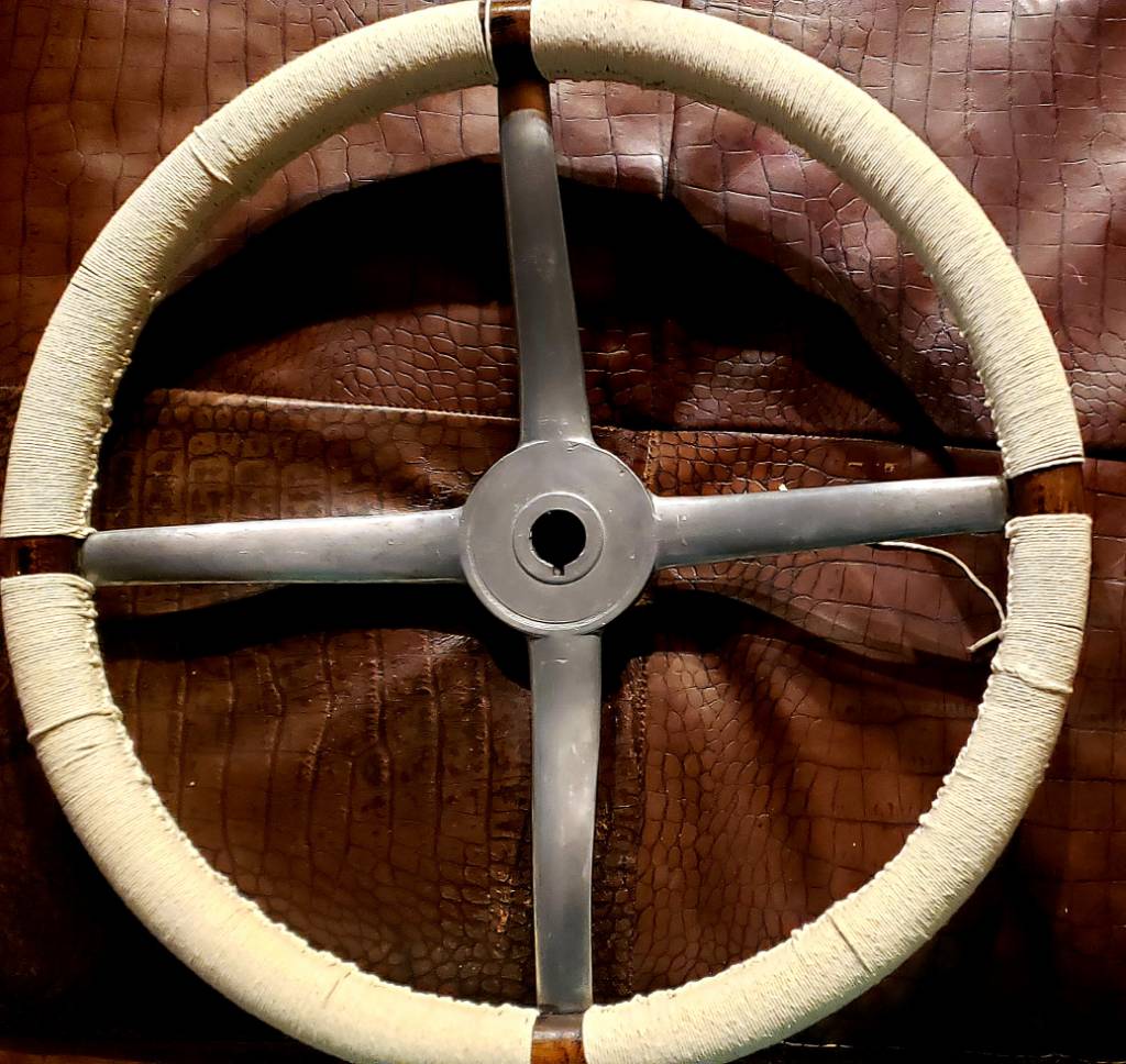

  12. Almost finished with the frame modifications, and waiting on engine parts, so I decided to refurbish this 17 inch wheel. Sanded it down, refinished the wood, did a minor polishing to the spider earlier this week, and then decided to spend the better part of the day wrapping my wheel with cotton cord just in case it rains. 20201128_233219.jpeg
