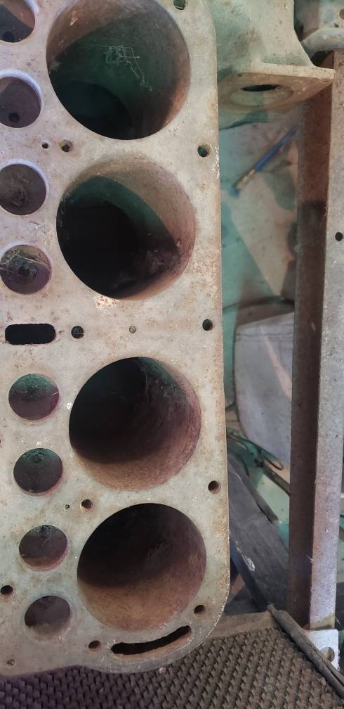

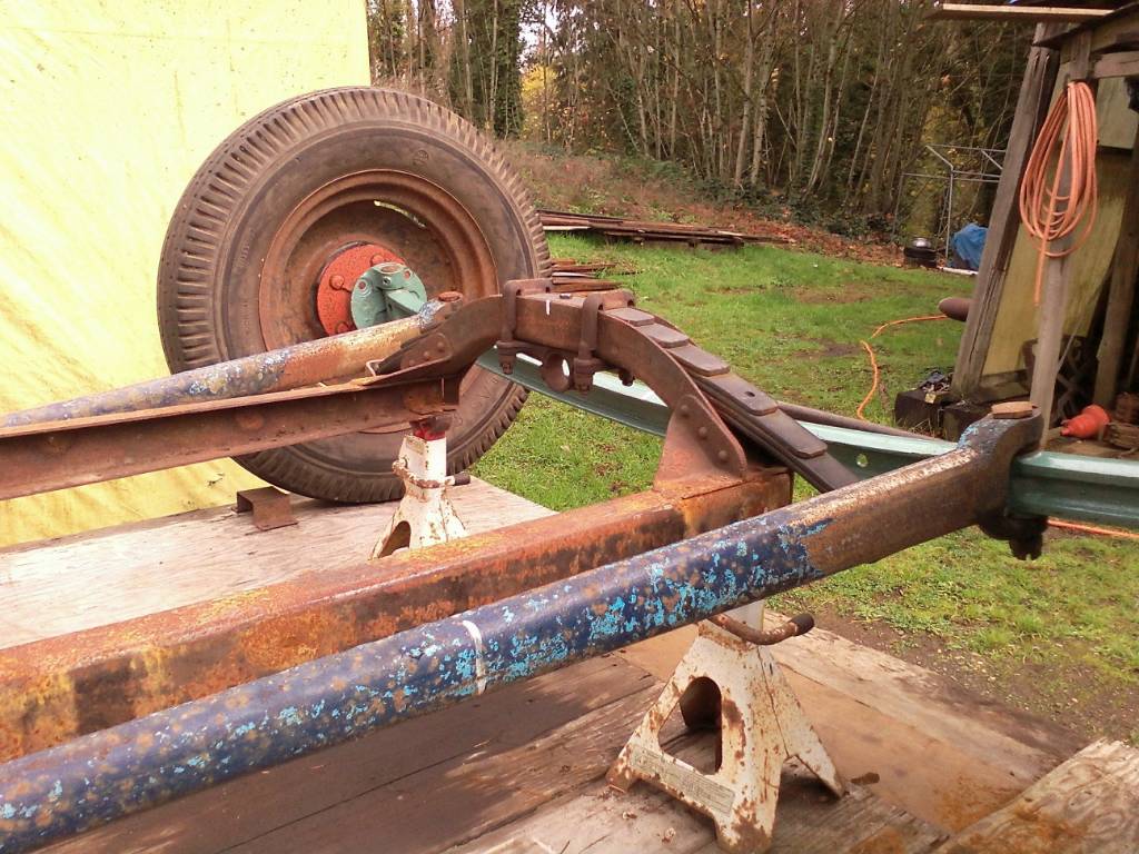

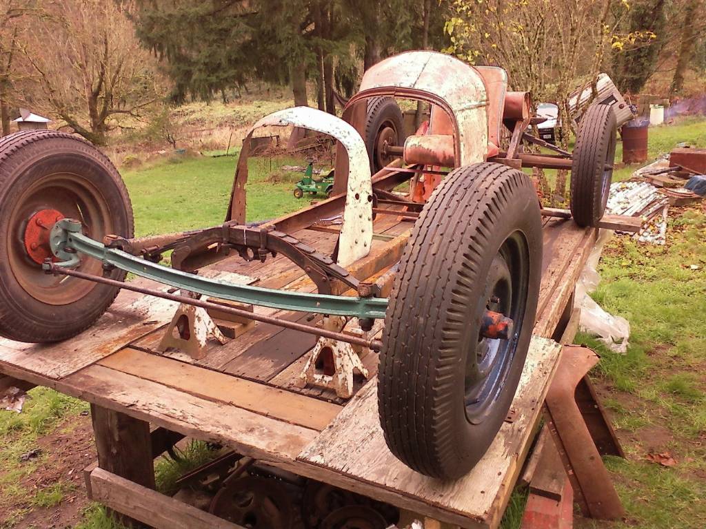

  1. Its been quite some time since I have posted on here, but since Covid-19, I've been chugging away on a few projects and doing some things. I was gifted a motorcycle, which I traded for the parts needed to get further ahead on my parts collection. I have enough parts now to finally build a speedster out of parts I was given from people throwing them away or selling. I have a Canadian 1916/1917 unused block (never installed in a car), a 1917-1927 front axle, 1917-1925 rear axle, frame section from a 26/27 T, 4 quarter elliptical springs, 17-23 low radiator, a crown vic police partition, and various other parts. My hope is for a single seat speedster/race car, and hopefully I can get the frame/suspension built so that I can build the rest. Here are some of the pics. If anyone wants to give advice on quarter elliptical springs and technical support, or have parts to donate, I'm all for it! 20200920_154045.jpeg 20200920_153801.jpeg 20200920_153748.jpeg 20200920_153732.jpeg 20200920_153658.jpeg 20200920_153644.jpeg 70695%20(1).jpeg 15Gerber.jpeg

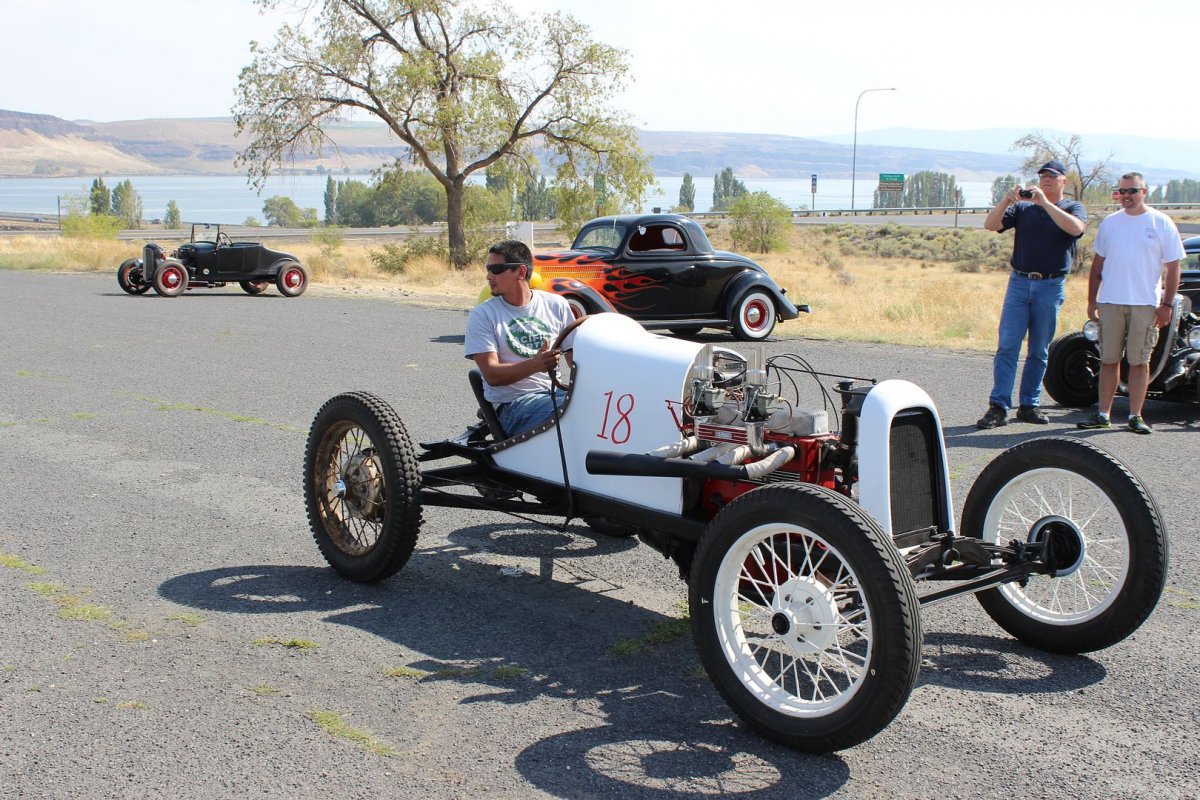

    4CDD3E59-B8FE-4544-A012-149B10DE19BC.jpeg One of my favourites.........

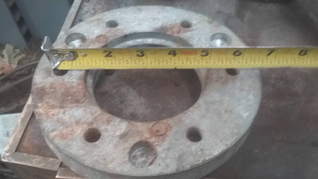

    Ok...I have not been around for years...only 59 ...but
    I looked at the application chart and I did not see 6 on model t wood wheel 6 pin hub...if it was it would be wide 5 on 6?
    I thought I would check things out, I didn't have a wide 5 adapter for 6 pin , so I used a adapter for a 6 on 4.50. The 6 being the example for 6 pin..
    Things just don't line up..it would have to be wide five on model t wood spoke hub 5.25 6 pin?
    Gee...
    I dont know...maybe I'm not old enough.?.
    Unles ......oh ya...weld them on ? Re drill the adapter?

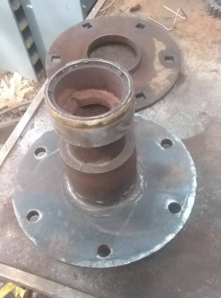

    Directly bolt on ..just don't see it. 20200921_115738.jpeg 20200921_115700.jpeg 20200921_115830.jpeg 20200921_115925.jpeg 20200921_120158.jpeg 20200921_120304.jpeg 20200921_121037(0).jpeg

    What?...not trying to start any arguments..you just made a comment on putting wide 5 wheels on a original model t wood spoke wheel hub...part of this forum is spreading or sharing info...preferably for the purpose of helping some one.
    I was curious about this, I'm aware of the wide 5 pattern being used in racing also originally on '36 to '39 ford cars.
    Also I know about the wide 5 adapters.
    I am also aware of Speedways parts, racing and hot rod, the adapter that you showed a picture of is a wide 5 adapter, be it for hot rod or race, they adapt modern 5 on 5,50 ,5.25 ,5.75 ...to wide 5.
    Knowing this stuff ...I just couldn't see how this adapter fit a ford model t wood spoke hub , original or race , just was asking how this could be done ...if they have been doing it for years how...you said you were looking into that conversation, then you show a picture of a part that ,as far as I could see by looking and measuring a actual model t hub ,how it would work.
    But then you brought up ..model t hubs are 6 on 5 per ford.?
    This hub adapter I have pictured is a 6 on 4.50
    What is 6 on 5 per ford mean ?
    Normally 6 would be the number of wheel studs , on would be the hub/bolt pattern size( 5", 5 1/2", 4 1/2" and others)
    So what is the 6 on 5 per ford ?
    The ford model t wood spoke hub is a spindle mount (direct fit ,one nut,) but it does have 6 bolts and a flange with 6 holes that hold the wood spokes to the hub , that has 6 holes in it.
    So a adapter would be 6 on wide 5.?
    The wood spoke bolts on the t hub are 5 1/8" c.c .
    A 6 lug trailer, Chevy or others bolt patterns are 6 on 5 1/2"..
    So if old hot rodders and sprint racers were bolting 6 lug trailer wheels on there model t hubs ...how did they do that?
    I do know that there are wide 5 trailer hubs and the wheels are just rims ,hoops or rings that are held to the hubs with cleats and nuts on to the hub studs...semi trucks had a similar set up , the California wheel, ...
    The wide 5 ford or race wheels have the hole fabricated into the wheel itself that hold it on the hub with nuts.
    Model t hub ...6 on 5 per ford?
    Sorry to take up your space and time but I just couldn't under stand or see how or what you say they have been doing for years.
    Sent from my SM-T387V using The H.A.M.B. mobile app

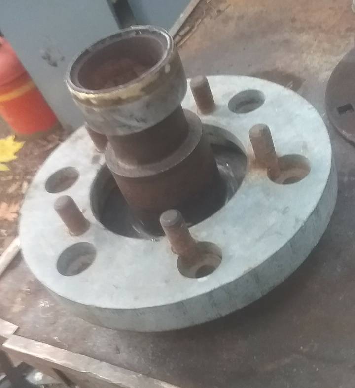

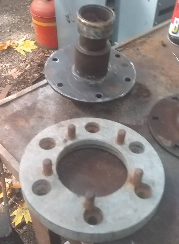

  23. https://www.speedwaymotors.com/Wide-5-Wheel-Adapter-to-6-Pin-Sprint-Car-Hub-Pattern,29220.html
    It fits the 6 lug t wood hubs.
    Sent from my SM-N960U using The H.A.M.B. mobile app
  24. In many cases, people welded the wheels to T hubs or bought accessory wheels that fit. Its rather simple bud. I think you're over-thinking it.
