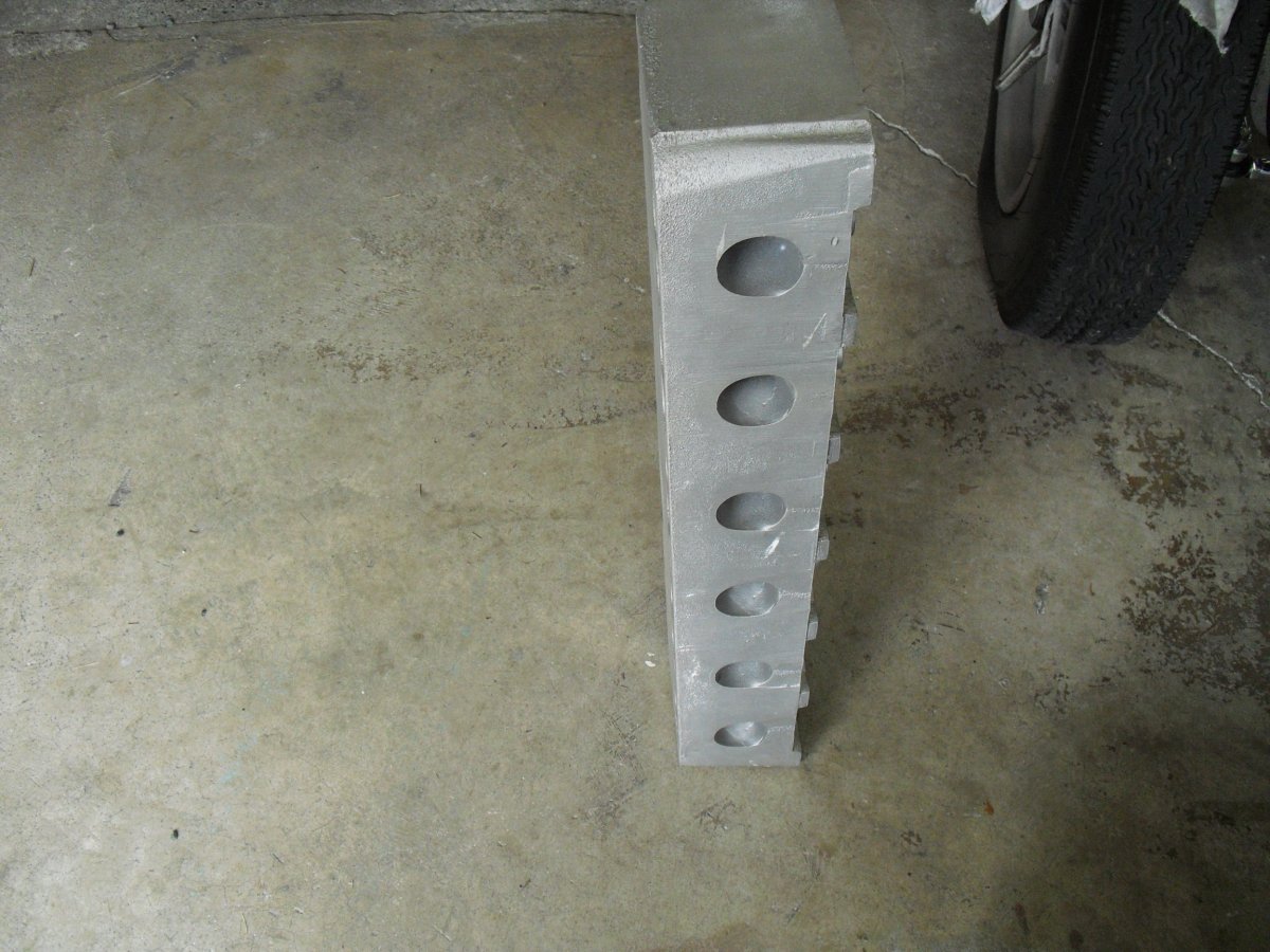

    Its a raw casting, although I have original accessories (Valve cover and side plate) to go with it. Got N.O.S. rockers, but need a bunch of other parts and even worse, a bunch of funds to get it done.
    Here's a picture of my avatar. Gene ran Bonneville in 1949 ( A rpu with a 12 port) 1950 ( 32 roadster with the 12 port) and 1951 ( track nosed 27 T roadster with the 12 port)

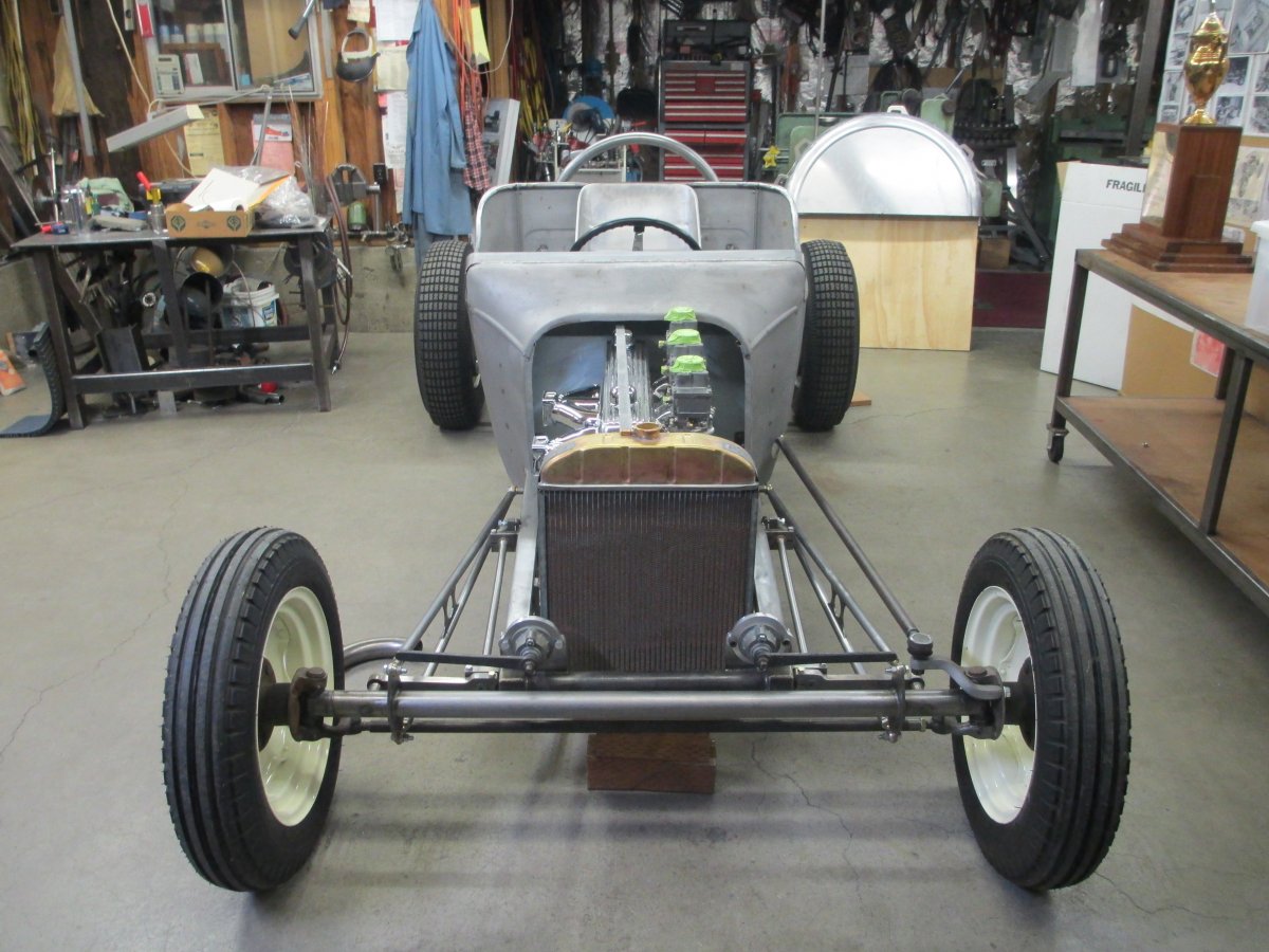

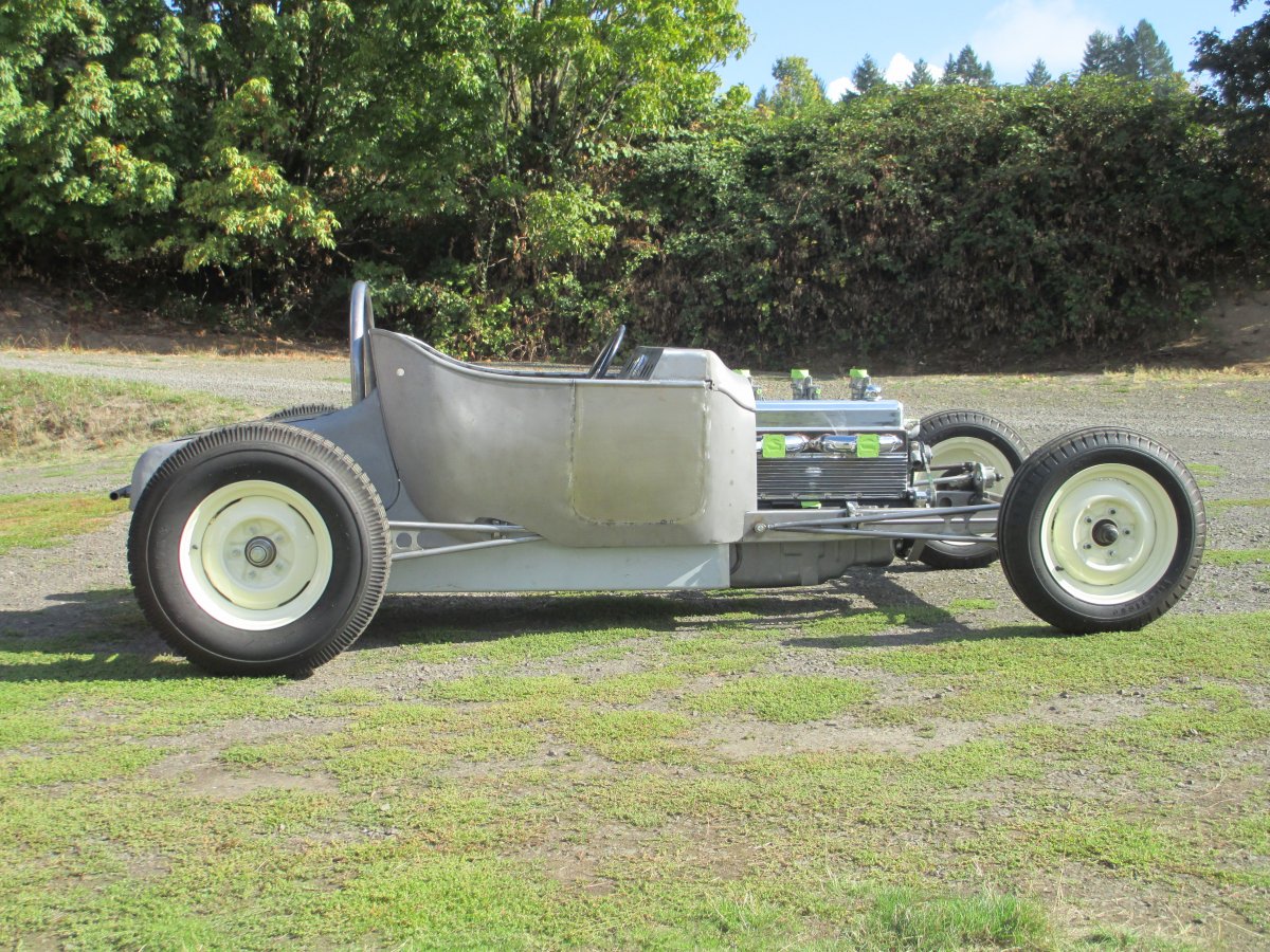

    Saturday was such a nice day, I rolled it outside for some pics. IMG_0708.JPG IMG_0712.JPG IMG_0718.JPG

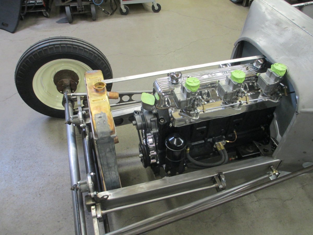

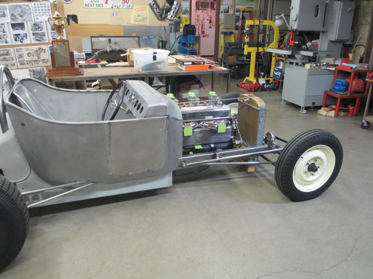

    Today, I opened the radiator box that Pat brought up, what a great piece of workmanship. I am not going to mount it until I have the track nose in place. Meanwhile I ordered some 2-1/4" J-Bends for the exhaust, and am currently searching for a tapered cone with the correct dimensions. The diameter of the side pipe will be 3-1/2" and will need some shaping to match the side of the body. IMG_0719.JPG IMG_0720.JPG IMG_0721.JPG IMG_0723.JPG IMG_0722.JPG

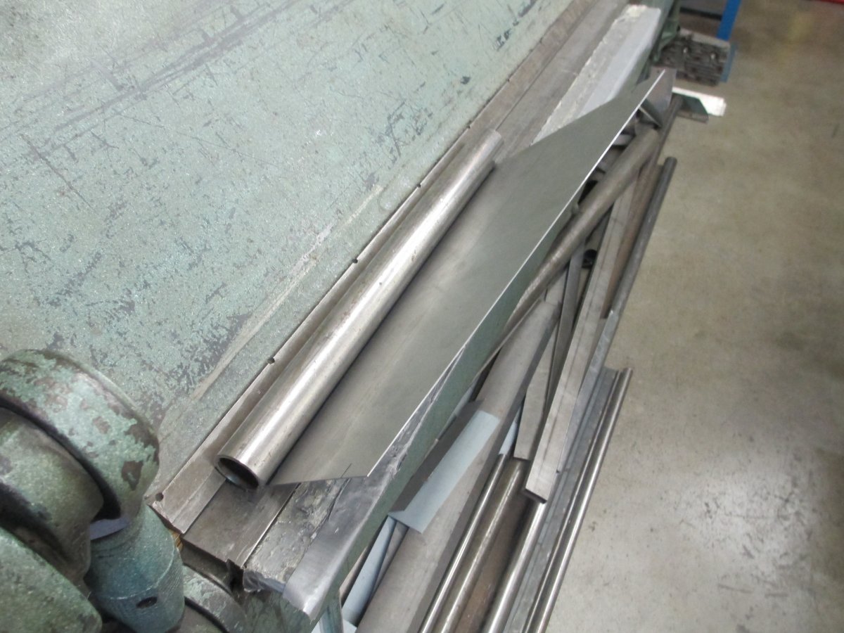

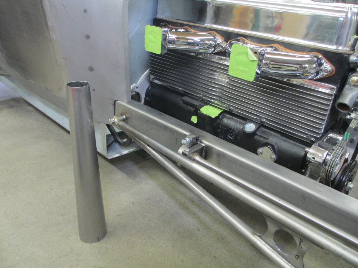

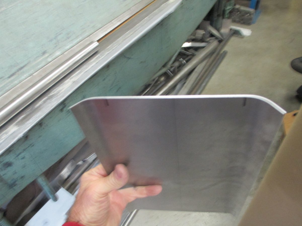

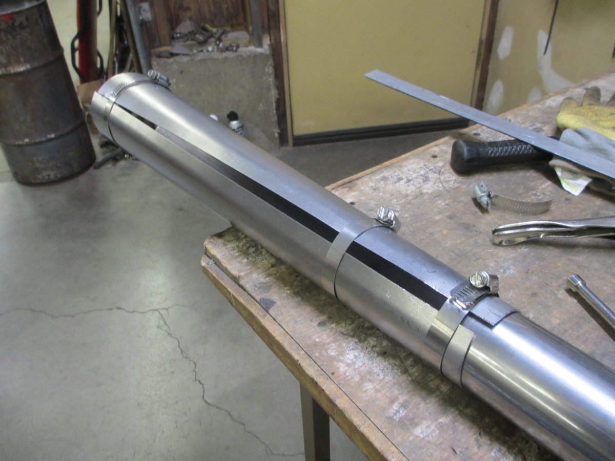

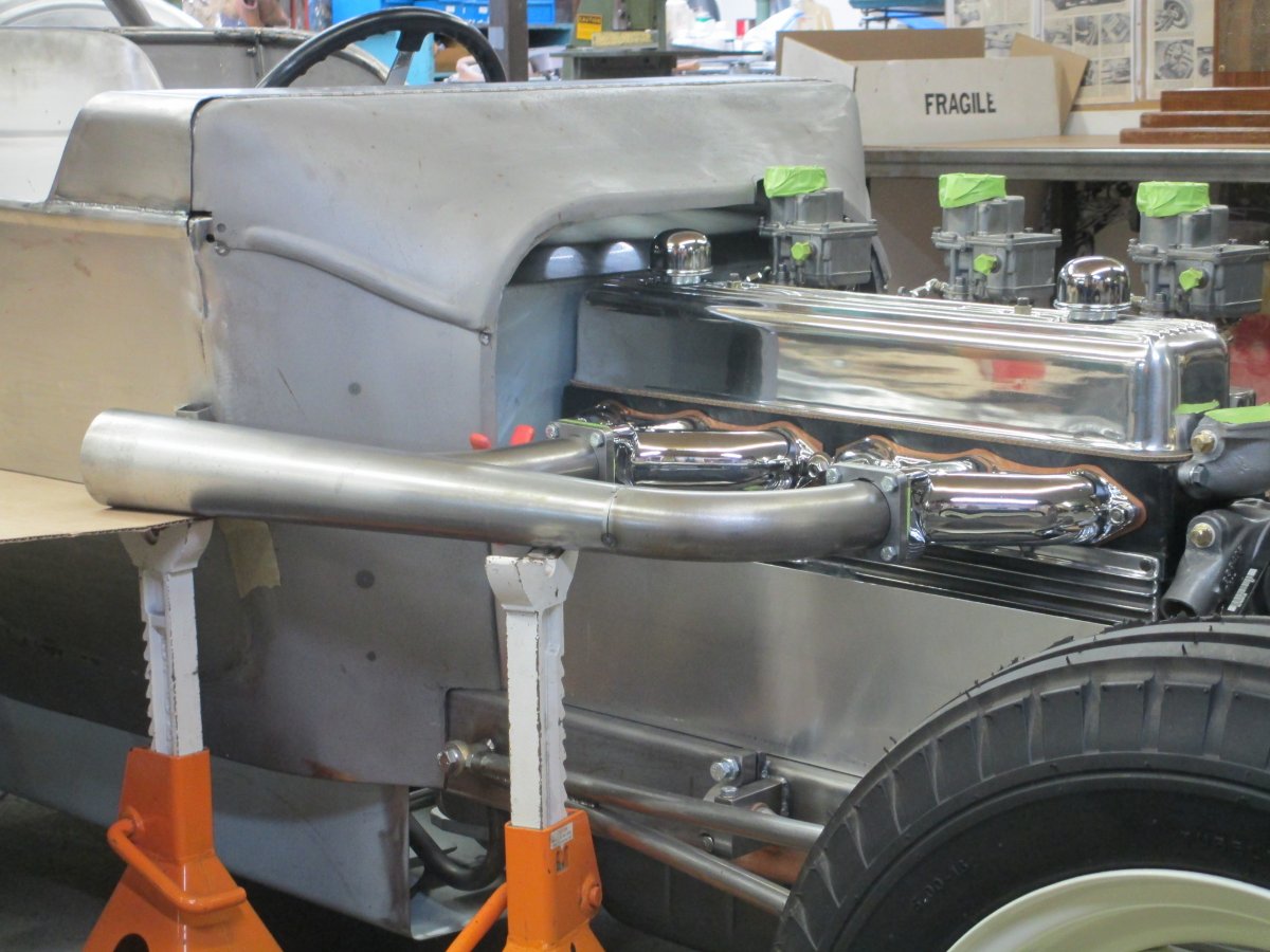

    I ordered and received two 2-1/4" J-bends for the exhaust system, and was having a problem coming up with a tapered cone with the correct dimensions, 2-1/4" on one end and 3-1/2" on the other end, around 20" long, so, I decided to make one. Starting with some 18 ga CR steel, and using PI times diameter, I sheared the material to a taper, then curled both edges in the brake. Next , using a slip roll, I formed the cone as close as I could, giving the fact my rolls are 2" in diameter. I was unable to get the small end formed tight, so I used some hose clamps to close the gap, so I could tack weld the seam. Using a round bar on the inside, I hammered the seam into shape. It took a little squeezing and hammering with a plastic hammer to finalize the shape, but it will work out fine. IMG_0724.JPG IMG_0725.JPG IMG_0726.JPG IMG_0727.JPG IMG_0728.JPG IMG_0730.JPG IMG_0732.JPG IMG_0734.JPG IMG_0736.JPG

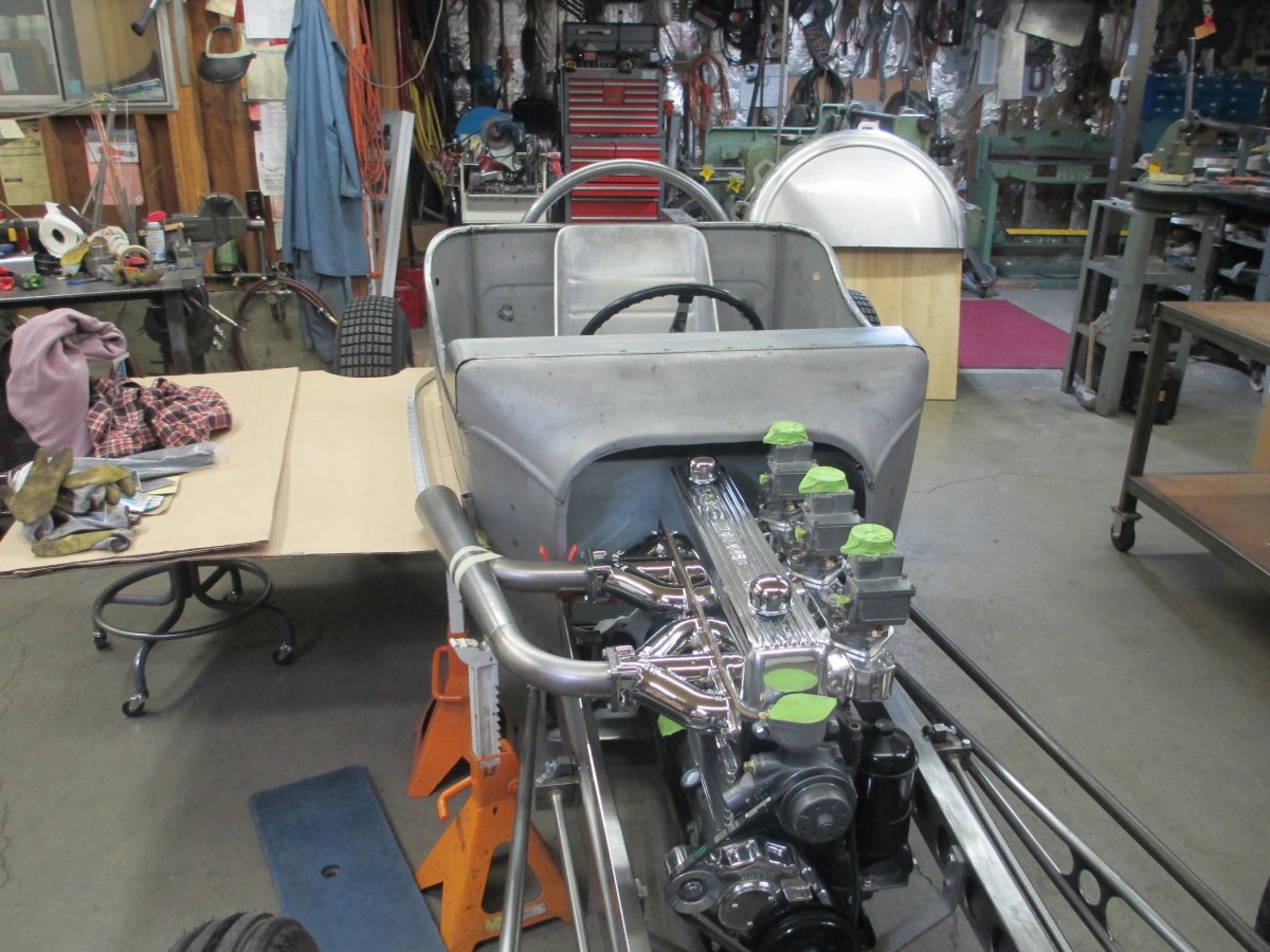

    I started the mock up for the pipe, deciding where to trim the bend for the correct angle down the side of the car. The pipe on the original, was only about 3/4" off the side of the body, and flat with the frame rail. IMG_0737.JPG IMG_0739.JPG IMG_0742.JPG IMG_0743.JPG IMG_0745.JPG

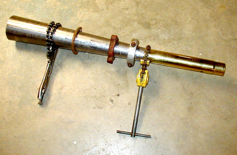

  20. THE FRENCHTOWN FLYER
    Joined: Jun 6, 2007
    Posts: 5,367
    from FRENCHTOWN
    That's about how I did mine on my champ car, using everything I could find that would squeeze the final cone progressively down to its desired dimensions - chain vice grips, header flange, pipe flange, rod end, chain vice. sr021.jpg
    1947knuck, chop job, brEad and 8 others like this.

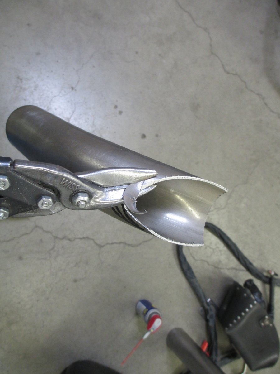

    I was unhappy with the thickness of the flanges I made, so I had a pair laser cut out of 3/8" material. Also my math when making the tapered cone was correct, I failed to remember that u-bends always seem to measure smaller in the bend area, like .025 smaller. The connection at the cone was not optimal, but I am lucky to have friends. An old friend, Dennis Murray, builds superbike exhaust systems and had a cone that necked down to 2", and I was able to trim it to the right diameter. When making the "shoe" connection on the rear pipe, I use a combination of band saw, tin snips, and belt sander. Then, with a little shaping on the horn of the anvil, the fit is pretty close. Notice the gap at between the 3/4" spacer and the cone, on the final fit the space between the body and pipe will be 3/4". IMG_0756.JPG IMG_0757.JPG IMG_0758.JPG IMG_0762.JPG IMG_0764.JPG IMG_0766.JPG IMG_0768.JPG IMG_0769.JPG IMG_0770.JPG IMG_0754.JPG
