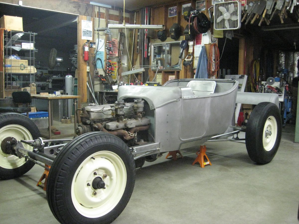

    Pat, I am glad that you and Anna are happy with your car, you have been more that patient with me on this project. With it sitting on the floor and having the body on, I am relieved about the proportions of the car. To me most unique feature of the original car was the long hood, and the Ingels nose mounted ahead of the axle. From the face of the cowl to the front of the grille is going to be around 43-44 inches, which should render the long "skinny hood" look, that we are trying to achieve. Firewall coming up !

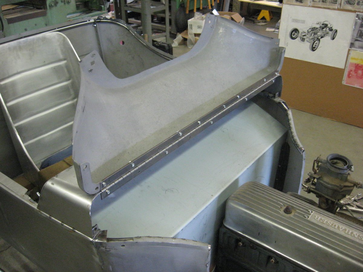

    I got over another hurdle today, with the installation of the firewall. It is removable for painting purposes, just clecos for now but it will be bolted in with 10/32 machine screws. Also, I was able to clip the tack welds loose on the upper cowl, and the hinge works great, just like the original ! Now I can trim the rest of the flange off of the top body rail, hammer it over and skip weld it. IMG_7005.JPG IMG_7005.JPG IMG_7010.JPG IMG_7011.JPG IMG_7009.JPG IMG_7008.JPG IMG_7007.JPG

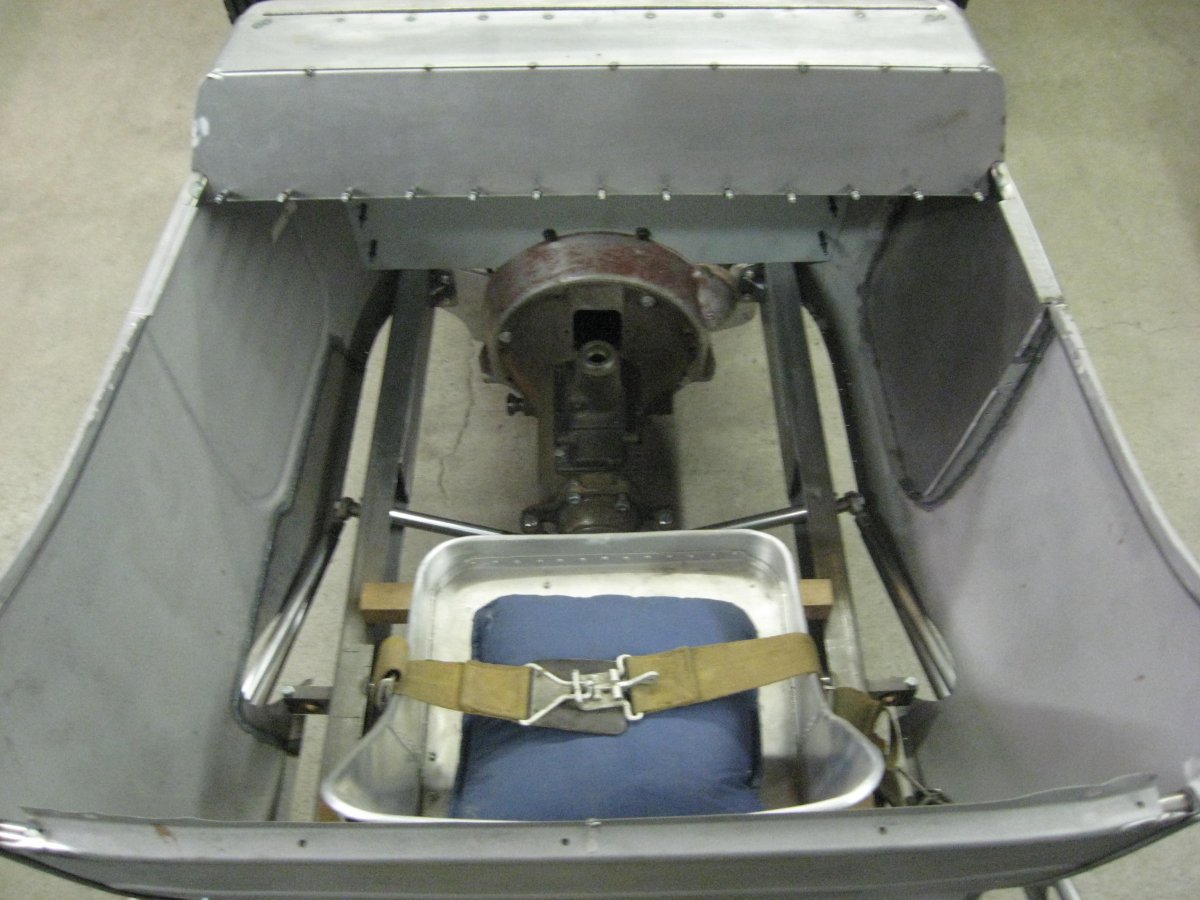

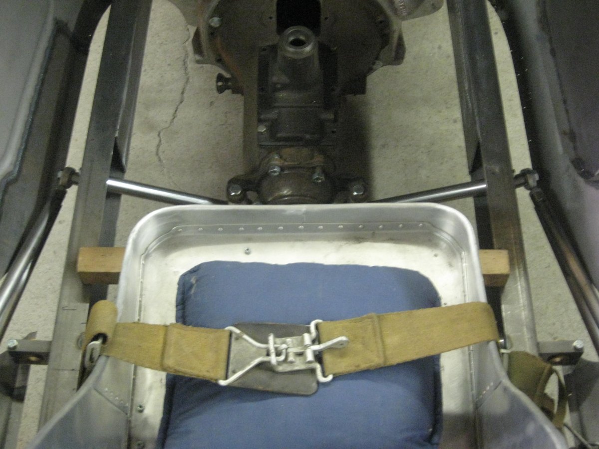

    Mark, I just sat in it, and I am sure Pat will fit. The plus is the belly pan, the foot rests will be at least 10" below the top of the frame.
  25. Love the lap belts. Kurtis had a stash of those and I ran one just like that in my 1/4 midget. Another one kept me in the Studebaker when I took it flying.
