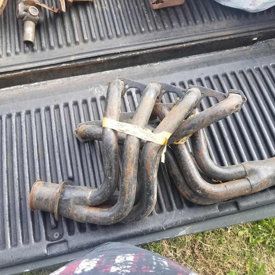

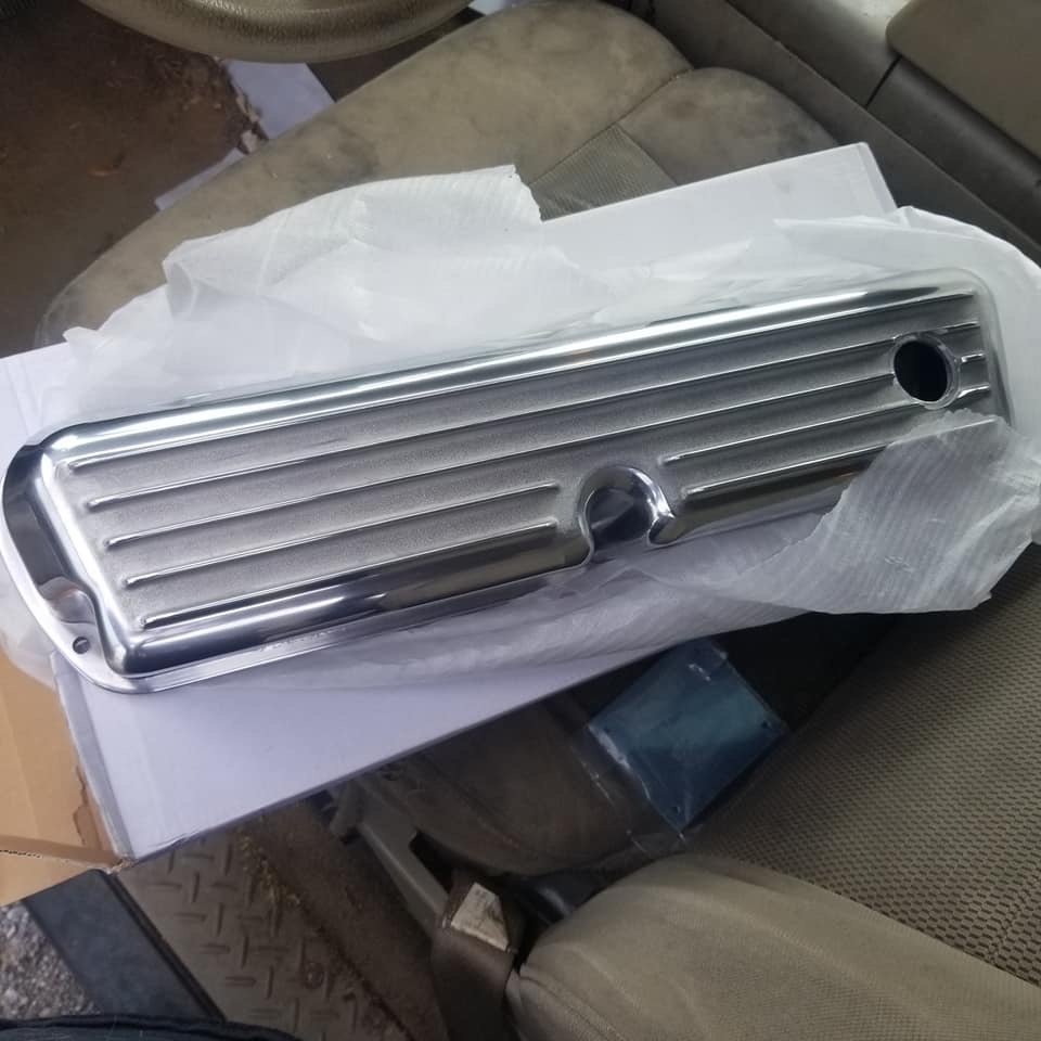

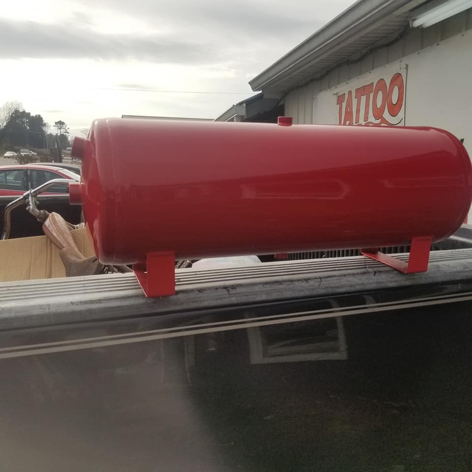

    Swap meet scores from yesterday. I picked a new set of sbf finned aluminum valve covers. A set of sbf headers (unfortunately they won’t work on the shoebox..but for $20 I couldn’t pass them up). I also got a 7 gal air tank for my future air ride set up and last but not least a vintage 20” road master bike I’m going to redo for my little man.

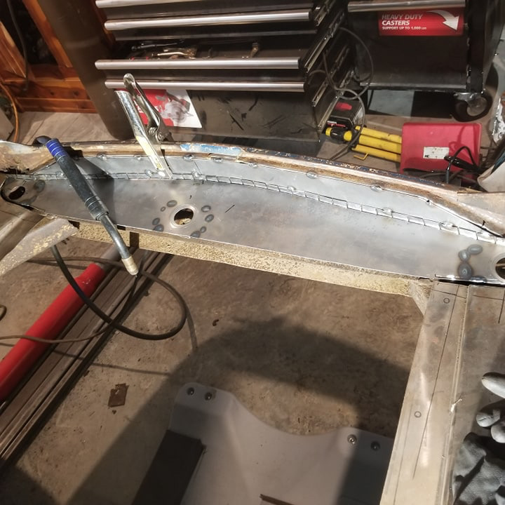

    finally got my trunk panels tacked into place. Unfortunately I ended up with some wide gaps...but luckily I have plenty of scrap pieces I can feel them in with.
    6C5EA81A-920F-4032-8327-07CFAF8CFF64.jpeg 1864FBAB-5D42-42BE-978B-1E68F0054FF7.jpeg
    I still have a lot of welding in my near future.

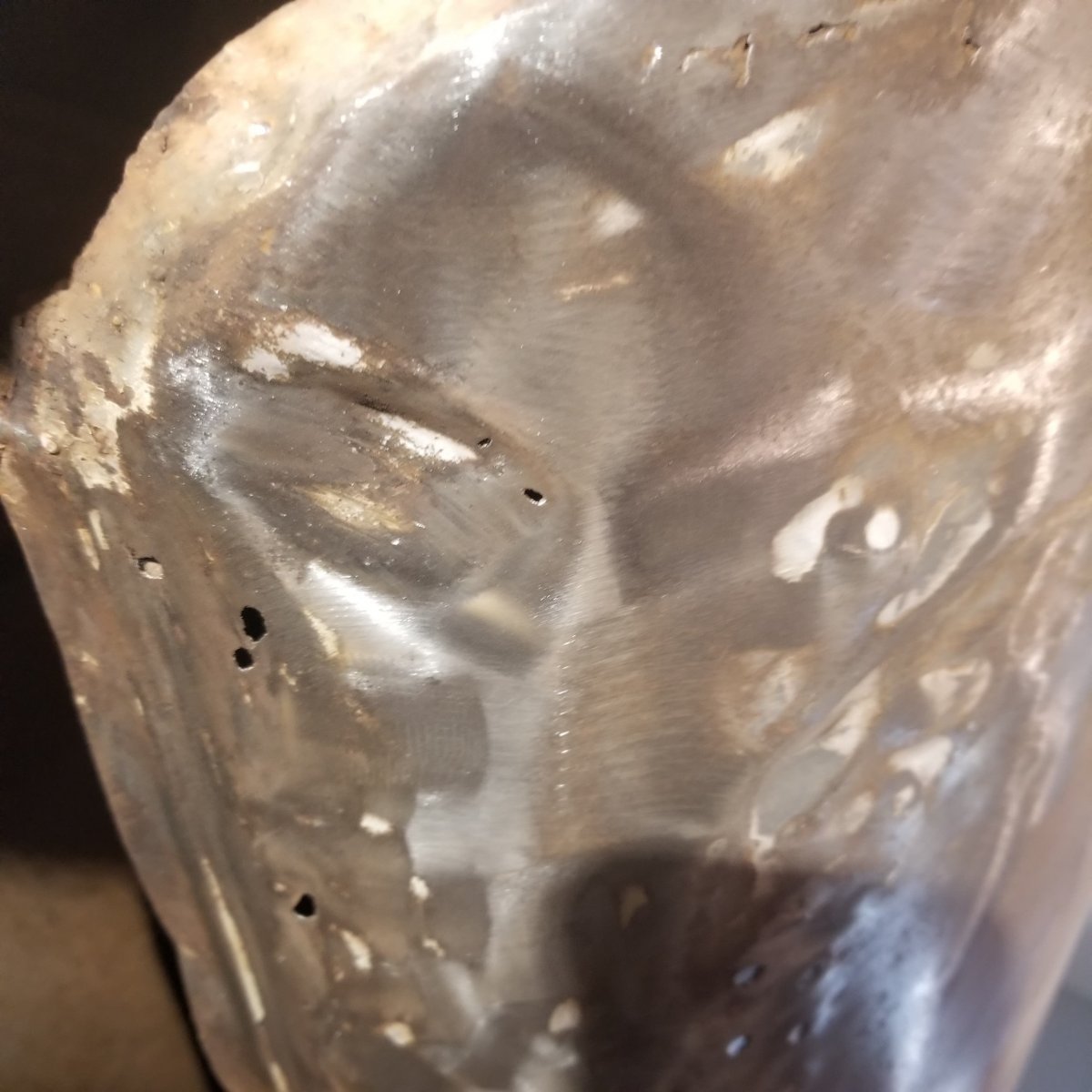

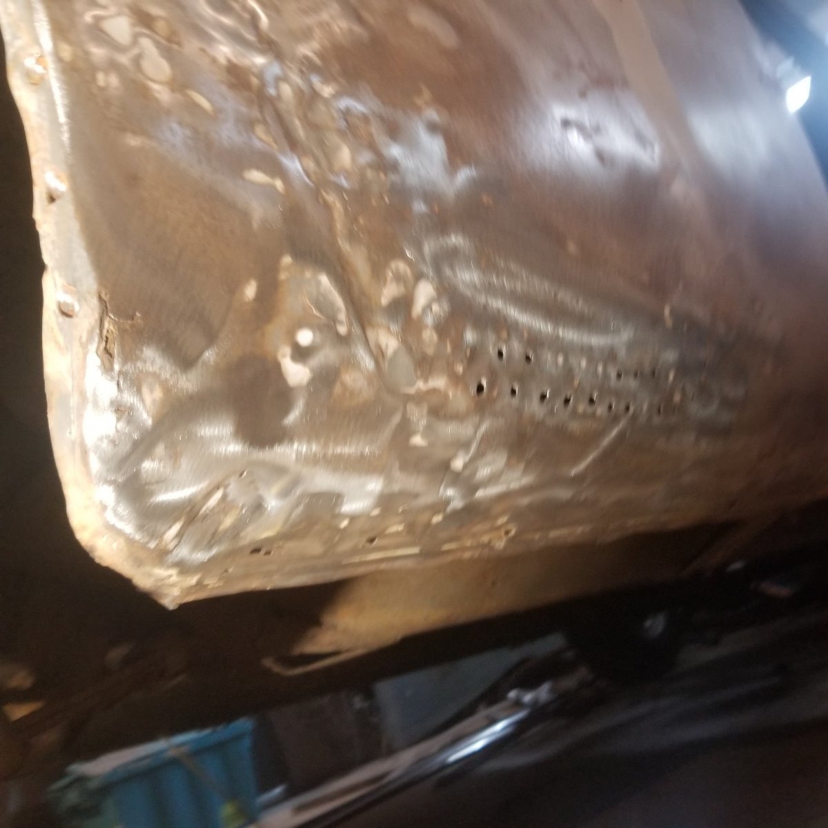

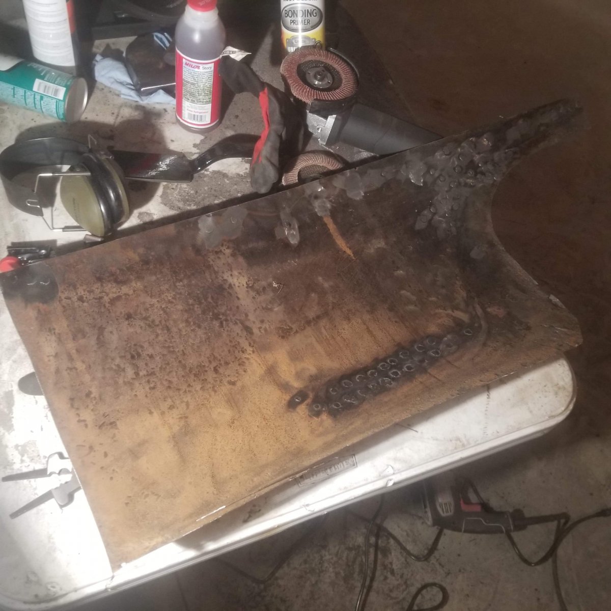

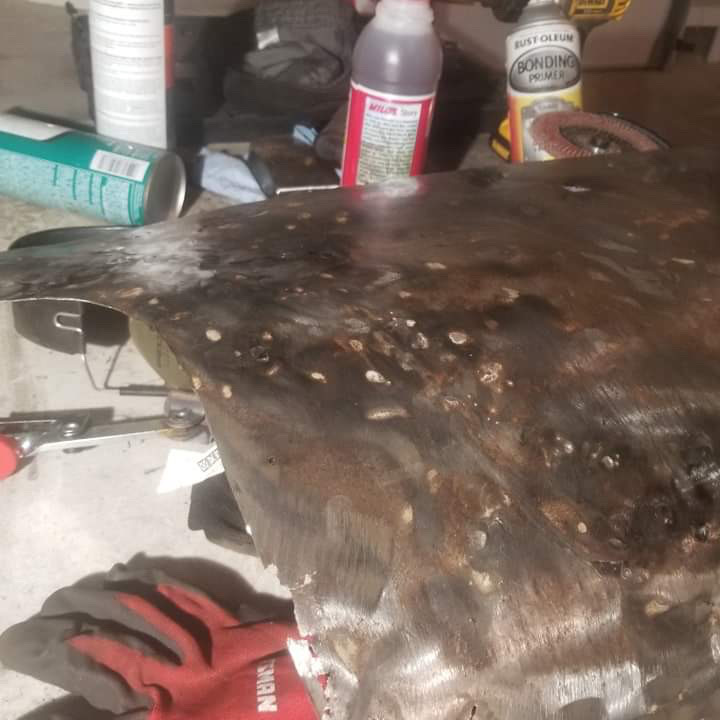

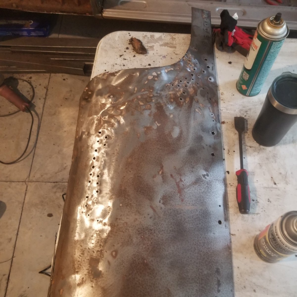

    started my quarter panel repair this morning before work. I have been welding more in the trunk pan but to a break from welding to start working on the quarter panel.
    0E7FAA6E-1363-43CF-9344-87B86D180780.jpeg 87806A39-A70D-461D-8F6D-5D54ABECFED4.jpeg 8FE08E87-773A-4D77-B100-9E357F2DB32D.jpeg 177049E6-2F60-4B2B-8FDA-3720DC9F430C.jpeg DA23CF9A-28E3-4FD0-B81E-1733B753D5B4.jpeg 2B3D5790-F99F-4988-8014-D1E098D1C6DB.jpeg
    Now that I have it cut out I will clean up the back side with a wire wheel and start smoothing out the panel with my English wheel and my slapping spoon.

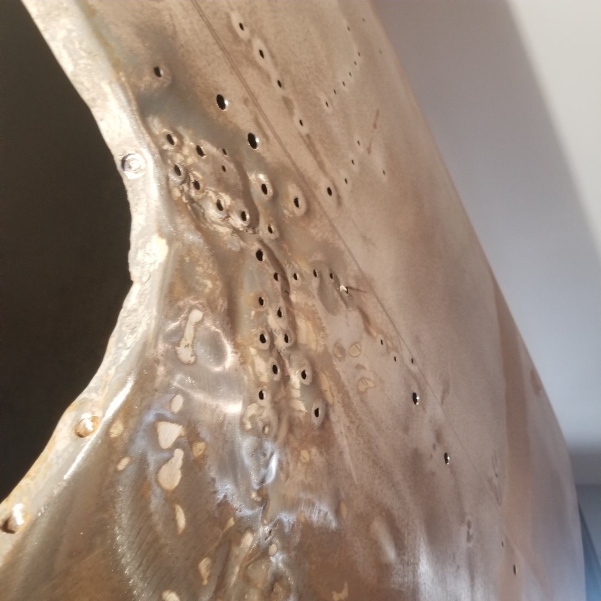

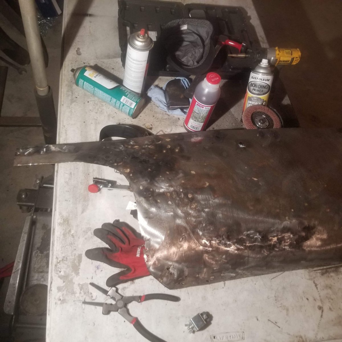

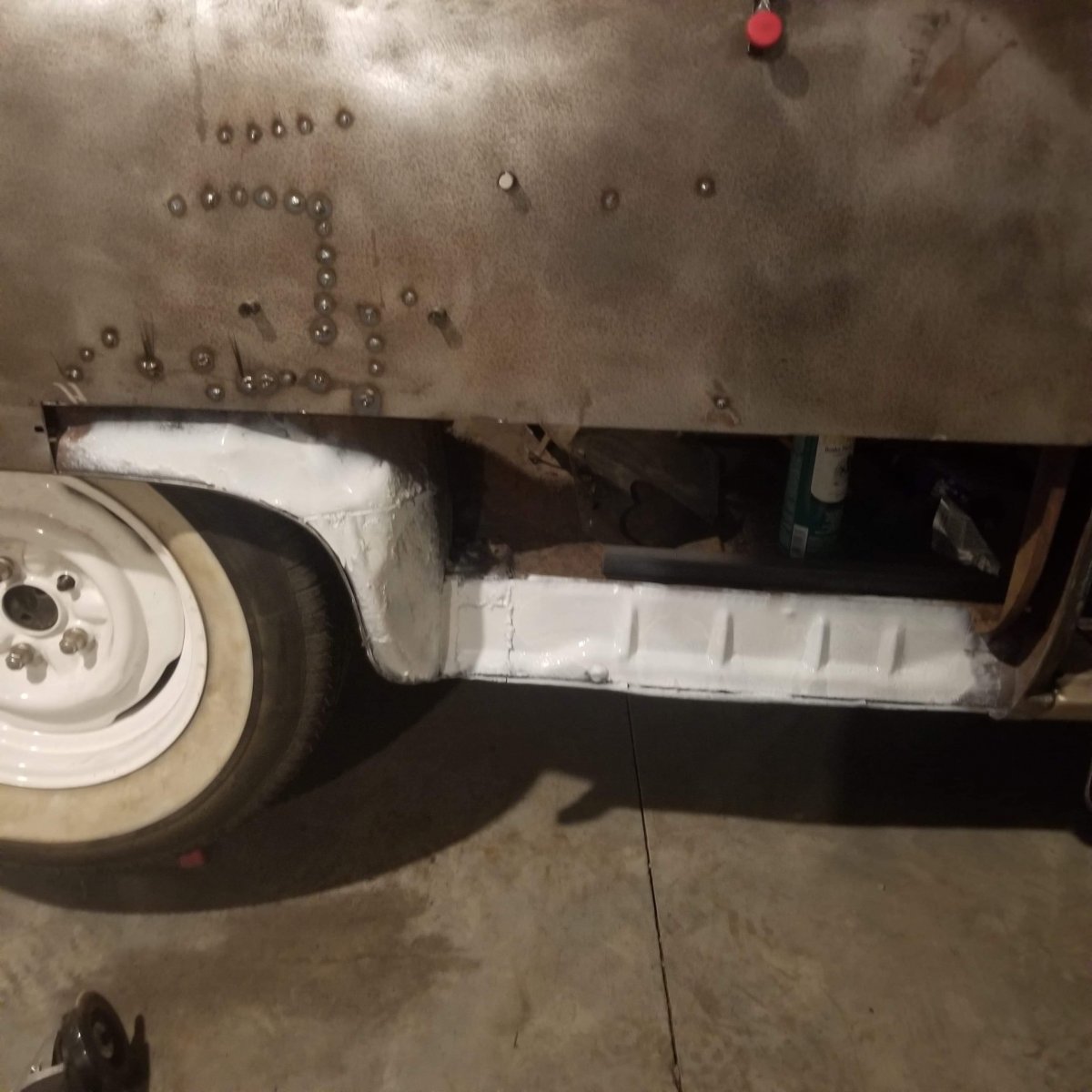

    Tonight I managed to get all the holes welded up in the quarter panel and then I ran it through the English wheel. I got most of the rough spots smoothed out...the panel is looking so much better...unfortunately the wheeling has put to much arch in the panel and slightly distorted it...now I have to figure out how to de-arch the panel and get it straightened back out close to its original shape...... 4E8402BE-F8F9-44C7-81F3-6C7CF1BECC05.jpeg
    2D7E003A-F94C-4E4D-B218-2A6D5723A458.jpeg 392075B5-78E6-45E8-A46F-BA2B4D710B0B.jpeg
    There is also a small section at the bottom of the wheel arch that I will have to replace...I will do that once I have the panel fitting the way I like.

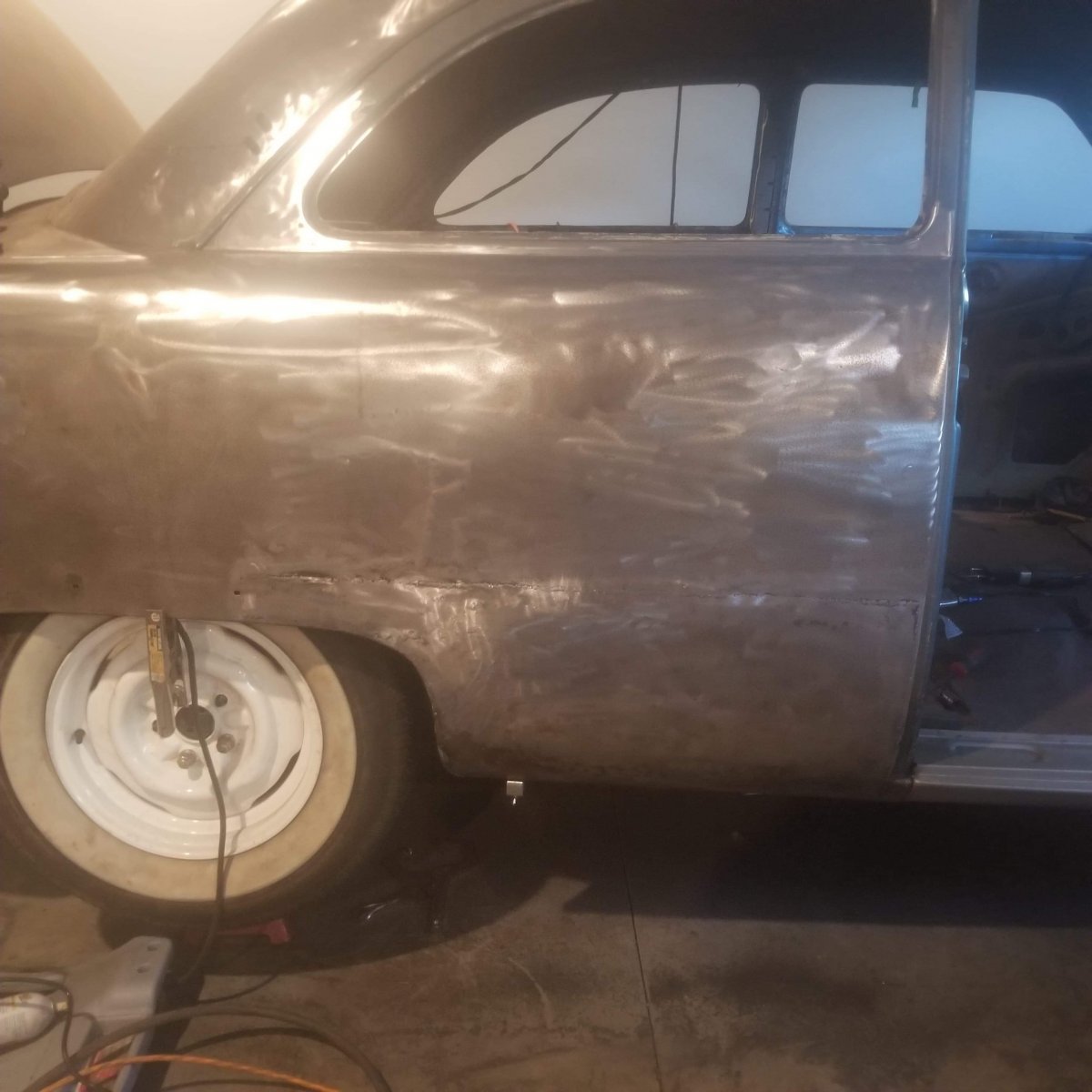

    I got the quarter panel fitting much better. And it’s a whole lot smoother now than it was before. I will have to use a lot less filler now.

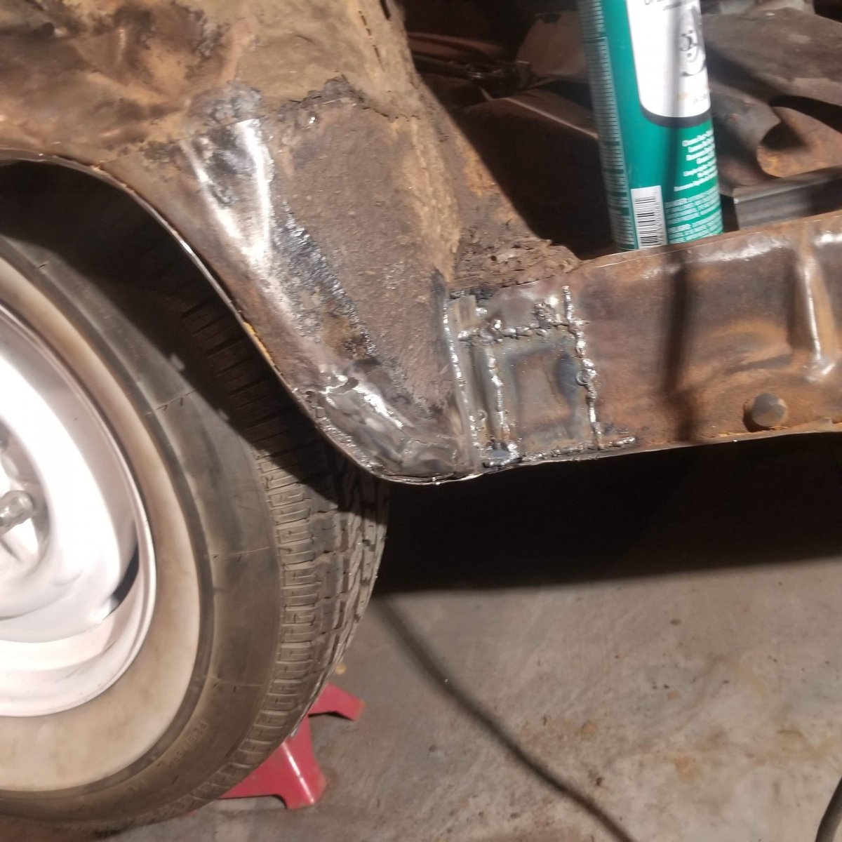

    I had to do some repairs to the wheel well and inner rocker. I know they are not the prettiest welds...but no one will ever see them after I get the quarter panel back on
    I cleaned up some of the rust and put a coat of primer on when I was finished. I also welded up the rest of the old body repair holes in the upper quarter panel.

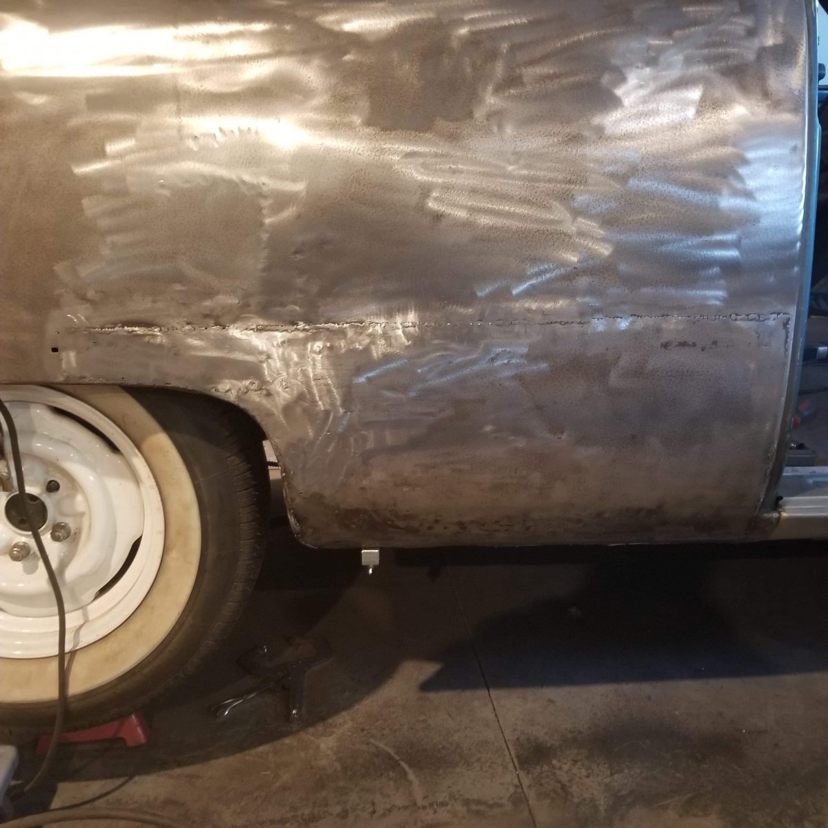

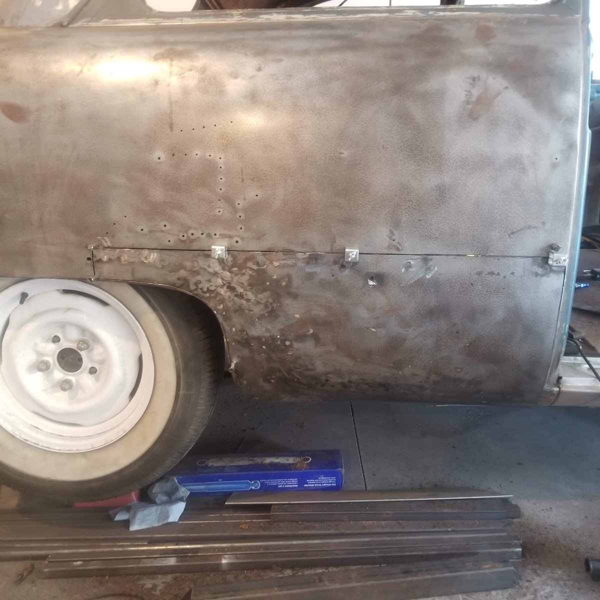

    I finally got the quarter panel welded back in ( I still have some welding on the bottom and a repair to make at the lower wheel well). For the most part I’m happy with the fit....but I had some shrinkage along the weld seam....most of it I was able to hammer and dolly it back into shape....except for a section I can’t reach because of the wheel well. Any recommendations on how I can fix the low seam in that area?
    I do have access to a stud gun I can use to pull it out some...but my main issue is I can’t get a dolly behind the seam to work it out.

  19. Finnrodder
    Joined: Oct 18, 2009
    Posts: 2,970
    Finnrodder
    from Finland
    That turned out good!
    I think the stud gun is your friend in this case. Pull so much out that is possible and see where it goes.
    The regular dolly is impossible to get there, but maybe a building one?
    Like a bastard child of slapper spoon and prybar?
    Old crappy leafsprings are a good material source for those homemade dolly/slapper tools. Its also hard to operate that alone, so extra hands could be useful. The helper pry the low spot up from inside the car, while you do some hammer work outside of the car. That kind of operation came to my mind at first...
    Keep up the good work!
  20. I think I agree with finnrodder stud gun and pull it. An old spring leaf rounded on the end will get some of it.
    Sent from my SM-A102U using Tapatalk
  21. I've taken the cut off wheel and made me a slice, pull it out and weld it back, shrinking with a wet rag as i go. But that's just me

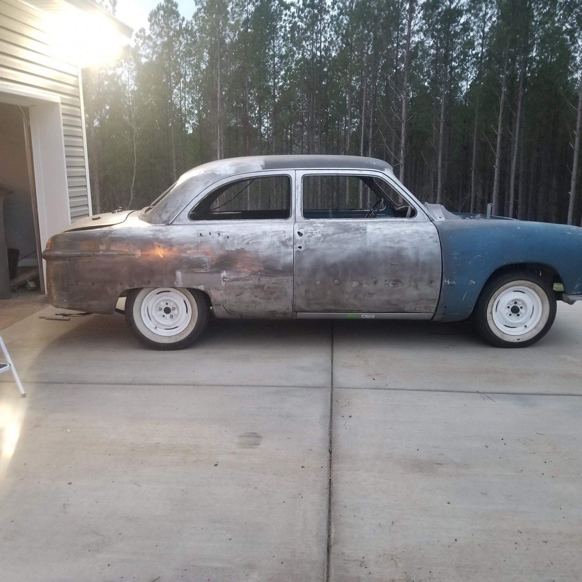

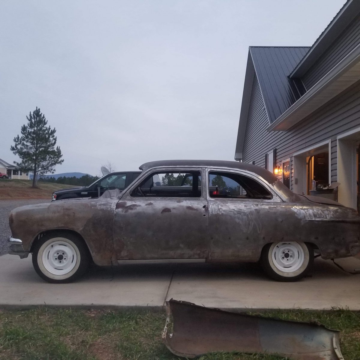

    from Delano, TN

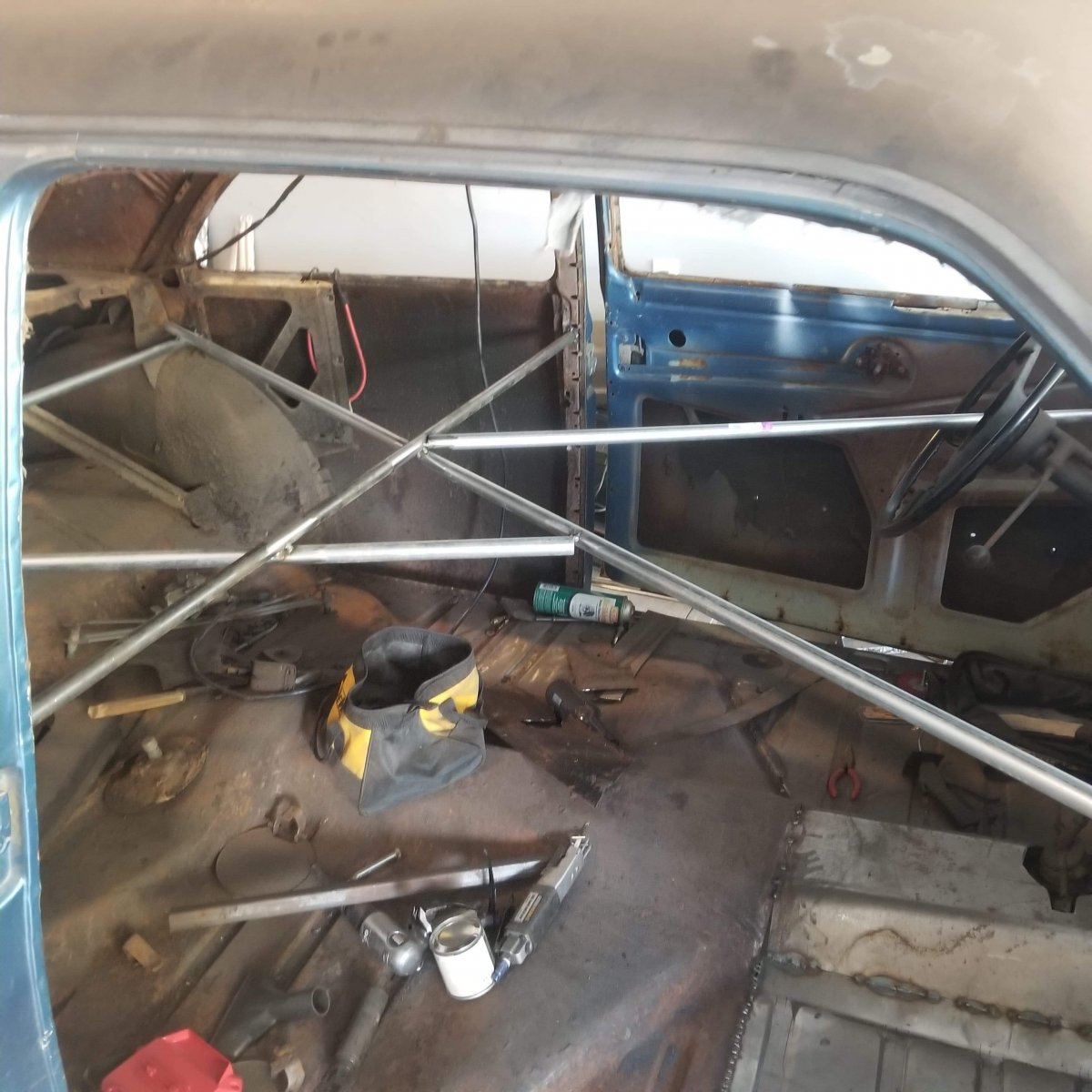

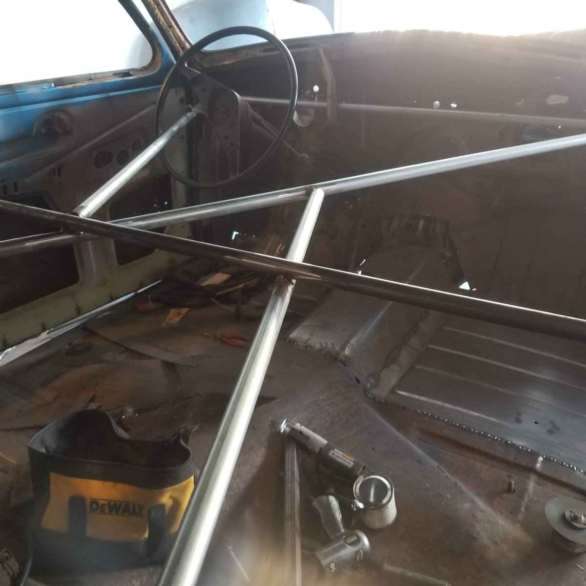

    Got the inside braced and ready for the chop.
    C9512046-AB0E-4180-8348-A722B6F7D68E.jpeg 53040C08-BA9E-469E-8864-9DC02950909A.jpeg
    Rolled the 51 out for some pictures for a good before and after. I still have a few things to get done be for I’m ready to start the chop. CBB8D5C7-815D-4494-B070-2A7D86C6002C.jpeg
    I still have to finish stripping the top of the car and clean up some of the surface rust on the sides.

  23. Nice pic.
    I was wondering if it was a sedan or a business coupe. That will be a good chop. Are you going to split the panel between the trunk and rear window and move the window forward or tilt it.

  24. Kage
    Joined: Oct 18, 2008
    Posts: 944
    Kage
    from Delano, TN
    Combination of both moving the rear window forward and tilting it.

    So, how much you are going to chop it?
  28. Kage
    Posts: 944
    Kage
    from Delano, TN
    Looking to chop 5 front 6 in the rear
  29. Brave man..... hand me a sawzall
