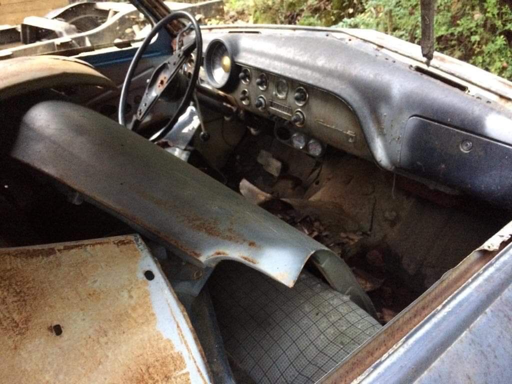

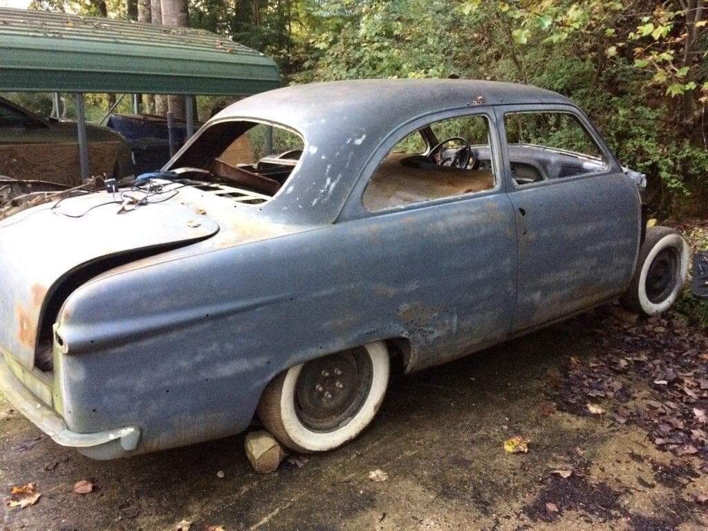

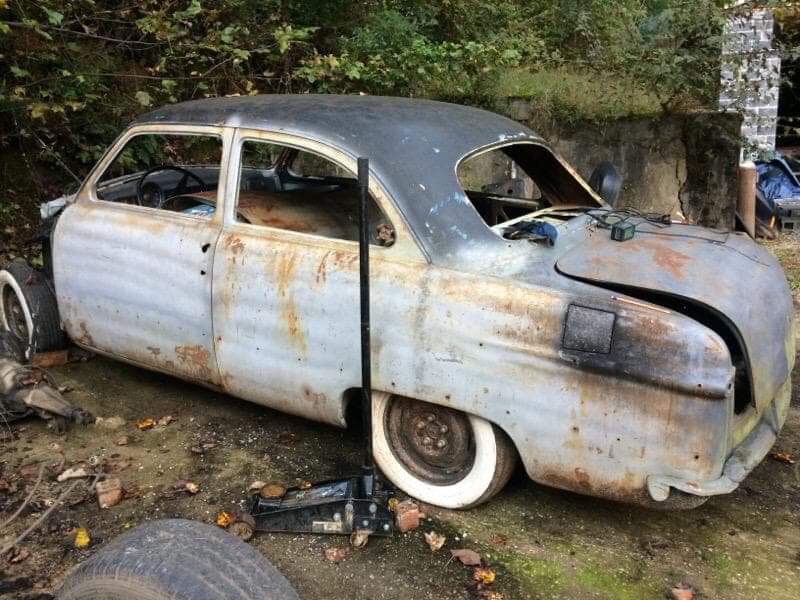

    I just picked up a 1951 Ford Custom. The car is very solid. Only has minor rust damage in the trunk. The worst parts on the car are the passenger side quarter panel in front of the wheel well. Some one drilled a lot of holes to pull out an old dent. Someone did a real hack job on the trans tunnel (which is ok with me....because I was going to be cutting it out to make room for a more modern overdrive transmission). And there was a real bad patch job done on the front floor pans. Basically a flat piece of metal was laid over the old pan and epoxied into place.
    The plans for the build are:
    Smooth out all the body panels
    Shaved doors
    Frenched headlights
    Fix the floors and trunk
    Mustang gas tank
    93 mustang 8.8 rear with 5 lug conversion 3:55 gears
    302 sbf an an E4OD trans.
    Rebel wiring harness
    Drop block in the rear
    Aerostar springs up front
    And a moderat chop. 8635B2DB-5550-4188-AB44-4A75F4A3BD4D.jpeg 31BE4E94-9EEC-49E4-969E-9D1D165C5A20.jpeg

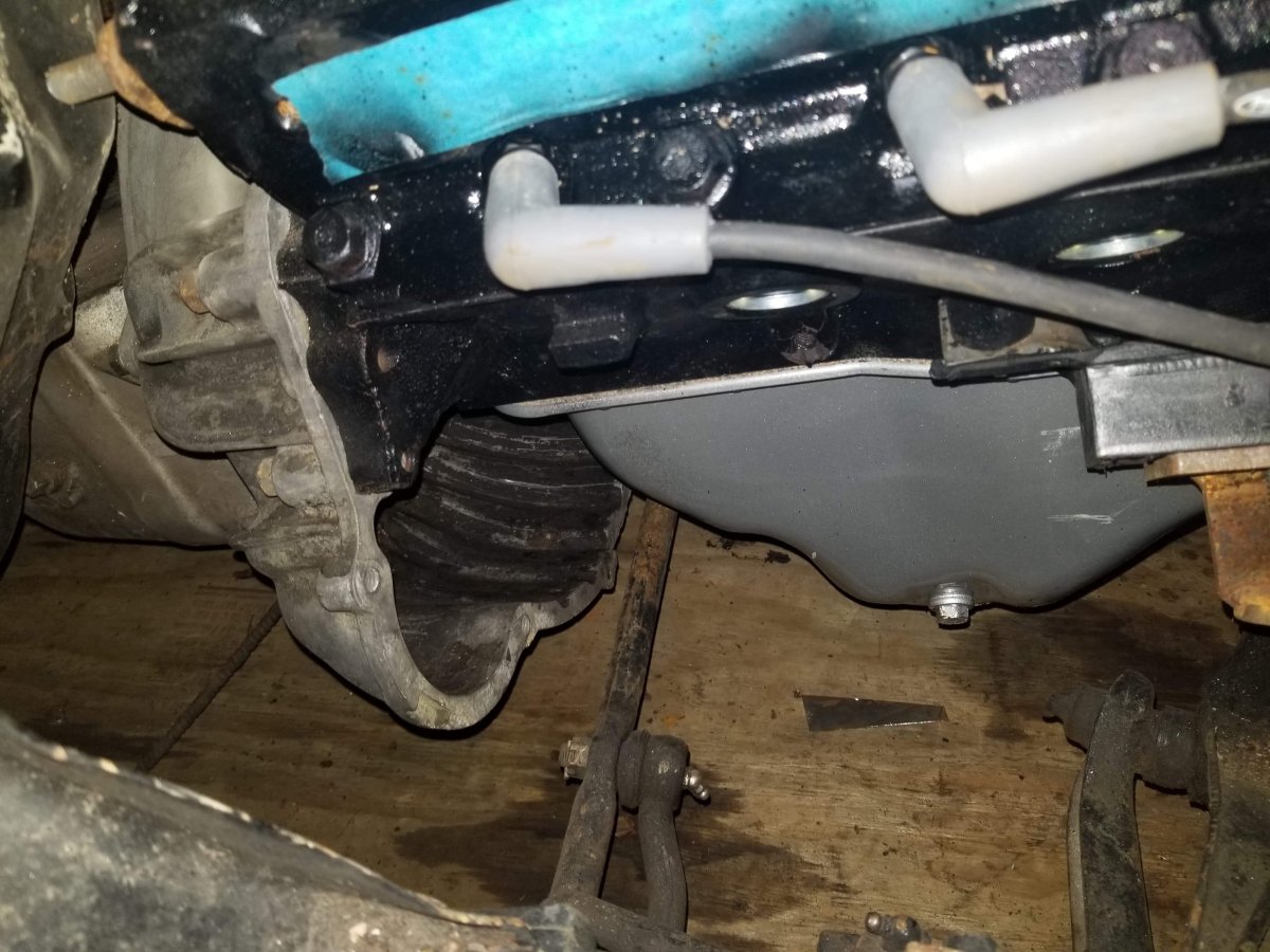

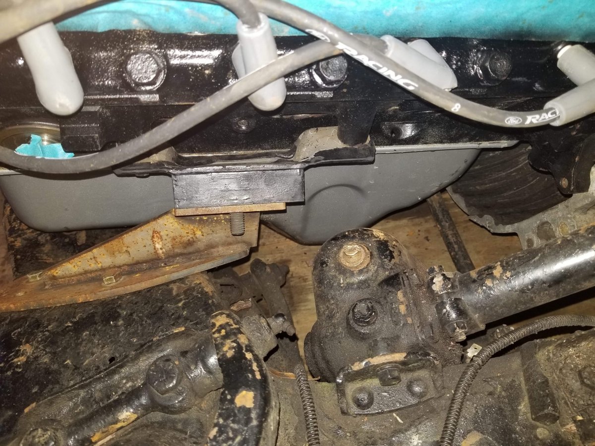

    Luckily the shoebox already came with sbf engine mounts
    2ECAFA26-DCE0-4A5F-8AAE-7A5895CA6B5A.jpeg 934EE706-0962-42C5-B423-2D8939903B74.jpeg
    Bringing her home

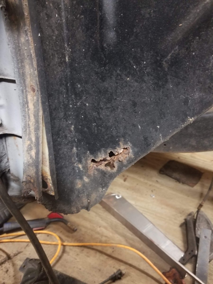

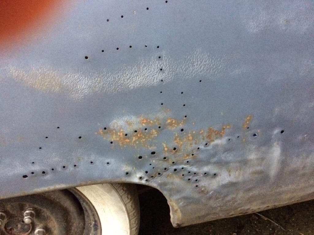

    The passenger quarter panel is the worst body panel on the car.
    DDC0A334-AAEE-4AB0-9BA7-DADAB8E63CFE.jpeg 885DC74B-636E-4C9F-A8AA-029269F932A9.jpeg 92A6E998-A859-4045-96BF-561B6B163FFE.jpeg

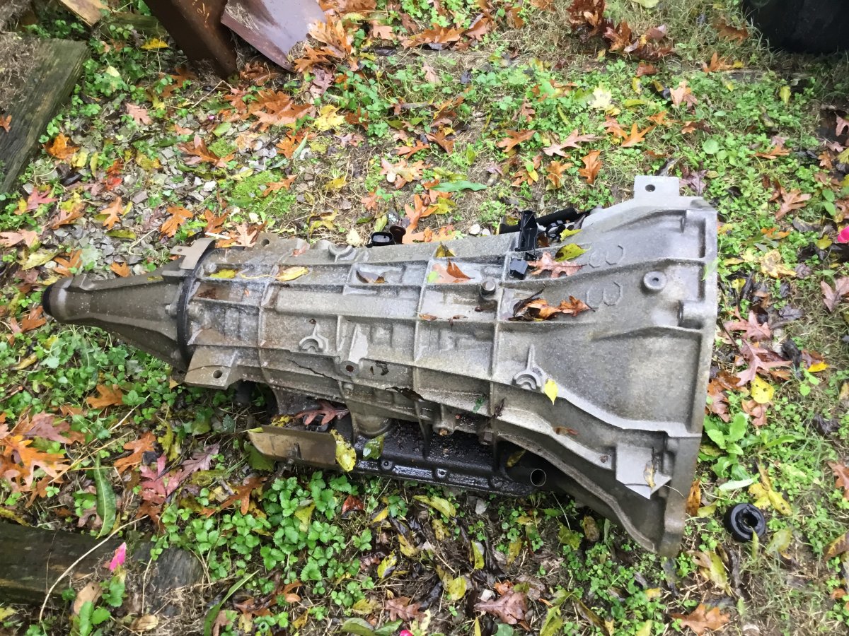

    E4OD transmission out of 96 F150 (my dads old truck)

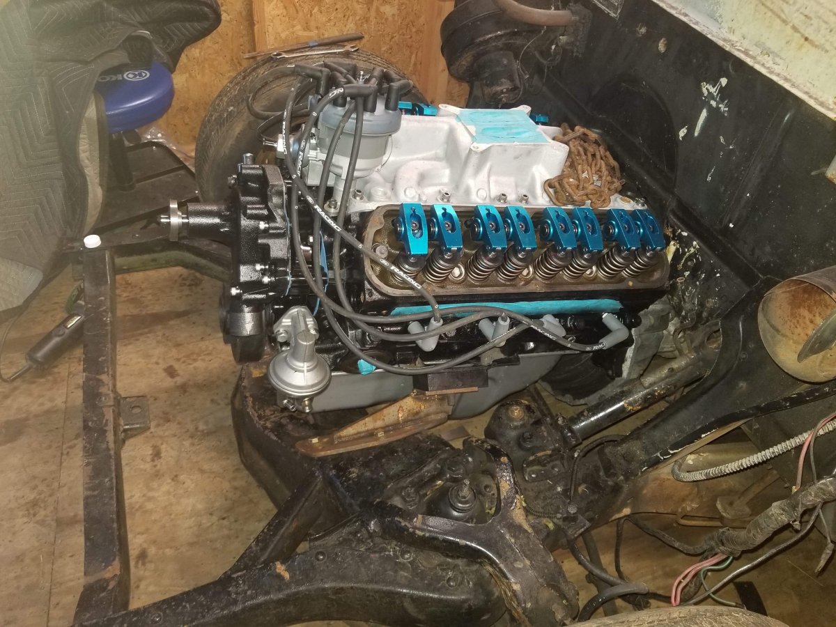

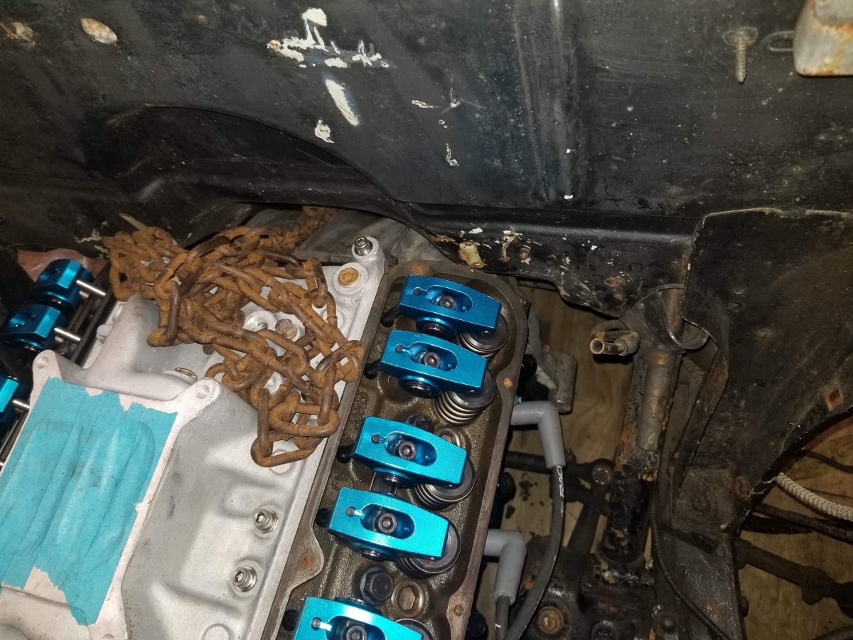

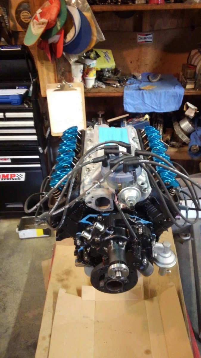

    96 302 (also out of my dads old truck)
    Stock bottom end.
    Ford Motorsport roller B cam
    Ford Motorsport 1.6 roller rockers
    GT40P heads
    Comp cam valve springs
    And a dual plane intake.

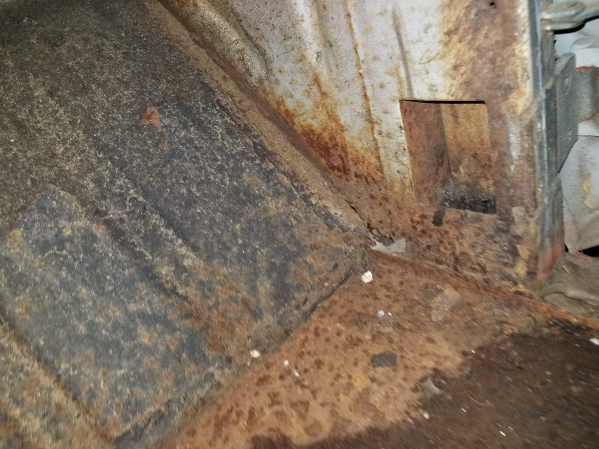

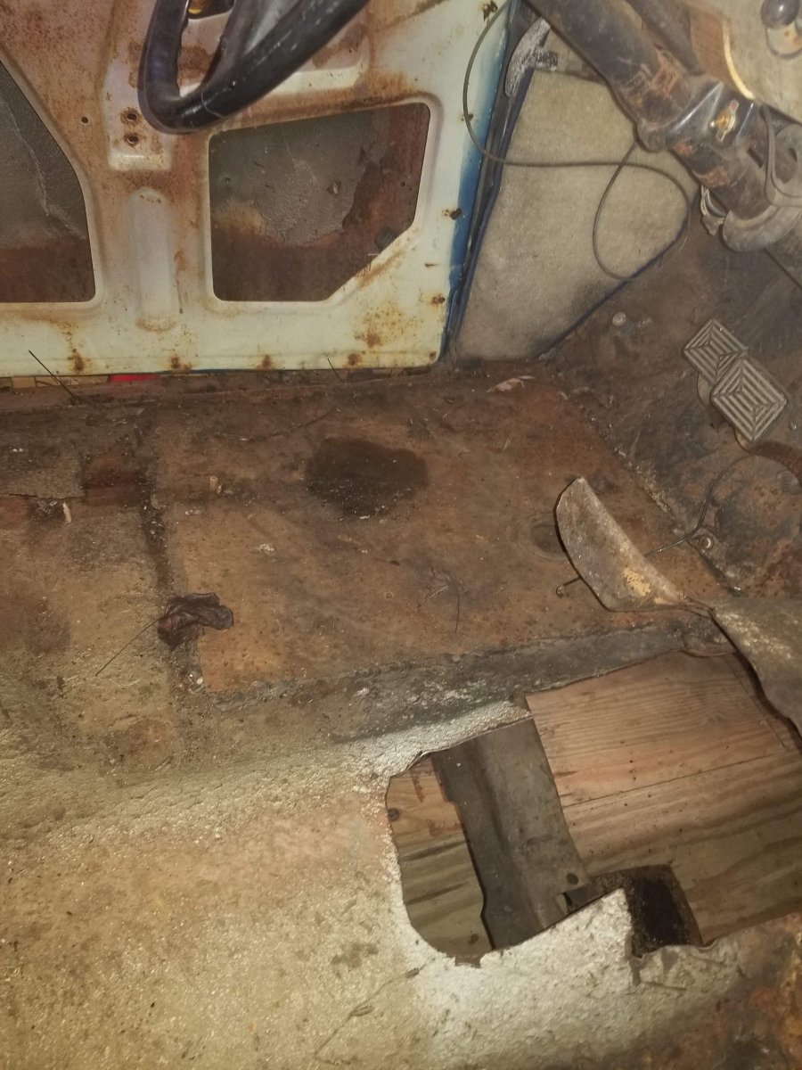

    Small rust hole in lower kick panel
    Patch from one of the previous owners

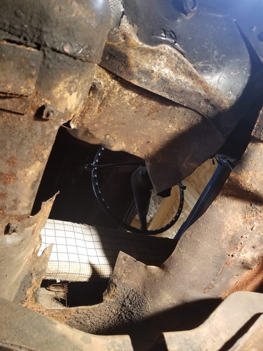

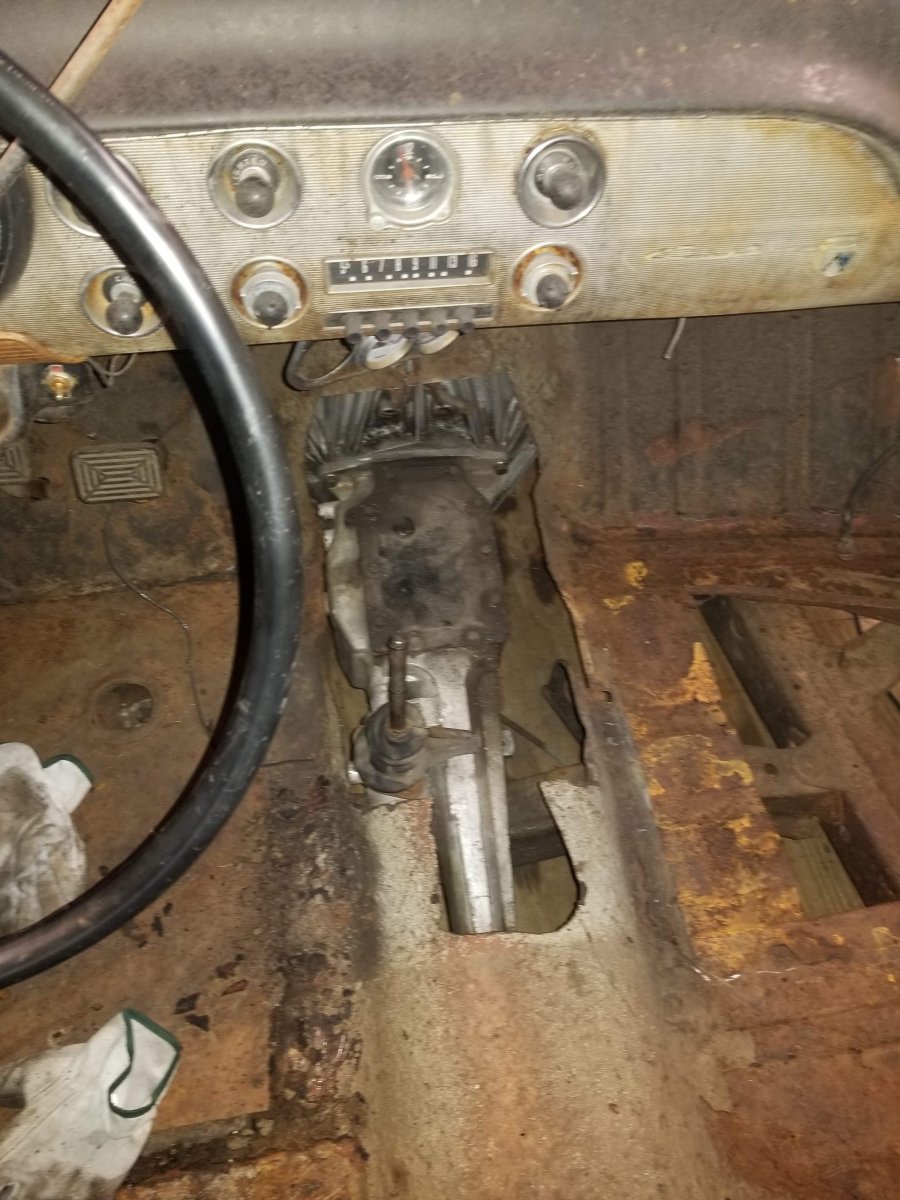

    You can also see the hacked up trans tunnel
    Passenger side...same kind of patch as the drivers side. And another shot of the trans tunnel
    135DC4F8-A1E3-457C-A9D0-D9638EC140C3.jpeg 3F852AE0-F45D-4F21-803A-BD23E6F1FD5F.jpeg

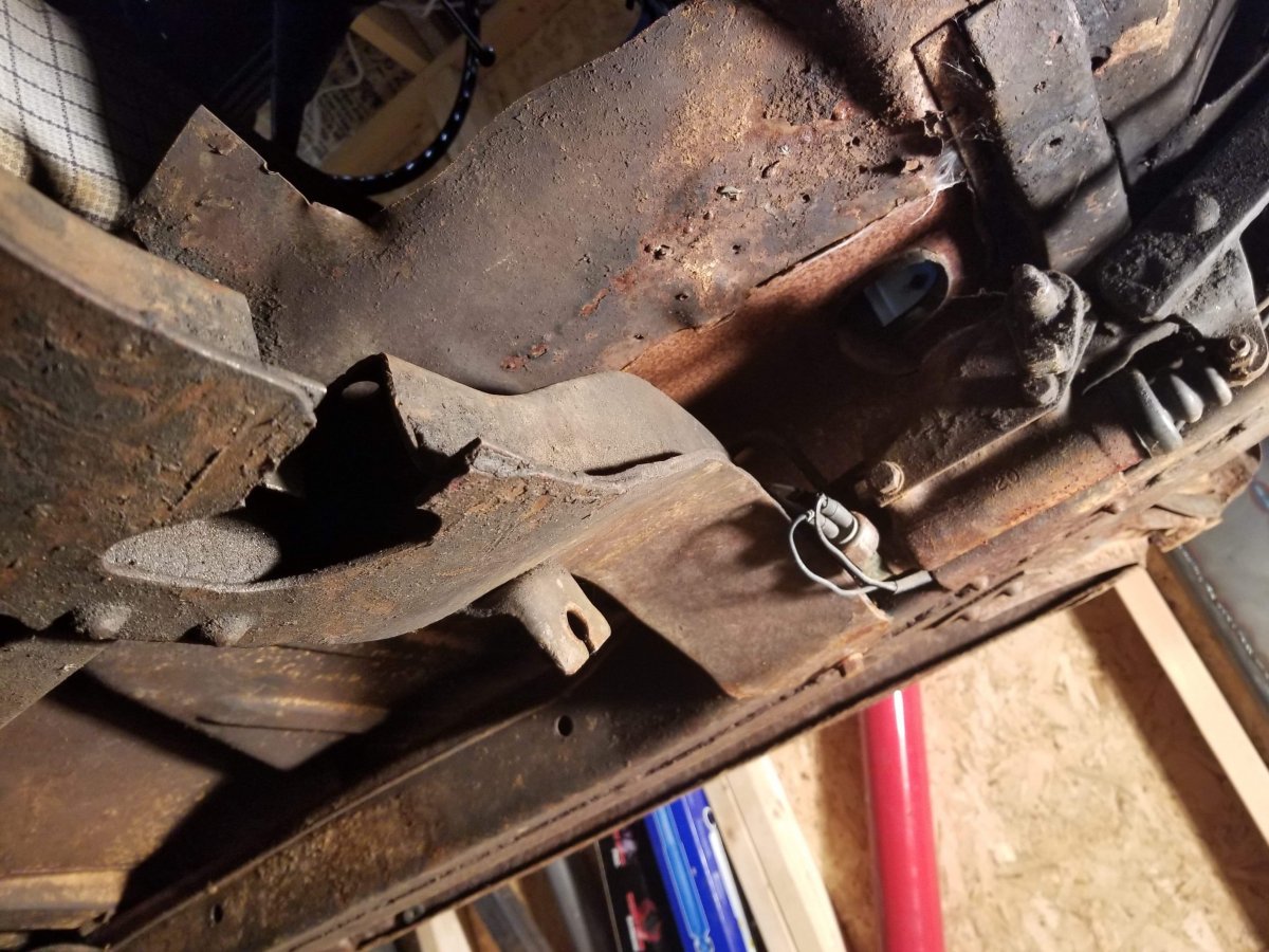

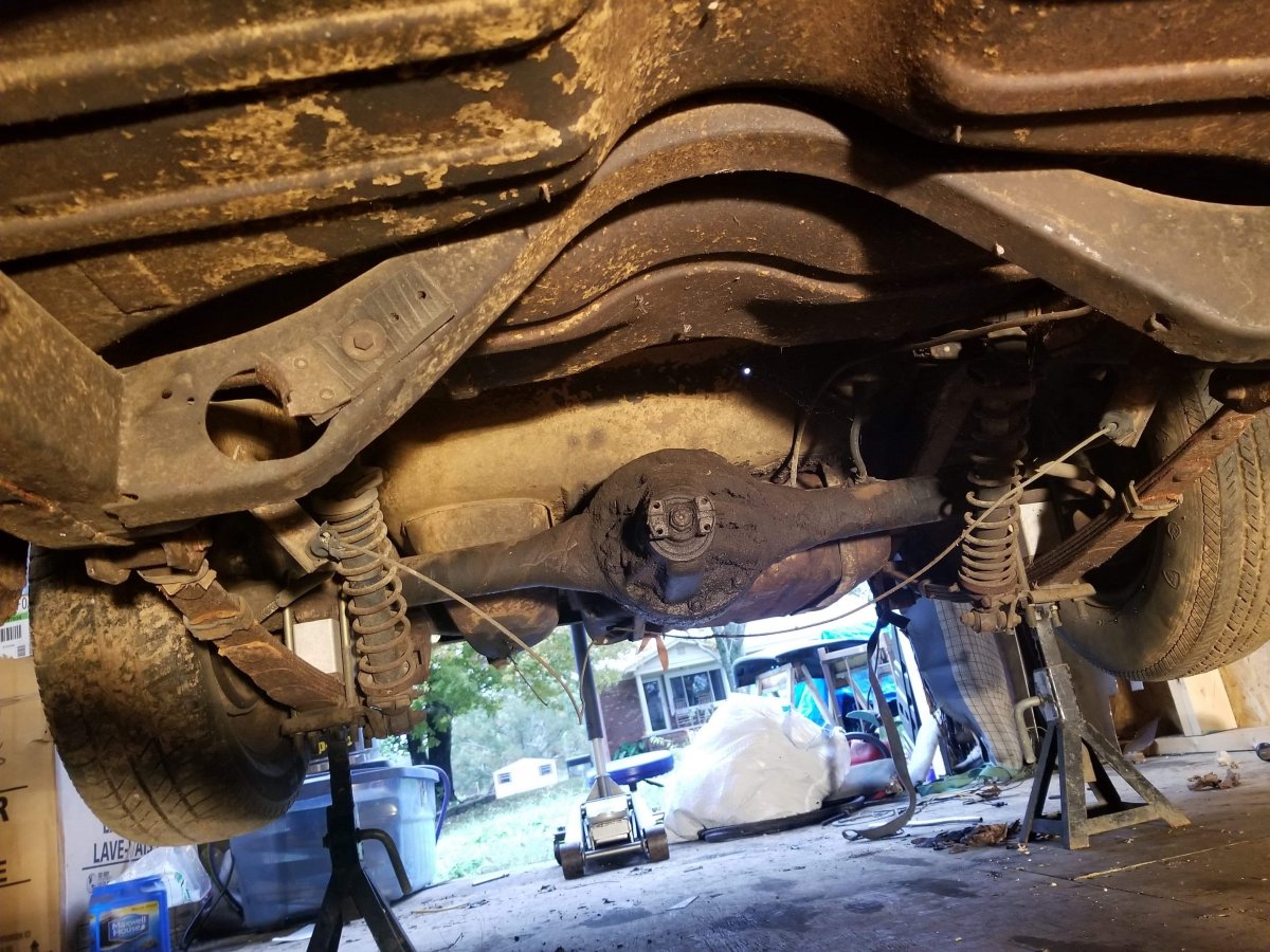

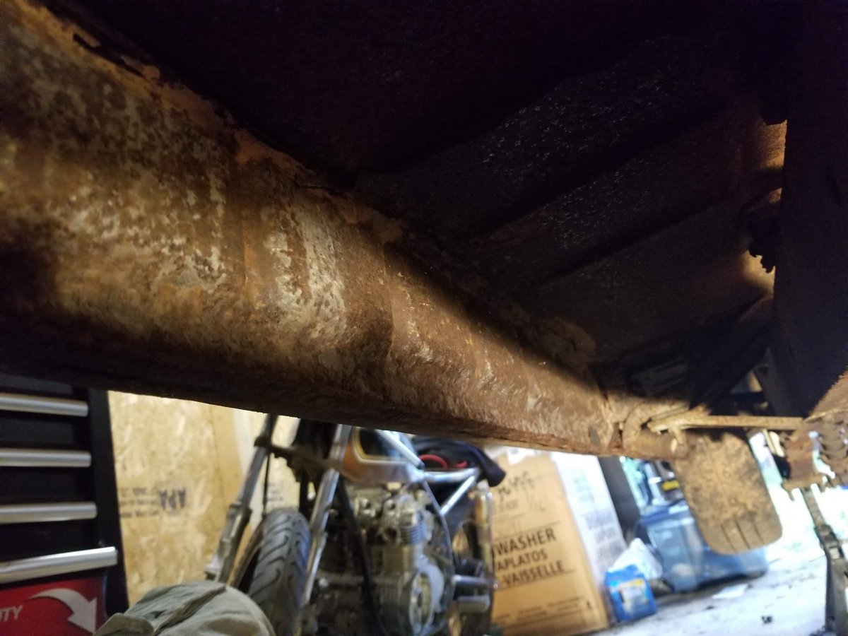

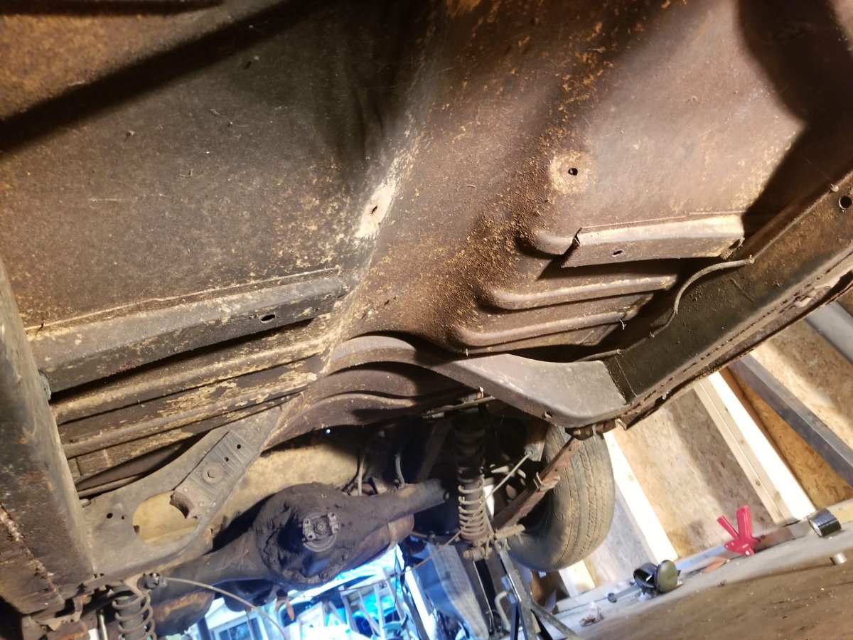

    Back side of rocker is solid
    Underneath is very solid...all body mounts are good.
    FE572ECB-15D2-47A4-B000-D51E352BA6D7.jpeg B80C1260-A4CF-46EF-BF49-470FAE735D17.jpeg

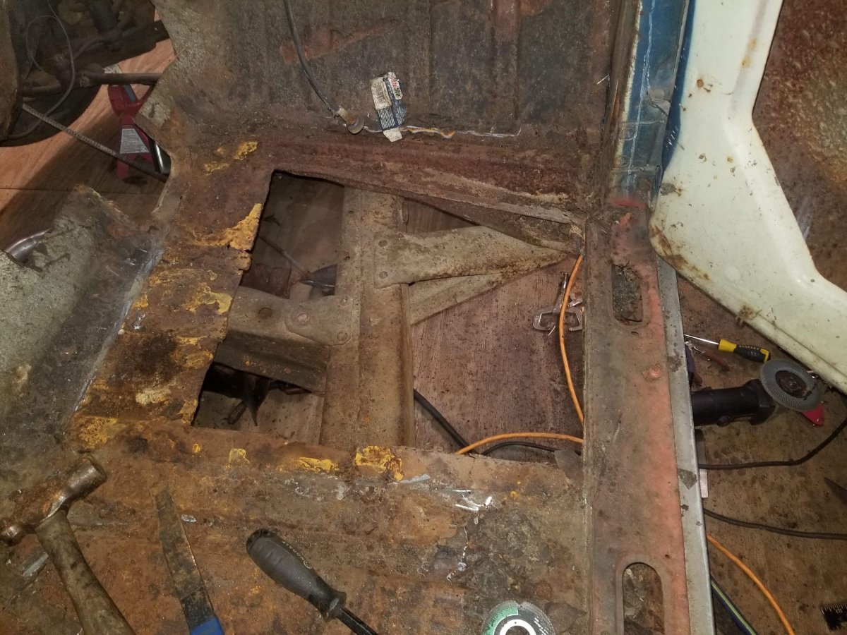

    You can see where the drivers floor was cut out and the trans crossmember has been cut as well.

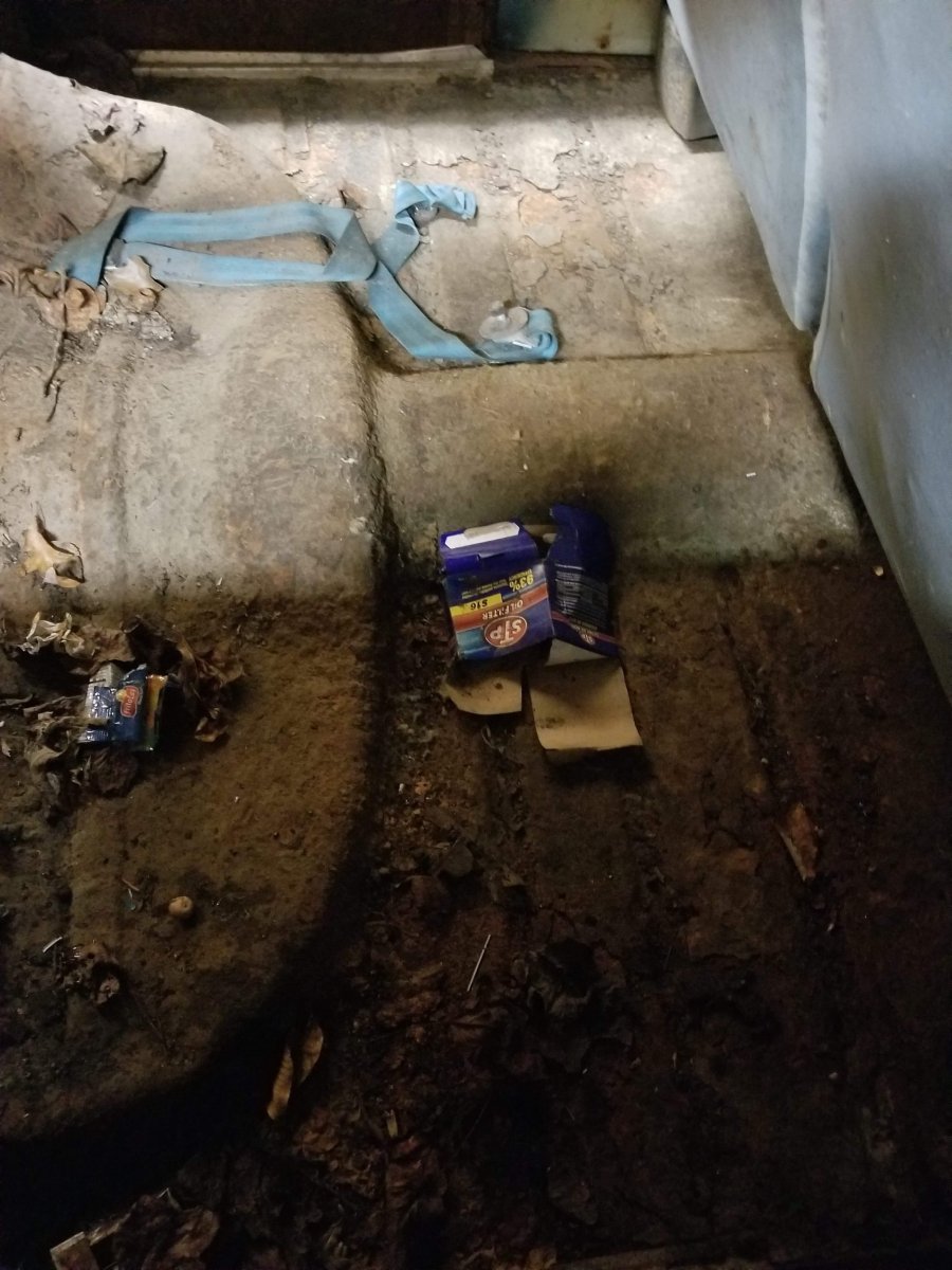

    Solid rear floors.
    Before I started cleaning the floors

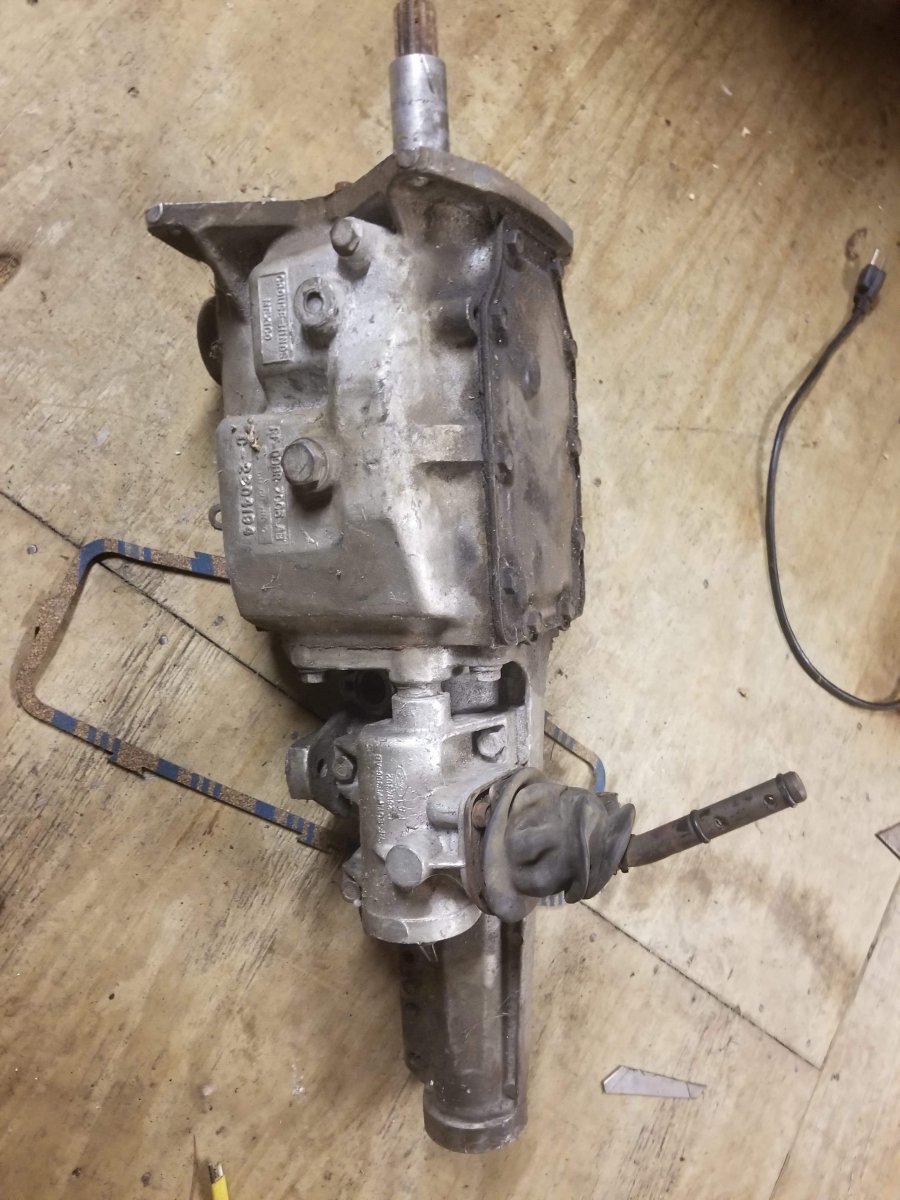

    The E4OD is very large. I’m debating about either a manual 3sp with over drive or switching to an AOD.
    I already have one of the old ford SROD transmissions out of a truck at the house. Really starting to lean in that direction.

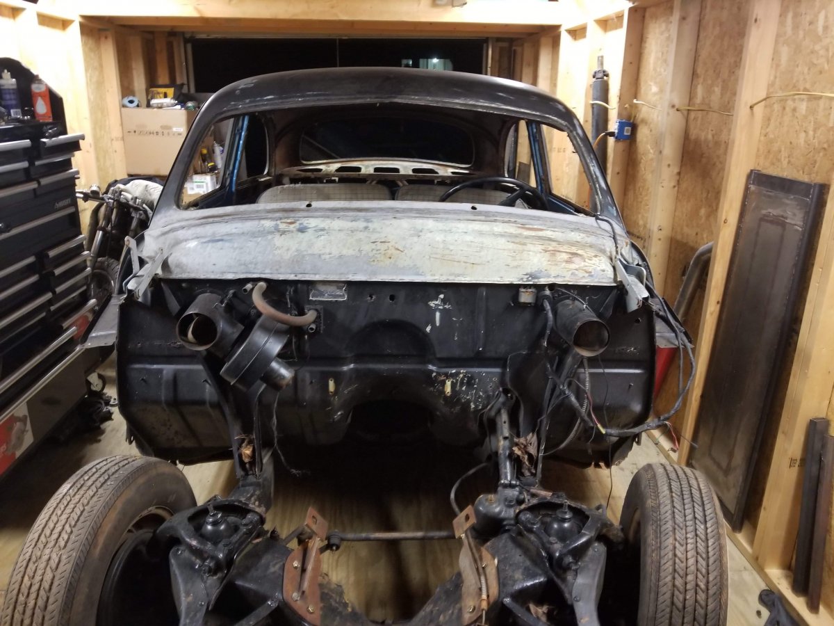

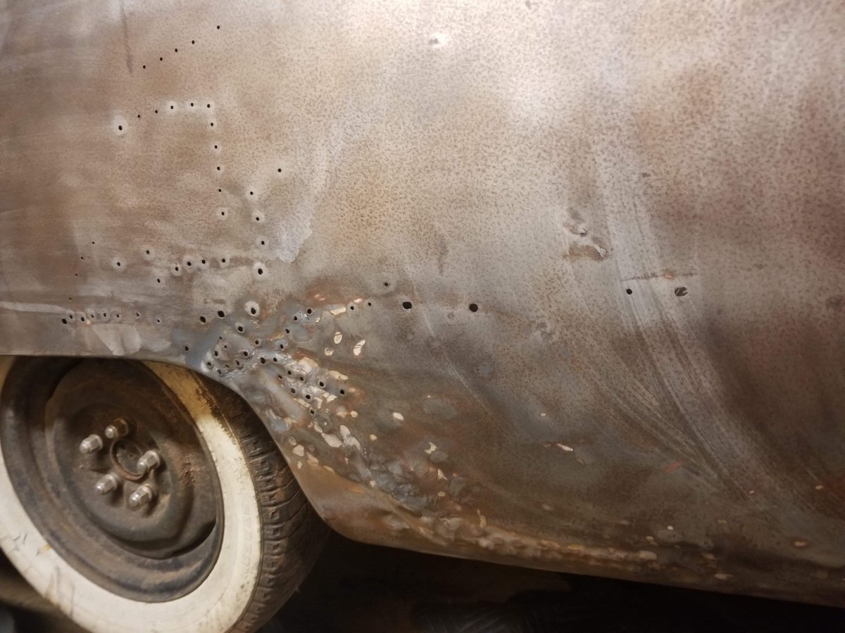

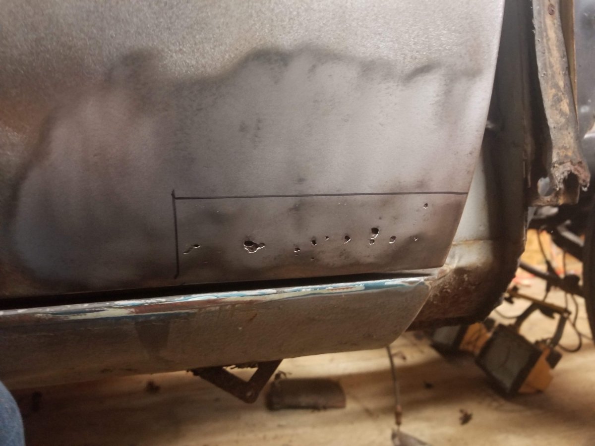

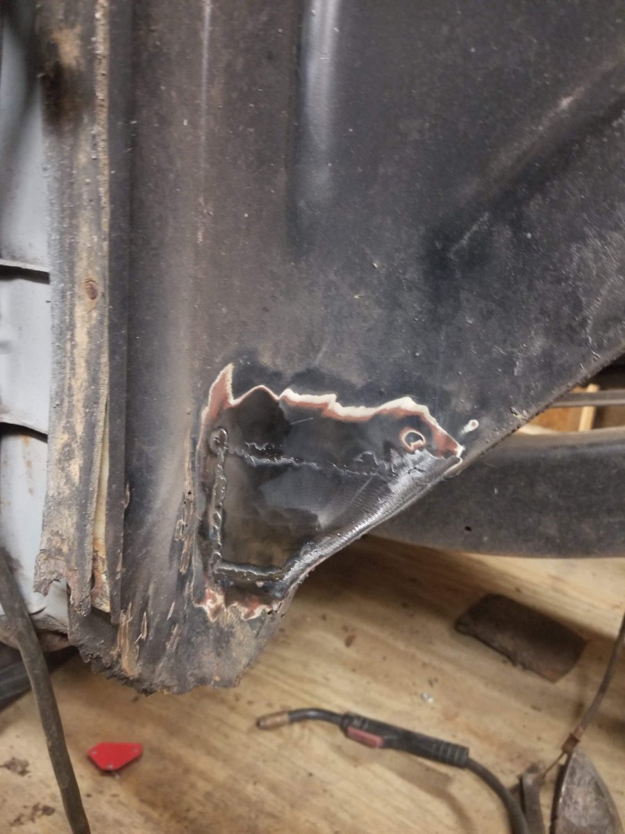

    I managed to get a couple of hours in on the 51 this evening. I got most of the passenger side stripped.
    You can really see how beat up the passenger quarter panel is.
    FB241B4A-57FE-46B7-837A-75E5EAB6C6ED.jpeg 460C1626-A558-4013-95FF-94A259B0FEB7.jpeg
    I think I have decided to run this 3 speed with overdrive SROD transmission out of an early 80’s F250. The shifter position on these is farther forward than the ones that came out of the cars. So it should be in a position forward of the bench seat.

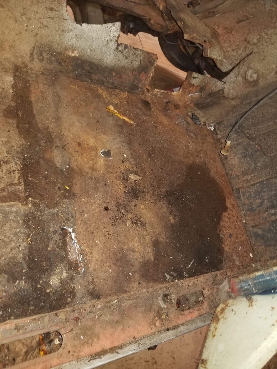

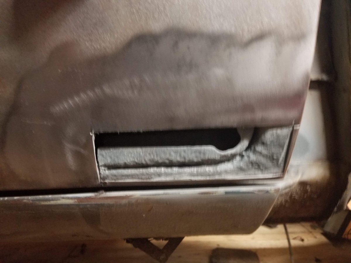

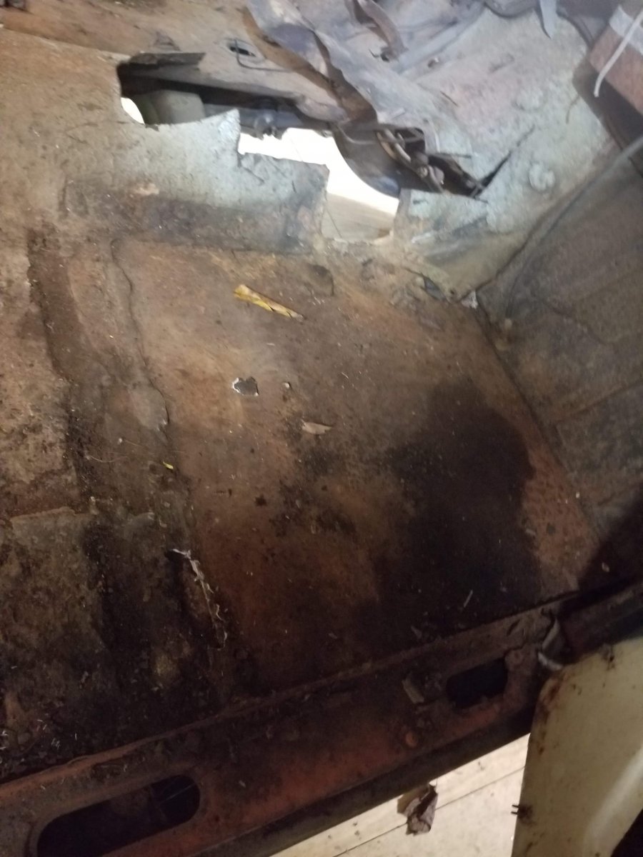

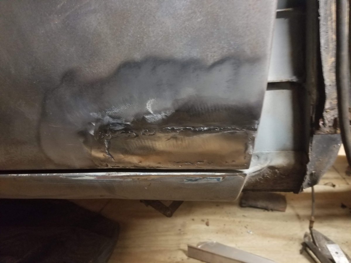

    Got a few more hours in yesterday. Managed to patch the lower passenger door and cowl area. Then I ripped up the old patch in the passenger floorboard to see how bad the damage was. Looks like a lot more cutting and welding in my future. While I wait to order a floor pan I will go ahead and patch the rocker panel.
    E63305DE-EBCB-4AD2-B06E-23B6900FBC2C.jpeg 5AB8DA61-CAF3-441C-9085-588125F029C5.jpeg A5CBB2C9-CD50-48DD-81A6-AD117211F01D.jpeg 35704C82-C3C0-4EF4-AD53-2AFD39A4D364.jpeg C4314739-7B09-4E53-9BAF-5052EF54C16A.jpeg D0BBE76F-17E4-4A77-8771-93414CFBF0DA.jpeg 21CB3D7B-BBCA-45AD-AFA6-5A65C7219F8A.jpeg
    I’m really debating about cutting off the passenger quarter panel in the damaged area and just work the original steel back into shap. It would give me a good excuse to go ahead and invest in an English wheel. Lol

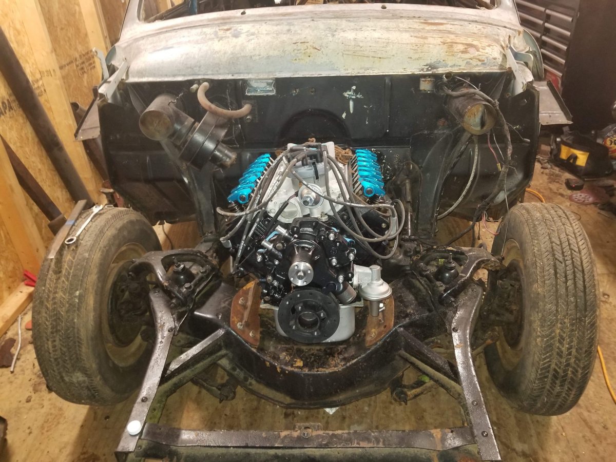

    I didn’t get much work done on the 51 over the weekend. I did managed to go pick up my freshly rebuilt 302. And dropped off a 292 Y-block to be rebuilt for my 54 F100. I also scored a bell housing. I drove over an hour away to go get it but for $60 bucks it was worth the drive. With the bellhousing in hand I was able to get the engine and trans mocked up in the 51. I’m pretty sure the engine frame mounts I have are the Jamco Suspension mounts. I’m using a 96 F150 oil pan. I seem to have good clearance all around. I still need to fab the mount for the trans and get it centered.

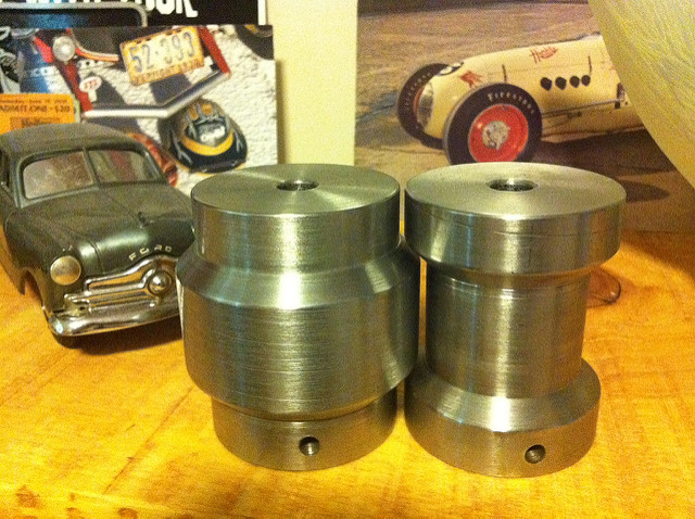

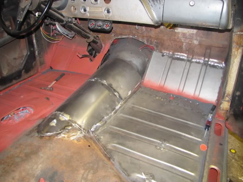

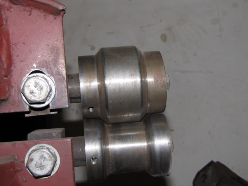

    My cousin owns a machine shop and is going to make me a set of dies for a bead roller like the one pictured below that finnrodder made for his shoebox. Once I have them I will start making my patch panels for the floor and then I can fab up a trans tunnel. I really wish th PO hadn’t butchered the trans tunnel.
    60D45A18-B887-43B3-A30C-D1539994C032.jpeg E299CEF6-5B1E-43B7-B265-CEBA8D723FD1.jpeg
    The below picture is from finnrodders build. Just showing what floors made with the custom made dies shown above can look like. 1AC1B273-9FC3-4743-A42C-C5E276F4BFBB.jpeg 24AFD3DC-CAED-4FEF-B064-98D9333C616D.jpeg 4DB59767-DD12-4E34-B60F-48DF93945DED.jpeg

    The fox body mustang rear end is 59 11/44......so I guess I’ll be on the lookout for another rear...I guess I miss read the measurement when I 1st looked it up. If I can’t find an 8” from Maverick or Granada I’ll go with a ranger rear end

    The floor and tunnel above is not the one in my car...that is from finnrodders build...was using it to show as an example of what those custom bead roller dies can do

  29. I'd go with the AOD and 3.55 gears, or get a C4 for the 3.08 gears. The E4OD is the electronic version of the C6 so a) it's going to suck more horsepower, b) it's HUGE (as you've noted), and c) it's electronic, so you'll have to get a computer (if you don't already have one). The C4 or AOD will be a better choice over the AOD, just depends on what you want to do on the rearend.

    Critchdizzle has an excellent point on the E4OD, the computer and the wiring that is required is a pain; not to mention the huge size difference. The AOD goes in without any cutting at all; all I had to do was modify the trans. cross-member a bit.
