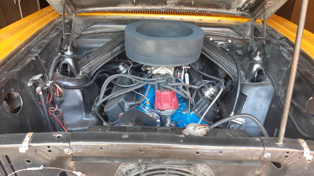

    This is the seal for the hood to the carb.

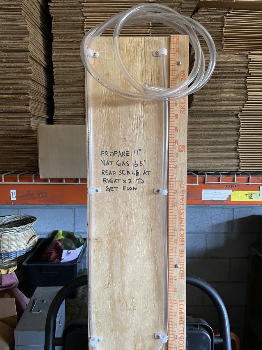

    I made this a while back, used it to measure the gas flow for my propane powered generator. It measures “Inches of Water” and you have to double the reading on the right side to get your correct pressure measurement. AD2FC425-4E8F-414A-B6D4-BA1AF2D4EACC.jpeg
    Filled the hose with water and a few drops of red food coloring. Worked pretty good, found my problem. You can make it smaller, I just used what I had around. Never thought of using it to test my hood scoop on my Bonneville race car, going to try that for sure!

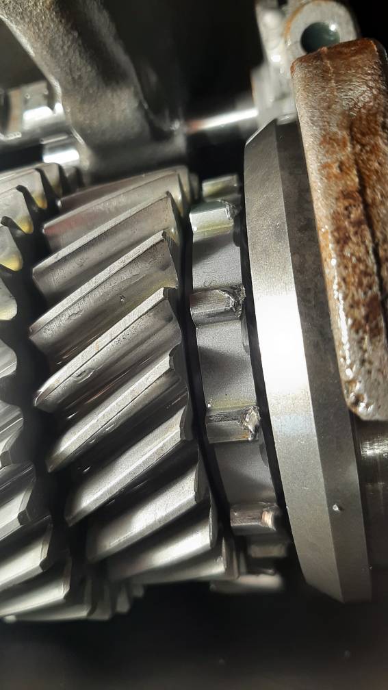

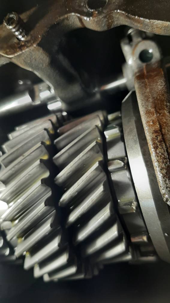

    This is what the lugs look like in my top loader. A little bit of filing and grinding after I take it apart and it will shift like new again for quite a while.
