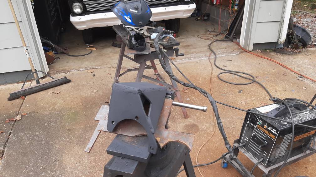

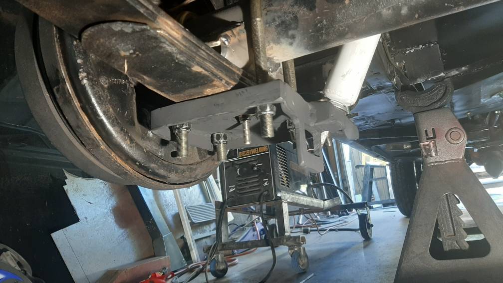

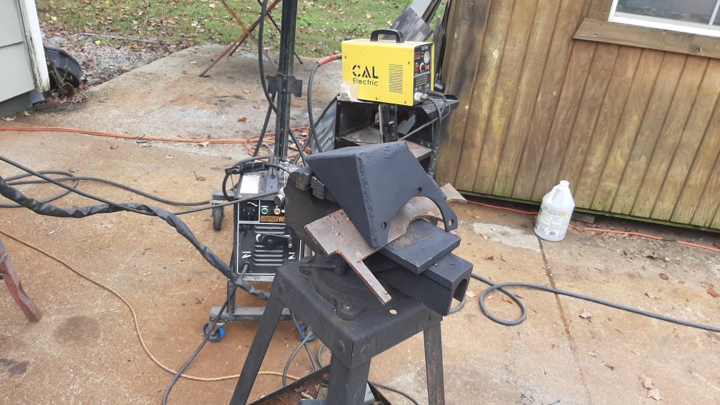

  8. KoolKat-57
    Joined: Feb 22, 2010
    Posts: 3,038
    KoolKat-57
    from Dublin, OH
    Isn't that kinda like what the Mopar guys do for a pinion snubber?
    Looks good to me, let us know how it works.
    KK

  9. BamaMav
    Joined: Jun 19, 2011
    Posts: 5,203
    BamaMav
    from Berry, AL
    You may have one and it doesn’t show in the pic, but I’d run a brace from the top of the snubber bracket back to a couple of the bolts that hold the chunk in. It looks like from the pic that when it rolls upward in front that it could possibly bend the snubber bracket down toward the front.
    If you have it braced that way, ignore my post.....
  10. bchctybob
    Joined: Sep 18, 2011
    Posts: 3,352
    bchctybob
    I would put a support of some kind from the third member bolts or top of the housing to the upper portion of the gussets on each side. A strap or preferably a tube on each side. Maybe straight down to a bracket bolted onto the bottom two pinion carrier bolts? At the hit the three 3/8" pinion carrier bolts are trying to support the weight of the back half of the car and shock loads as well. As violent as things get under there it couldn't hurt to spread the load.

  11. bchctybob
    Posts: 3,352
    bchctybob
    Funny, Bamamav and I were seeing the same thing. The Mopars actually bolt to a four bolt pad on top of the third member casting if I remember correctly. As opposed to the cantilevered method.

  12. greybeard360
    Joined: Feb 28, 2008
    Posts: 1,847
    greybeard360
    I still don't think that is a good way to go. Pinions on a 9" are prone to spitting themselves out the front of the housing on their own let alone putting a lot more force on it along with my previous mention about the wrong type of setup with the springs you have. I would scrap the snubber and put something else on it that is legal.
  13. RmK57
    Joined: Dec 31, 2008
    Posts: 2,005
    RmK57
    It would work better if it was the opposite way around. Place the piece bolted to the pinion support on top and the snubber on the bottom. Much less leverage on the Daytona support. Some of the later 60's Mustangs' and Torino's had them and they worked fine.
  14. 6sally6
    Joined: Feb 16, 2014
    Posts: 1,799
    6sally6
    This^^^^^^^^^ would prolly be THE ANSWER to traction and breaking crap. Build a set of these and loosen the U-bolts so the axle can rotate (or a full floating axle set-up) Should plant those rears pretty good.
    Worked pretty good back-in-the-day(60's)

  16. southcross2631
    Joined: Jan 20, 2013
    Posts: 4,414
    southcross2631
    The front half of thee springs are about solid with a piece of 1/4 inch steel clamped to the spring.
    Good idea adding a strap back to the housing to help support the aftermarket carrier and pinion support that are in the car. I have until next Friday to get those built.
    It is always a good thing to have another set of eyes on a project.
    As I said earlier I have a set of Crites bars ,but I am trying to avoid the 100 lb. weight penalty that comes along with them. I could just bolt on a set of slapper bars a lot easier and it has the same weight penalty .
    I am already adding almost 200 lbs in added weight just to make the weight that is required for my cubic inch motor.
    There are only 2 races left in the season so I will add the straps to the snubber and see if it works.

  20. southcross2631
    Posts: 4,414
    southcross2631
    When I built the spring pack I moved all of the leafs forward to the spring eye. Then I drilled a new centering hole and bolted the pack back together . The rear of the pack has 2 leafs that are not clamped together so they can spread .
    The front is short and stiff and clamped. The pinion snubber is set at about 1/2 inch at rest the full weight on the springs. I built a strap out of 1/4 inch plate bolted to the housing bolts and welded to the pinion snubber. There is a slight preload on the strap when I tighten up the carrier bolts. Maybe a 1/16th of an inch.
    I will try and get a picture of it today.

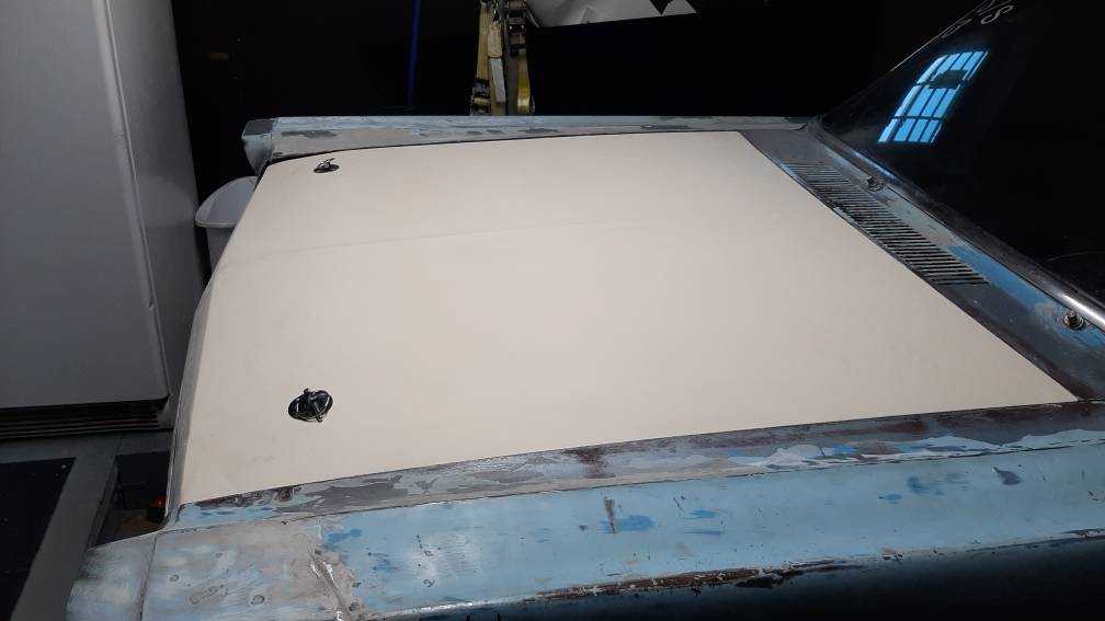

    39 degrees here this morning probably won't warm up enough to shoot primer until after it's time to go to work this afternoon. Maybe tomorrow afternoon.
    Got the hood ready for primer yesterday. Trying to get as much in primer so it doesn't look so ugly.
    Speed Sport TV will be at Shadyside filming for a Mav Tv episode. Hope to go far enough to see the old wagon on TV. That would be cool.

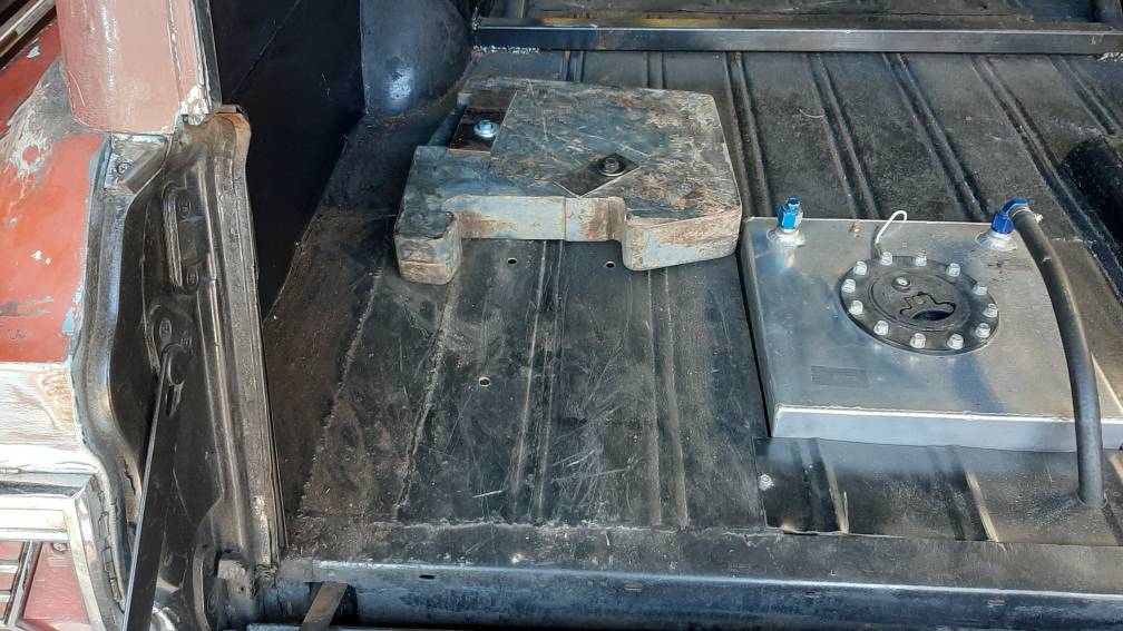

    Supposed to be nice and warm so I can get the hood primed.
    I got a 100 lb. tractor counter weight so I will have a 40 lb. cushion to compensate for fuel burn off.

    I did get the hood primed despite it being very windy. Not going to get a test hit today.
