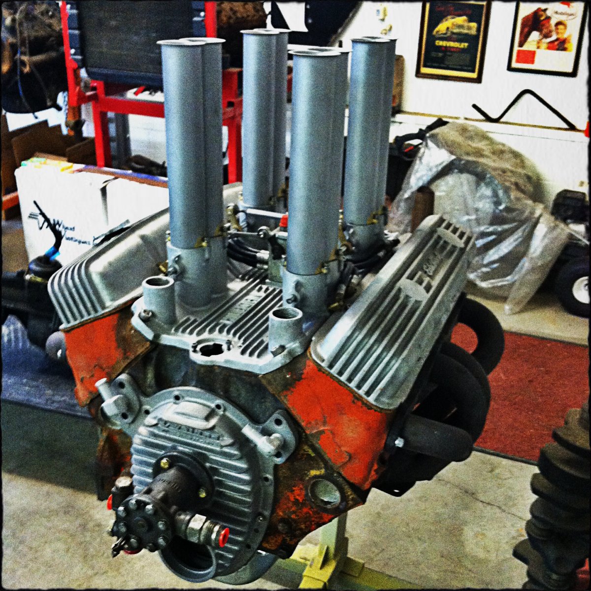

  25. The rear is a 10 bolt, gonna put a 9 inch in it. Got one I'm stripping down to build back up.
    The 327 needs pretty much everything. Our club brother Josh @Tudor hooked me up with a Hilborn injection unit for a 327. Going out to a 331, old double humpers(64cc) for heads. Most everyone says why not go aluminum, those cast head's time has come and gone? I'm not shaving tenths, I want it like early 60's. I'm going for fun, stepping back in time from staging lanes to return road, enjoying it! Need all the rotating assembly stuff. I know the bottom end has to be up to date to hold up. So, check n' see watcha got there Ric, I can prolly put it to good use. Thanks man!
    Here's a shot of the mill to be...
  26. dirty old man
    Joined: Feb 2, 2008
    Posts: 8,910
    dirty old man
    Tim, unless you're just bound and damned determined to run a 327, I would at least go 350. Not a big change in exterior appearance, a few more inches, and the internals are a helluva lot cheaper. Another thing in 350 vs 327 is that with the higher volume of the 350 cylinder, it doesn't take near as tall of a pop up on the piston to get the same compression ratio. Less pop up means faster flame travel and somewhat more efficient fuel mixture intake. Both of these mean more power.
    How can you go wrong with less cost and more power?

  27. II FUNNY
    Joined: Jul 31, 2010
    Posts: 1,838
    II FUNNY
    If that 327 is a large journal, then just put a 3.48 stroker crank in it...period correct.lol
  28. What compression are you thinking about?
  29. If it's a large journal, put it in a 400, and you got a buzz bomb 354
  30. I like the idea of a real period piece though, it goes with your front end.
