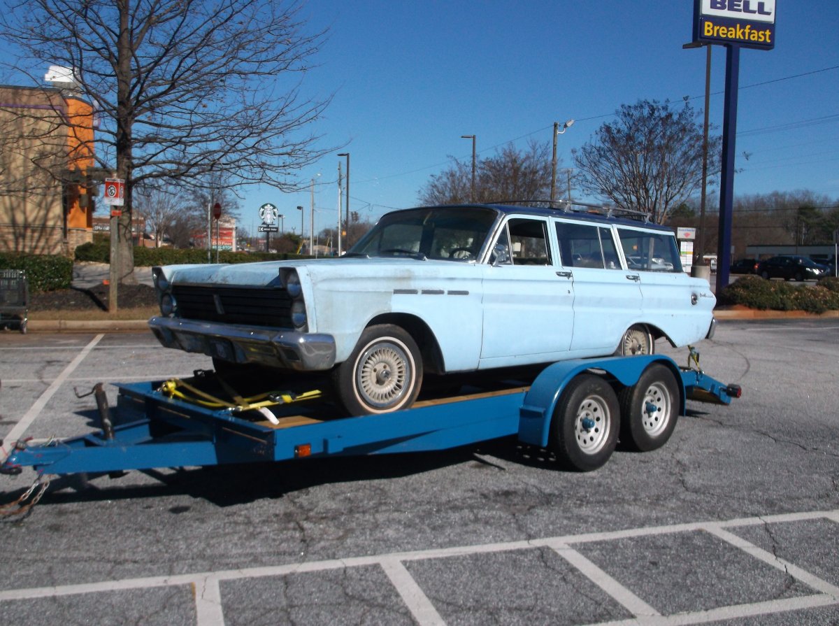

    Here is the car. We went down to Conyers ,Ga. today and picked it up. DSCF3590.JPG

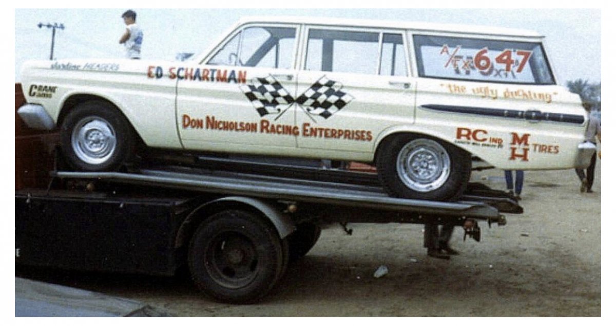

  2. Sweet...can’t await to see what ya do with it...here’s some inspiration... B60F66CD-C20F-4A50-89A5-2F2B5BFF62DC.jpeg 4EC21FE8-F78B-40B8-A77F-63701D16BD82.jpeg

    Cool project! Will you use the six banger front suspension or convert to V8 components? (I noticed the Zephyr 4 lug wheels)

    Love the roof-rack .... are you going to leave it blue as is?
  6. I sure hope so...that 6 banger stuff is pretty thin compared to the V8 stuff..I really recommend Opentracker for parts..

    Thanks to the people who will be following this build. Yes the front end components will be changed to V8 parts. I will be installing disc brakes on the front. I have located a 57 Ford station wagon rear end and I might just put discs on that also.
    First thing to do is to pull the running 6 cylinder 3 speed on the column out. I got a great deal on the car by giving the engine and transmission back to the previous owner so he can install it in a Rat Rod he is building.
    Next will be some floor pan repairs. It is amazing the carpets are really not bad but the floors soft.
    The front and back seats are not torn but I have located a set of early 60's Econoline seats that will replace the front and according to the rules I can remove the back eat and just run carpet or a floor mat back there.
    The rule book says a roll bar or cage is optional . Well this 70 year old racer says that the car will get an 8 point roll bar. I know what it feels like to crash and I know what it feels like to lose friends who thought safety was just an added expense.
    I talked to Robert Peffley who is heading up the SEGA super stock side of the SEGA and he told me that the lift bars from the Thunderbolt Fairlanes and Comets were legal because they were factory. So I will be on the phone with Crites today about a set.
    A fiberglass front bumper and hood will replace the steel ones. Once again legal parts.
    Still haven't located a Super Shifter yet. I have fund a competition plus model, but would trade if anyone has a super shifter for my Hurst inline shifter that is no longer legal in super stock.
    Trying to decide whether to just use the stock clutch linkage or go to a cable like I had on the Morris Minor.
