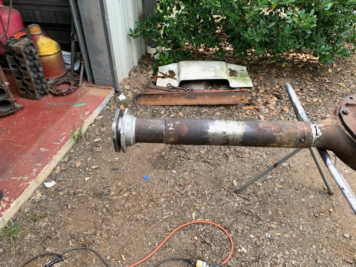

    I sneaked in a few hours tonight, worked on getting the rear end housing ready to mount under the truck. The housing I found for free was in a bad crash and was bent bad. I cut the tubes off at the edge of the center section. I squared them back up and welded back in place.
    I also had an old set of axles that had been laying around so I had to make the housing longer so the axles would work, plus I wanted it longer anyway so the tire would hang out from under the quarter like it would have been in the 1960's.
    I took a pic of the 2" long 3" X 3/16 wall tubing in the lathe while machining it flat. july 2.jpg

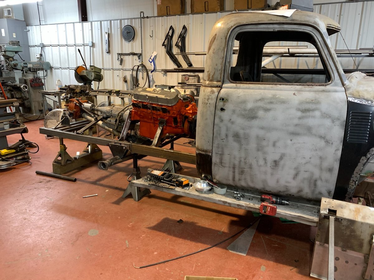

    Got lucky and scored a nice 468 big block for $2,500. It's a big oval port open chamber iron head. It had modern valve covers on it but I wouldn't even let it in my shop until we changed to old school M/T valve covers. I have another intake also that is more 1960's style that I plan to change even tho the one on it would perform better.
    We set the engine in to test fit and get the drive line angle right so the rear end housing could be tacked in. truck 6.jpg

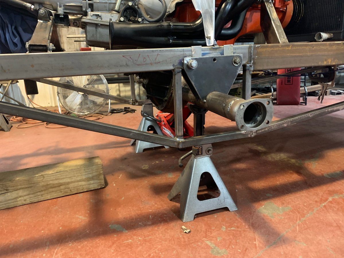

    Earlier in the build we made the housing to frame brackets from 1/4 mild steel plate. The 3 mounting holes were drilled in the frame then a bushing was welded in the frame so the bracket's could be super tight because this will be the only thing holding the housing in place. truck 5.jpg

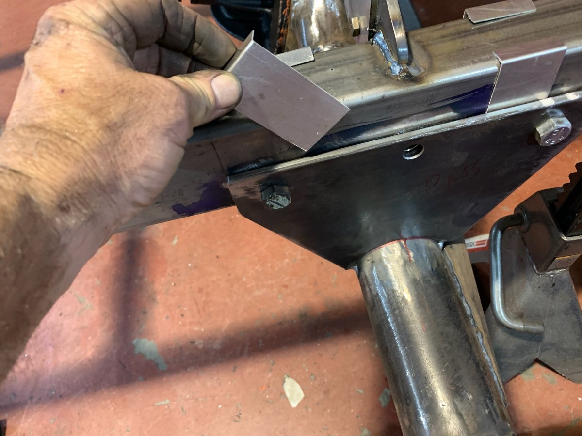

    I always sandwich a shim of about .010 between any double shear brackets no matter what before welding in place. The brackets will flex the extra .010 when the bolt is tight but will flex back open when loosened so you don't have to have a hammer and beat the parts up to get them in or out later for mantance. I see people under cars at the track beating the transmission cross member and such in and out with a hammer because they didn't know this little trick when building the car. Even when doing a quick budget build like this, it still only takes an extra second to do it right. truck 4.jpg

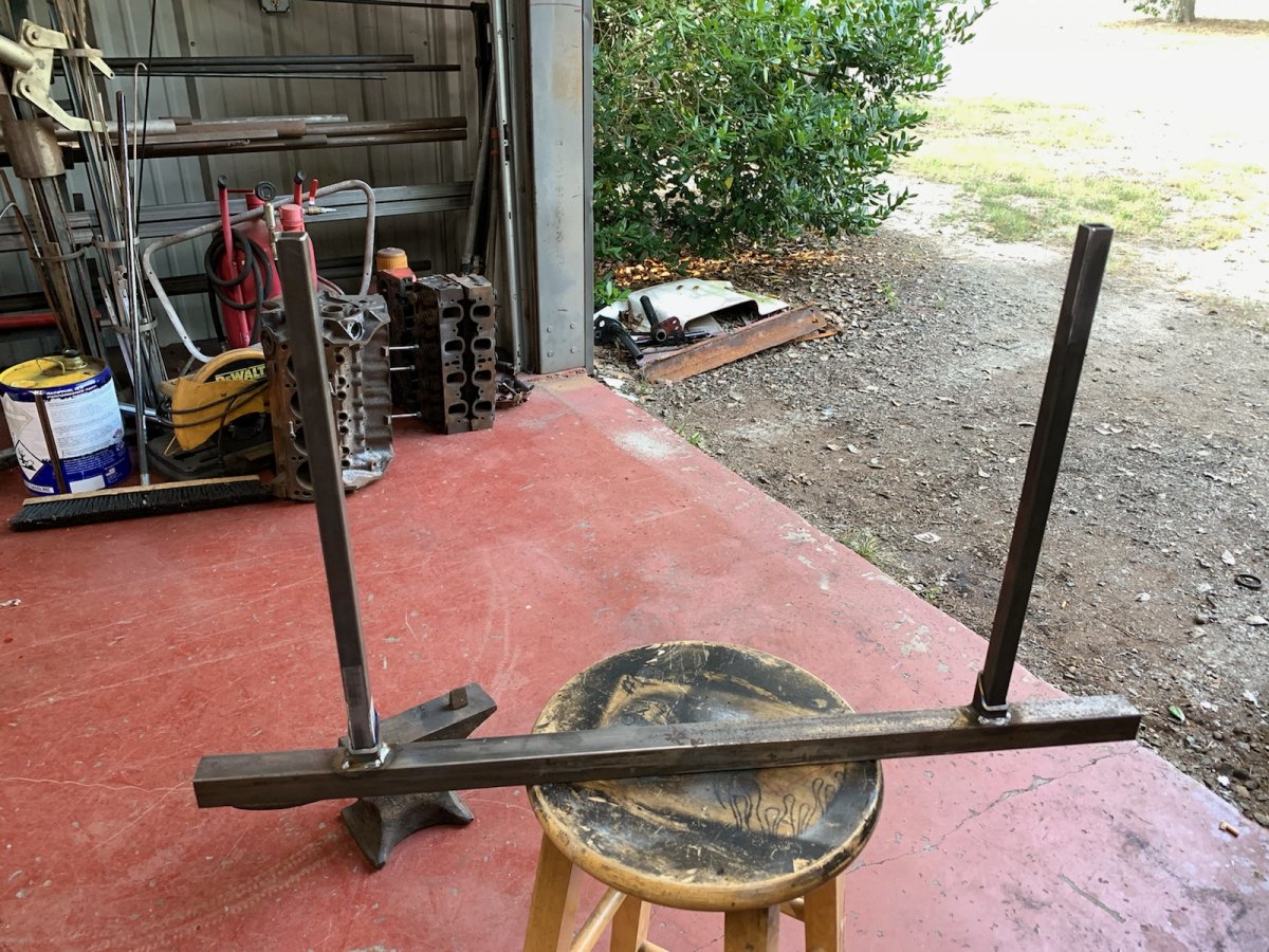

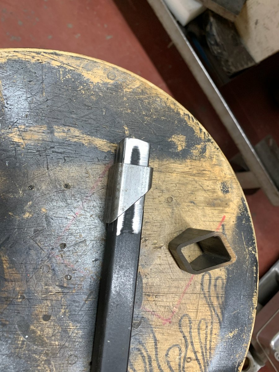

    I hate radiator mounts that are welded to the chassis and not removable. Even when the radiator is out they are always in the way so I always make them removable.
    Here I took a piece of 1" X .125 wall square tube and cut an angle. monday 11.jpg

    Quain Stott
    Clean the edges and file out the seam of the 1" X .125 wall tubing and it's a perfect fit over 1/2 squire tubing monday 12.jpg

    Now weld them to the cross bar that will go from frame rail to frame rail and it makes a nice radiator mount that will be out of the way when doing mantance. monday 10.jpg monday 9.jpg

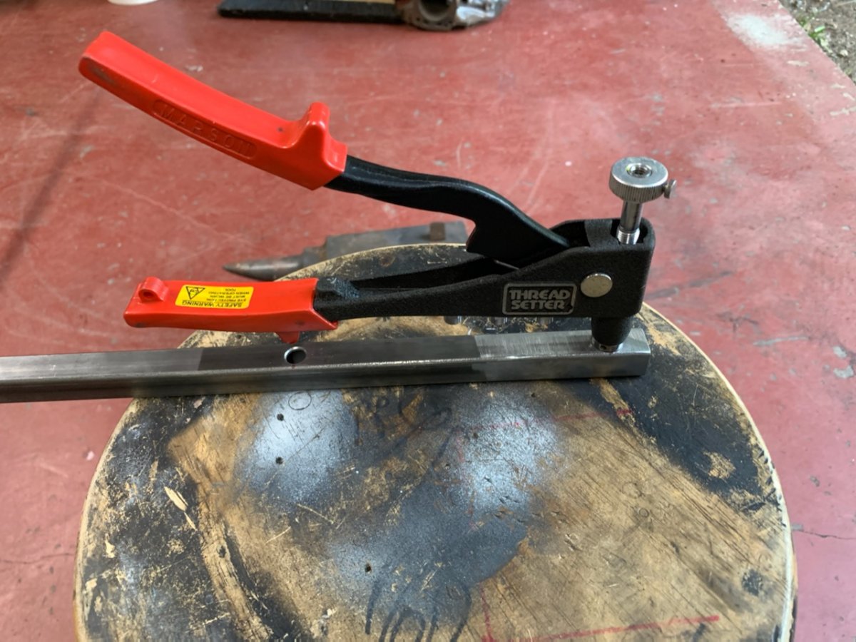

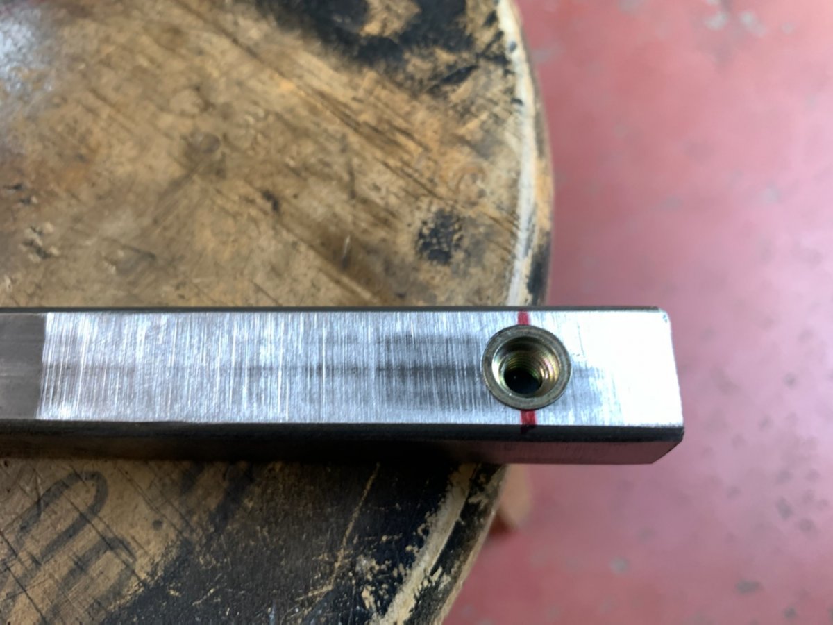

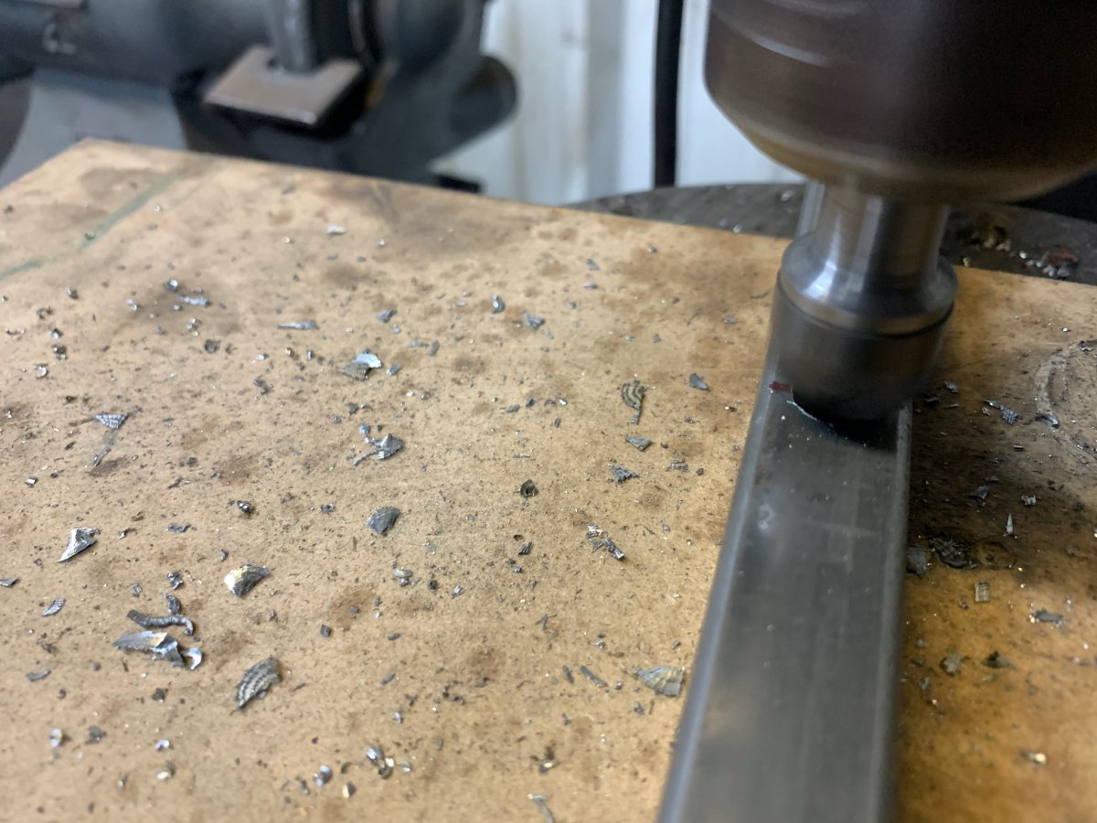

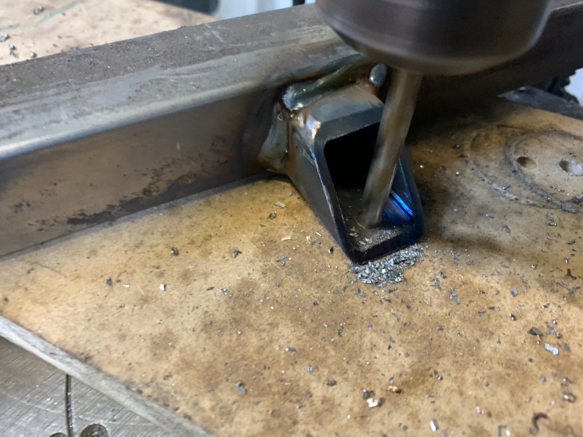

    Posts: 2,025
    Quain Stott

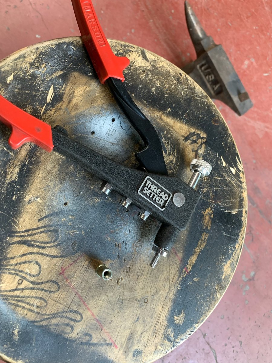

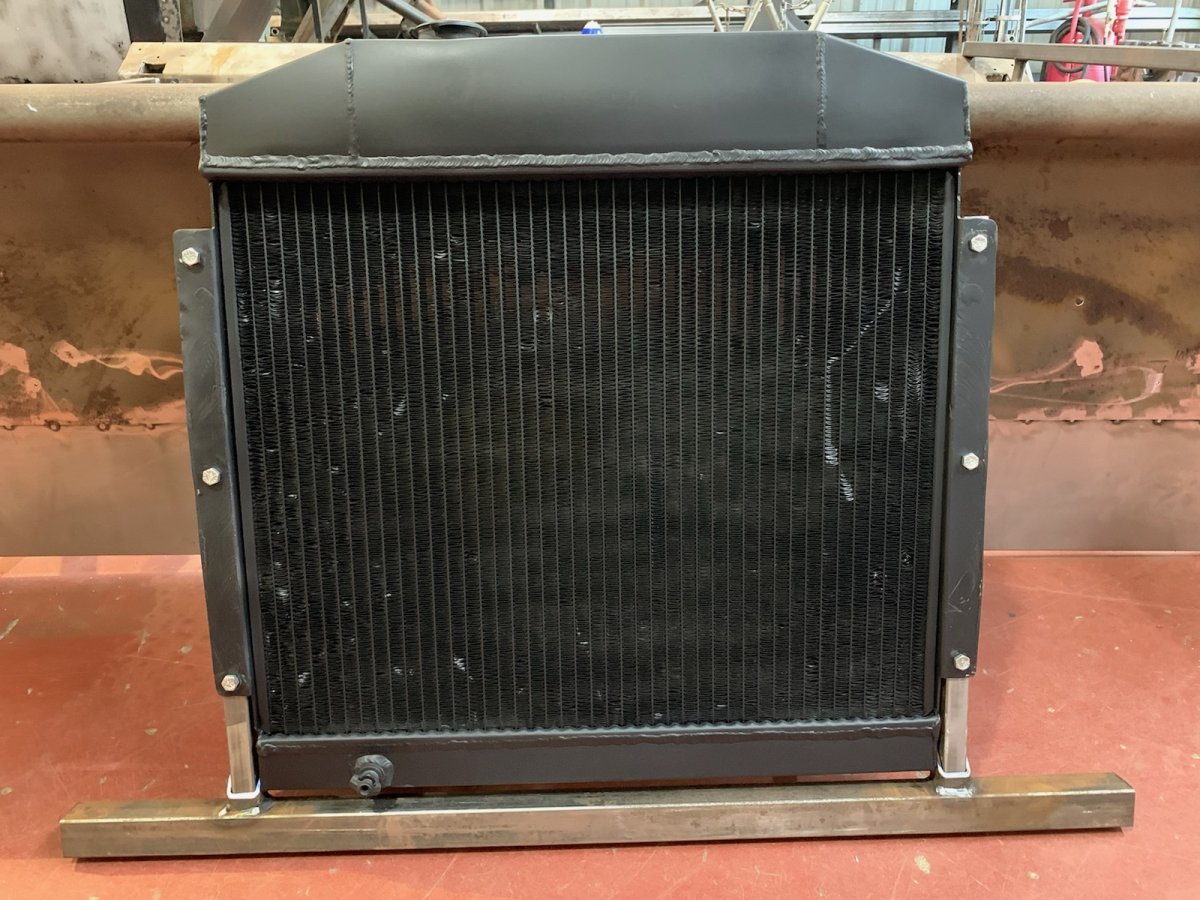

    A neat but simple and quick way to bolt all of this mess together is to use threaded nutserts that work a lot like a rivet. On a high dollar build I would make bushings and weld them in but a hurry up budget build like this I'm taking these sort of short cuts.
    This group of pics will go through the process of drilling and installing the nutserts monday 8.jpg monday 7.jpg monday7.jpg monday 6.jpg monday 4.jpg monday 5.jpg

  21. Quain Stott
    Joined: Nov 21, 2006
    Posts: 2,025
    Quain Stott
    3 equally spaced threaded bushings on each side to mount the radiator to. monday 3.jpg

  22. Quain Stott
    Posts: 2,025
    Quain Stott
    Same nutserts to bolt the removable stands to the stationary cross member that will be welded in later.
    The welded on mount will only get a 1/4 hole for the bolt. Another netsert will be installed in the removable stand. monday 2.jpg

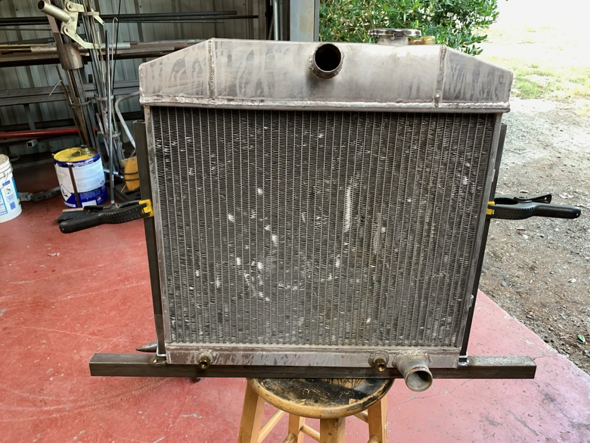

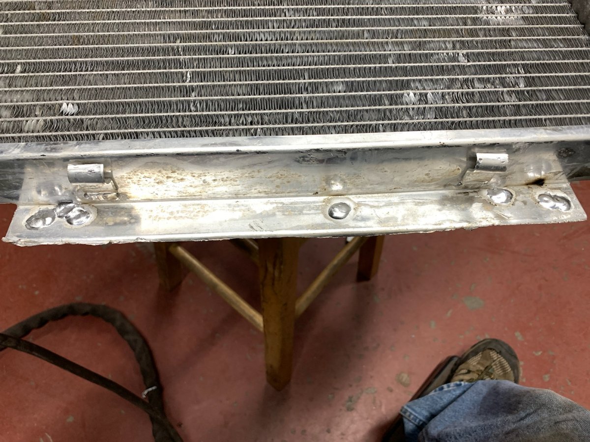

    I picked up a cheap swap meet radiator but it had a bunch of random holes drilled in the mount so I welded them up and sanded them back down to like new condition so I could drill my holes and make them look a little better. I also cleaned up the rough edges on the mount. The radiator will be painted black, an aluminum radiator is a bad eye sore in a 1960's style build. monday 1.jpg monday.jpg
    catdad49, enloe, AHotRod and 5 others like this.

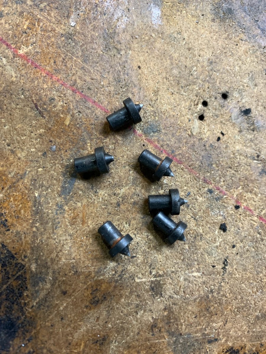

    Posts: 2,025
    Quain Stott

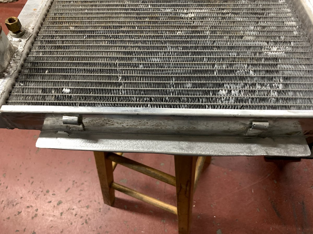

    I use these little punches that fit into the threaded insert to locate the hole in the radiator side mount. I have these for most any size hole. I'm guessing they are about 35 years old, I have had them that long and I think I bought them used. For more precision work I machine a point on a bolt head and then screw it tight into the hole for a perfect transfer with no slop. tues.jpg

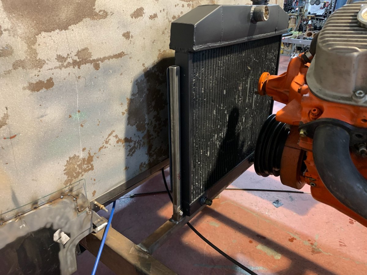

    The finished radiator mount with the radiator painted to look a little more like it would have looked in 1967. tues 2.jpg

    Radiator mount welded in, another small project marked of the list. tues 8.jpg

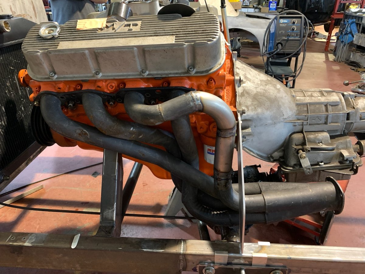

    Posts: 2,025
    Quain Stott
    Like everything else on this project I found a junk set of headers for near nothing. Of course they don't fit right so we changed the rear tube on each side.
    Didn't worry about tuning to the right length because it's not that important on something that has no completion. Even not trying they are not off much tho. tues 5.jpg tues 4.jpg

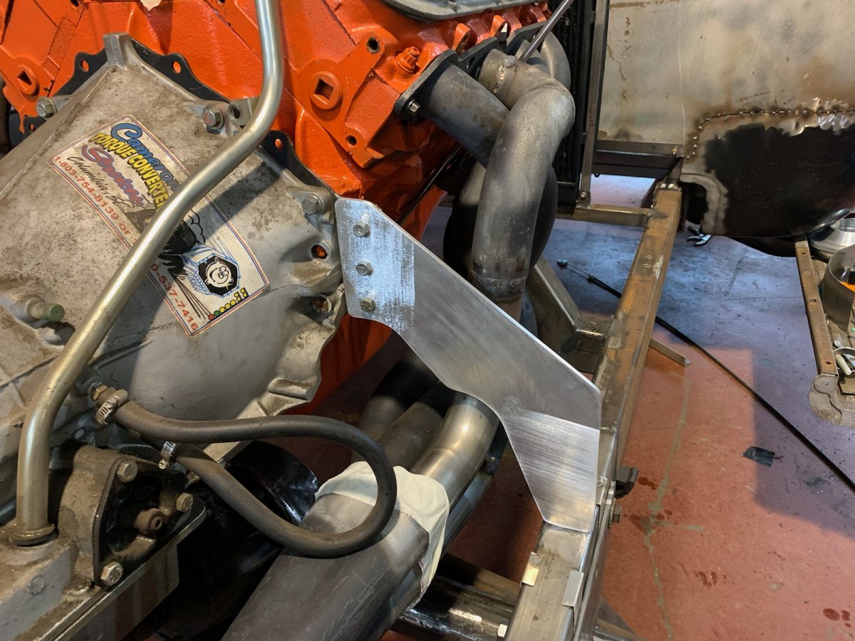

    Posts: 2,025
    Quain Stott
    Had a little boo-boo on the mid mounts. We built them before we had the headers so of course we put them in the wrong place. It's easier to remake the mid mount's than build a set of headers so we trashed the first mid mounts and whipped two news ones. Had to change the frame mount also, still have to make frame mounts at this point. tues 6.jpg tues 9.jpg

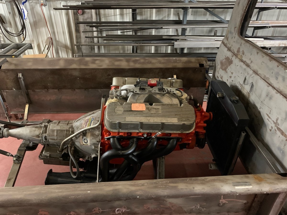

    Posts: 2,025
    Quain Stott
    We set the bed on it to get a look at what kind of room we have to mount the gas tank and things like that. Oh yea the intake will be changed for a more correct dual plane 1960's era intake. 7-22 2.jpg
