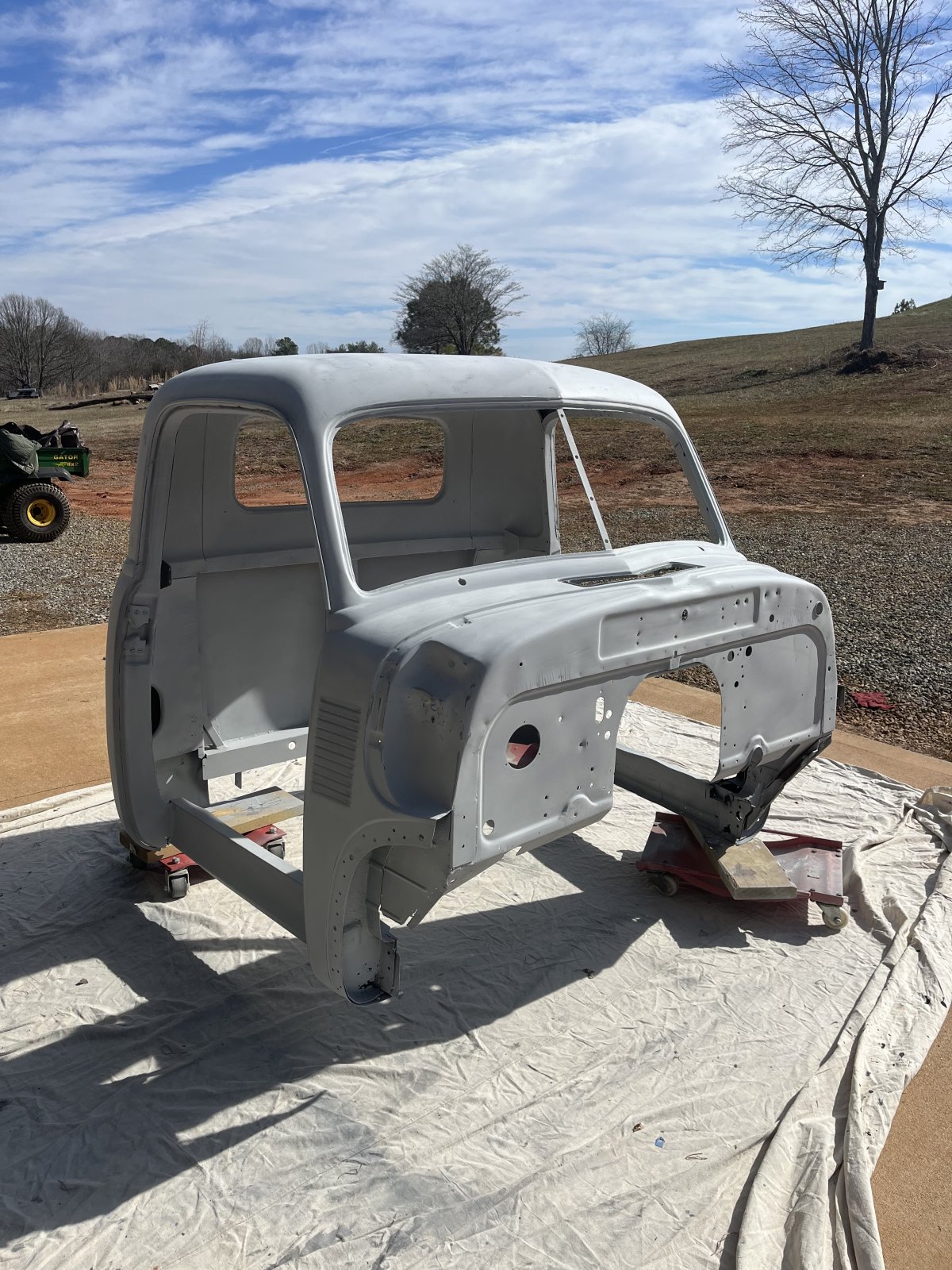

    Sorry it’s taking so long but life keeps getting in the way. I’m back on it but it’s going slow. Big thanks to Hamb member Tony Turner (dog_patch ) for getting some primer on the cab so we can get it mounted. IMG_3752.jpeg

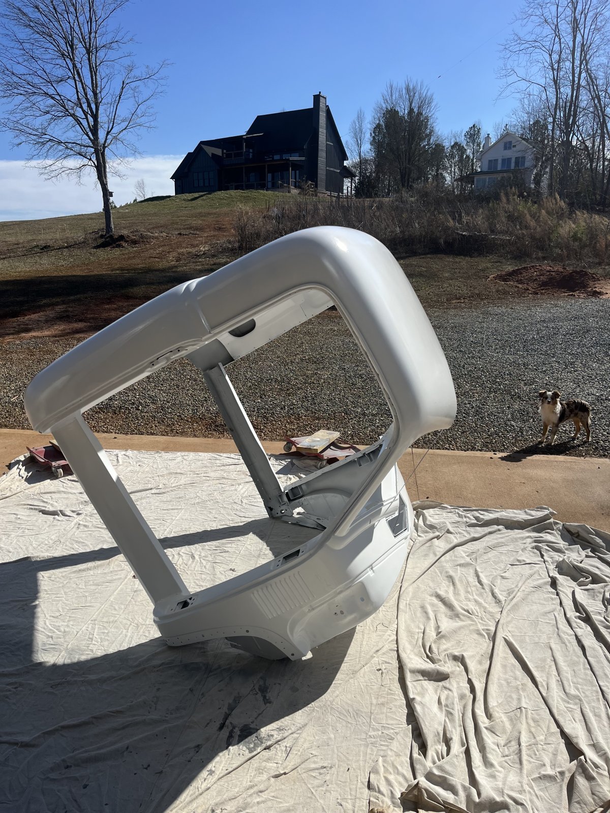

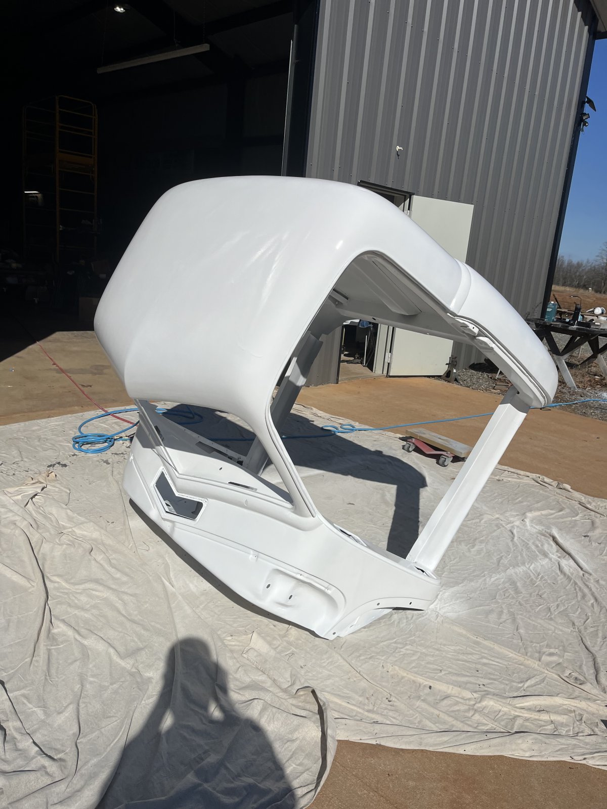

    Cab is painted and ready to set on the chassis. Special thanks to Tony Turner ( dog_patch) for the paint work. While we’re installing the body and putting the truck together Tony will be painting all the other body parts IMG_3754.jpeg IMG_3753.jpeg

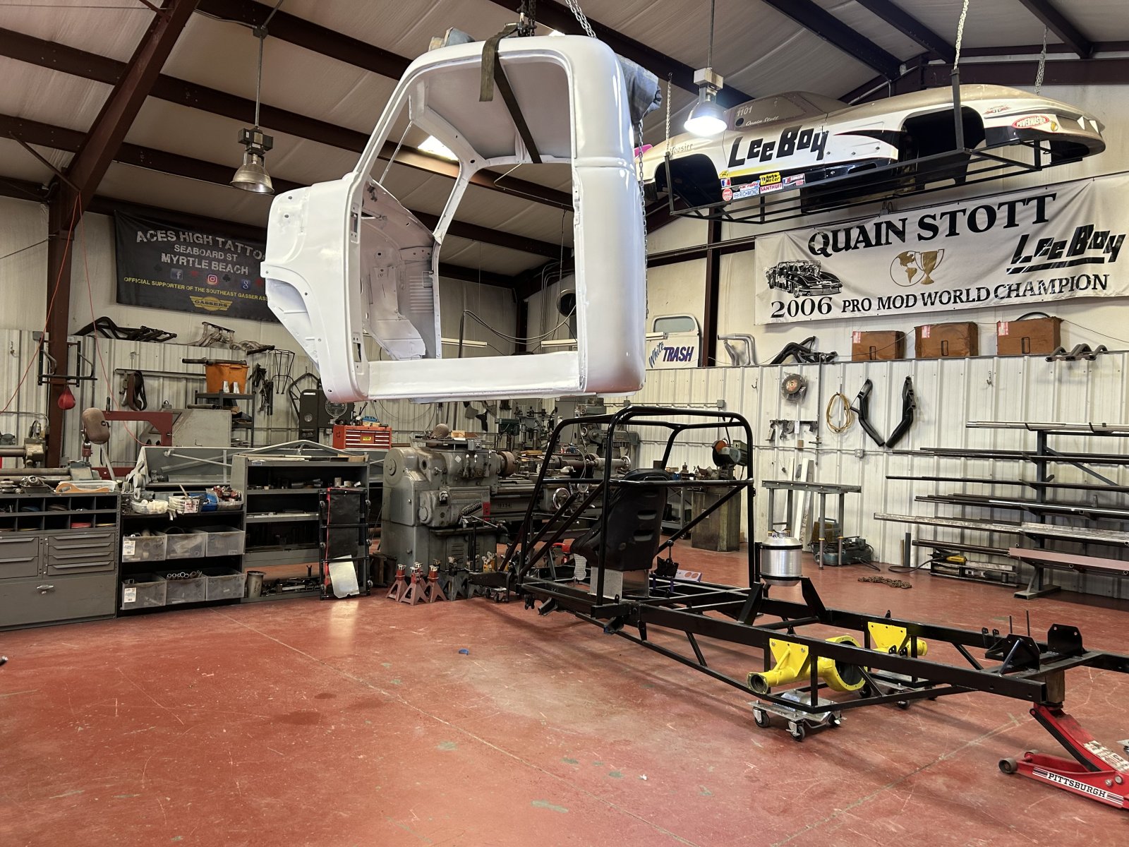

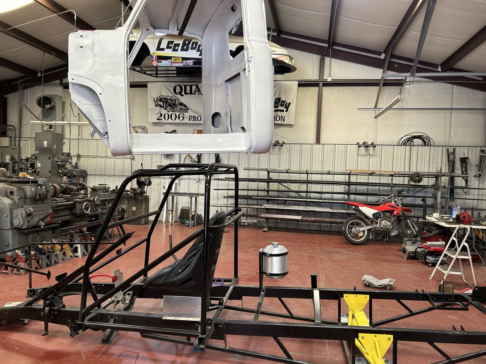

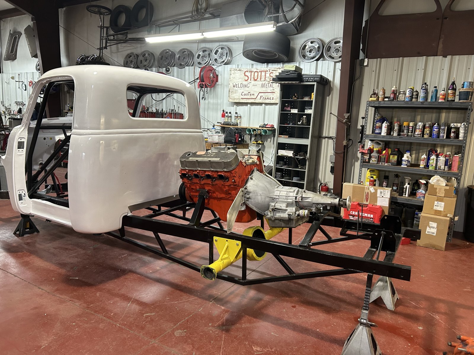

    Going up with the cab, got to go high to clear the roll cage. IMG_0653.jpeg IMG_0657.jpeg IMG_0658.jpeg

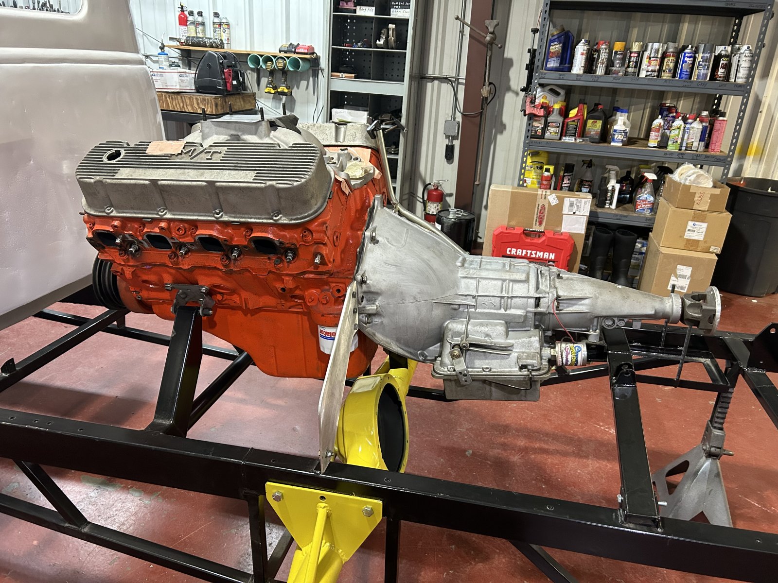

    IMG_0666.jpeg IMG_0665.jpeg Moved the truck to the final assembly side of the shop. Set the engine and transmission in place.

    I do not know what the old show wheel standers did; but do you plan any oil system modifications to keep the engine alive for 1/4 mile pass? Seems like you might want a dry sump system with back of the pan pickup. I guess the automatic would be ok?

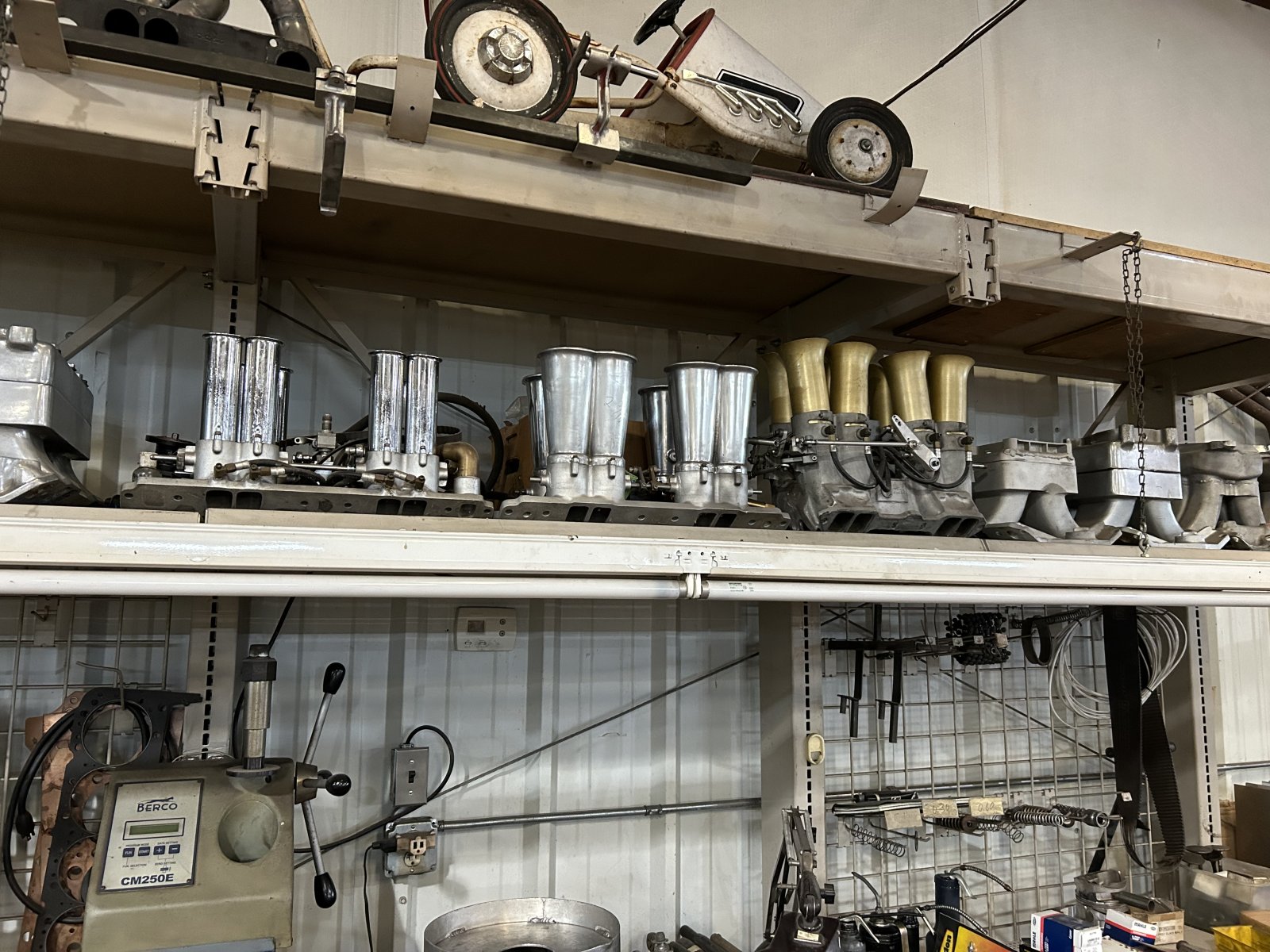

    The pump will be in the back so shouldn’t be any problem. I’m more worried about the carburetors, most of the old ones were fuel injected,

  24. saltflats
    Joined: Aug 14, 2007
    Posts: 12,602
    saltflats
    from Missouri
    I have a Crower stack injector if your interested.

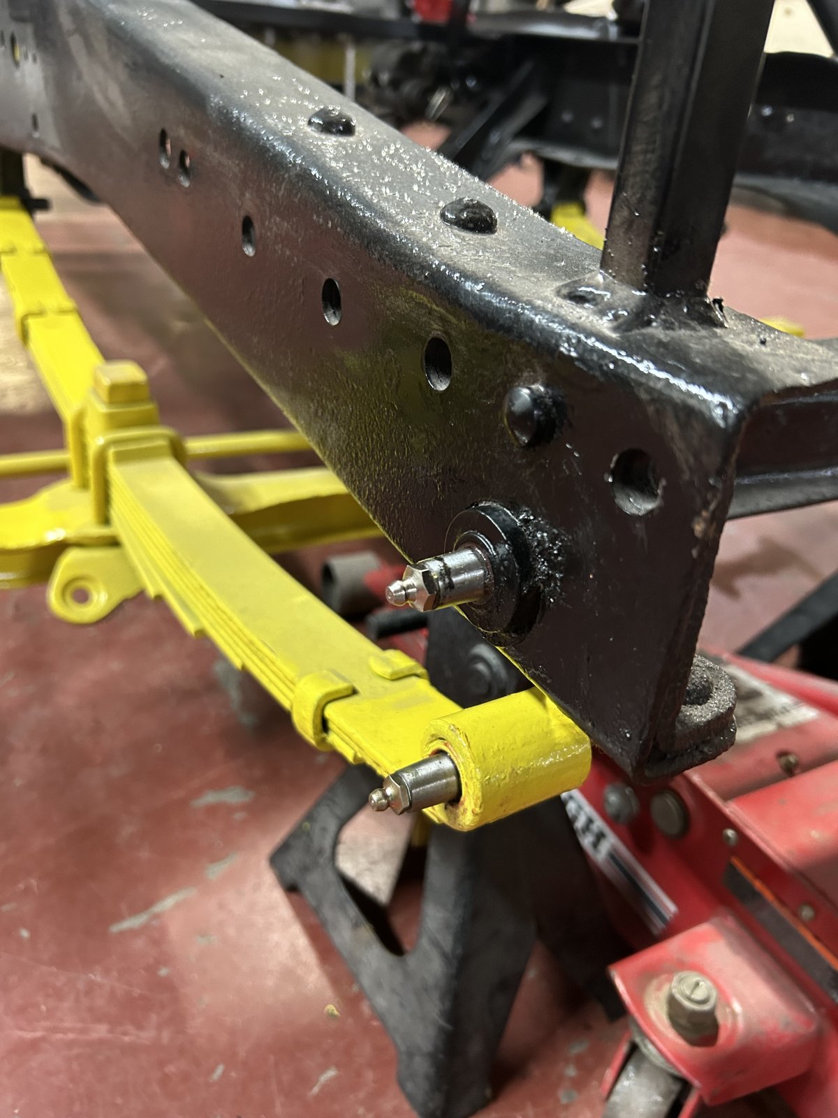

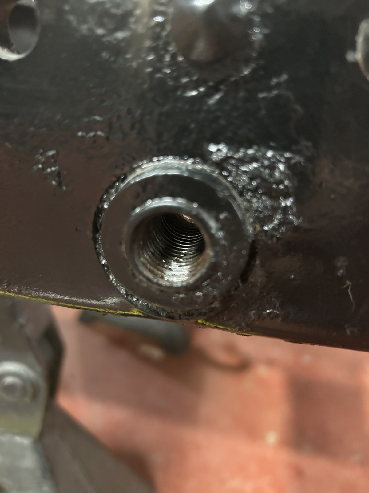

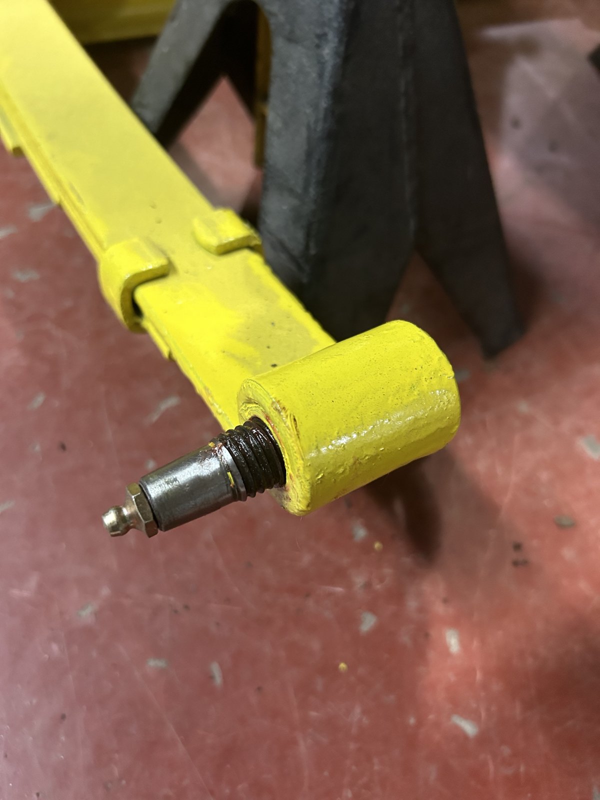

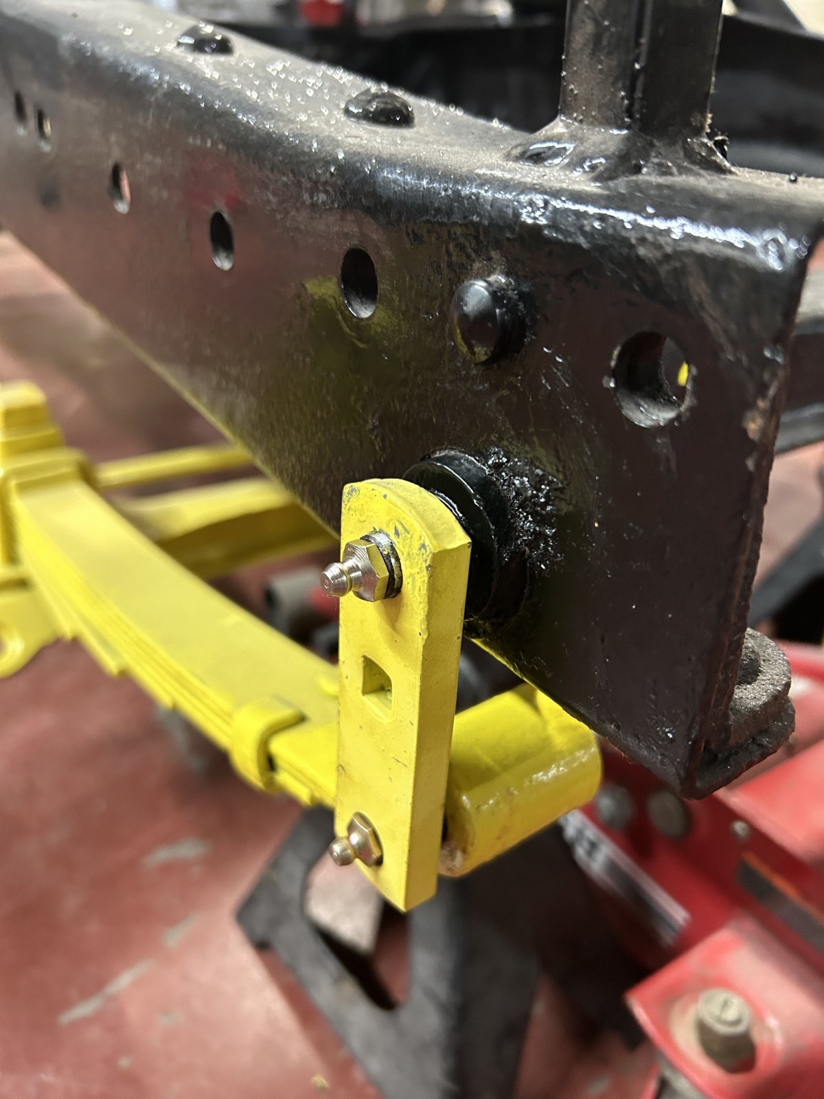

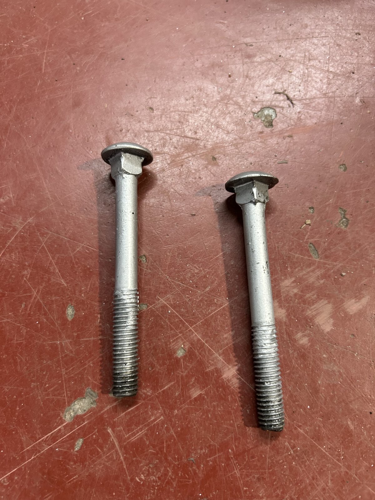

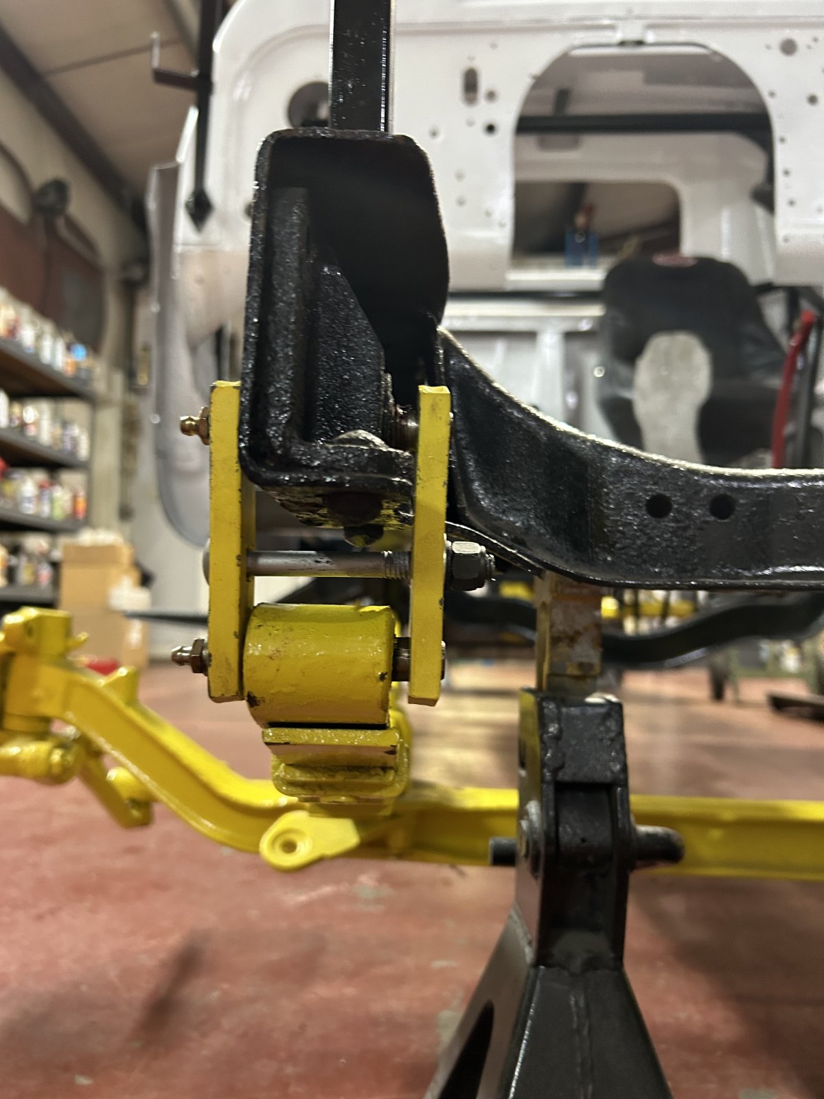

    While install the stock front axle I learn something very interesting about these Old Trucks. The shackle bushings were screws. I took it all apart and they were in perfect shape. IMG_0668.jpeg
    LOST ANGEL, SS327, 41 coupe and 10 others like this.

    I have a Collection of injectors and might put one on it later if all works out well. At first I want to keep it as simple as possible LOL. IMG_0795.jpeg

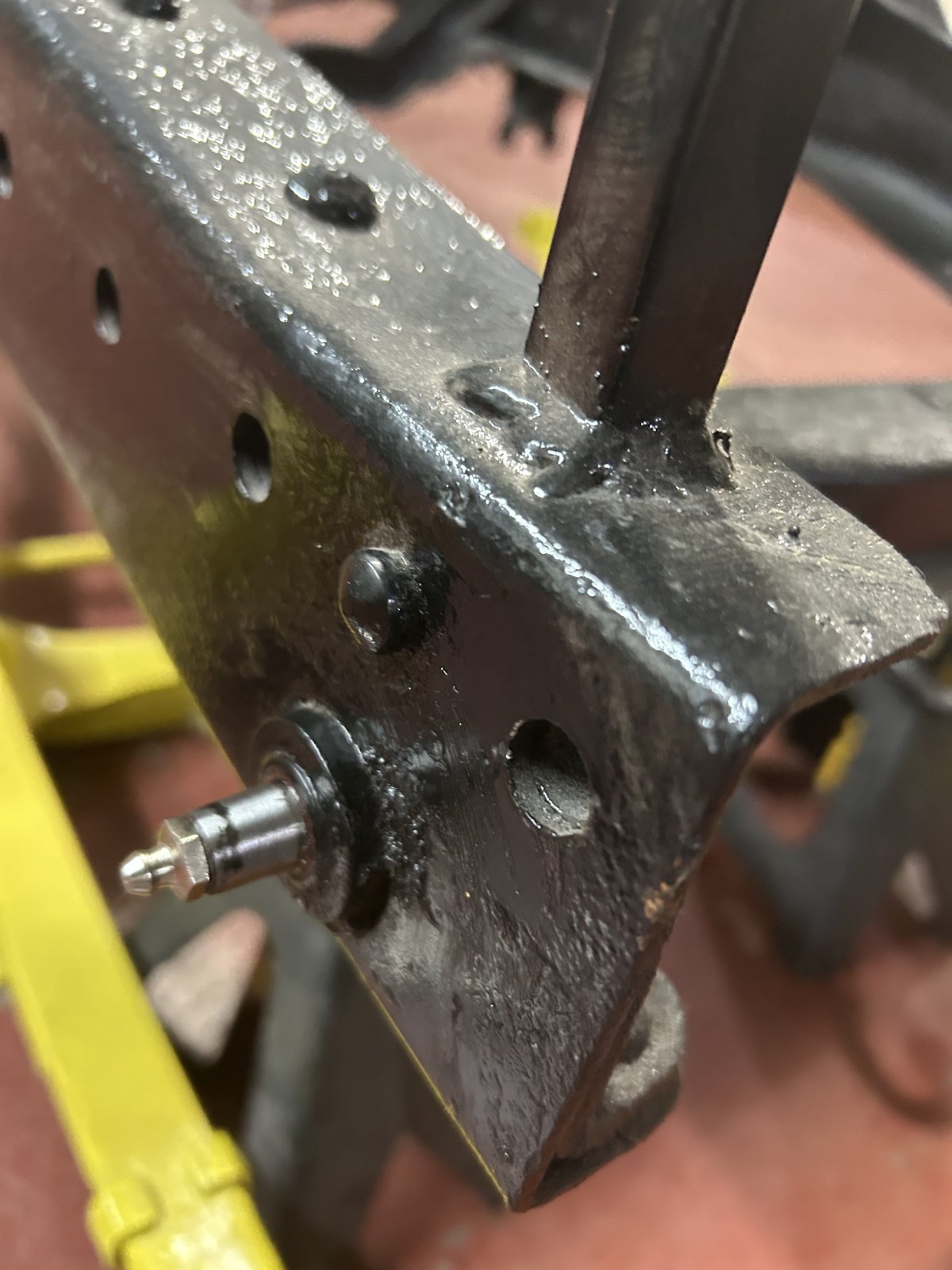

    Here’s a some pics of them screwed on to kinda show how they work. They have grease fittings one end. IMG_0671.jpeg IMG_0673.jpeg IMG_0672.jpeg

    The shackle bolts or what ever they’re called have a taper on each end. The shackle also has a taper so they slide on then a bolt goes through the middle to hold them in place. The taper locks them so they will work when the spring works. IMG_0678.jpeg IMG_0679.jpeg IMG_0681.jpeg IMG_0812.jpeg
