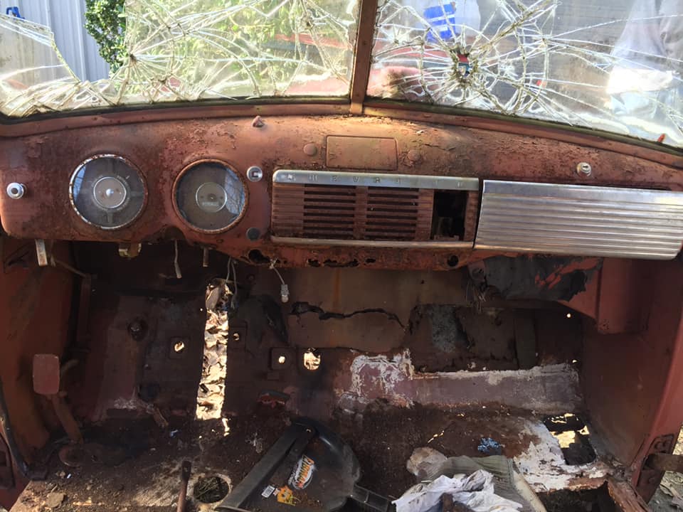

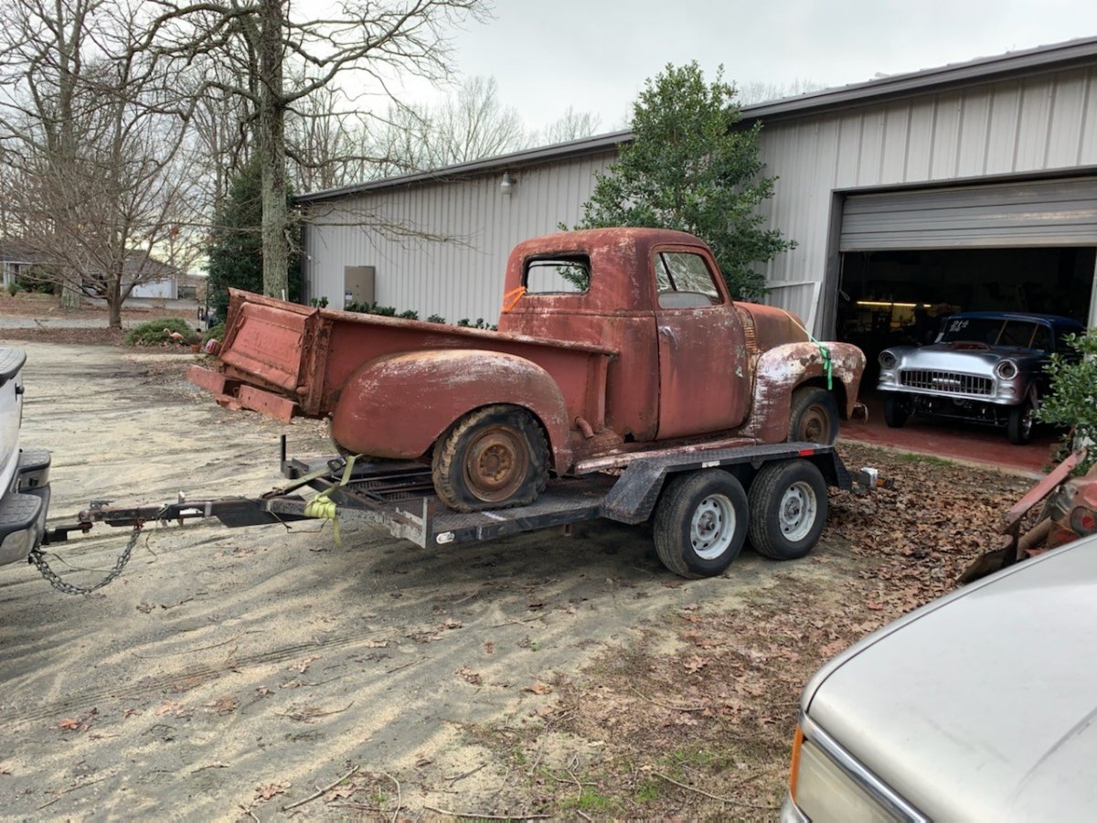

    This body was so rusty the chassis right behind the cab had rusted into and broke when we was loading it. Talk about saving one that was on it's way to the crusher. wheel stander 2.jpg

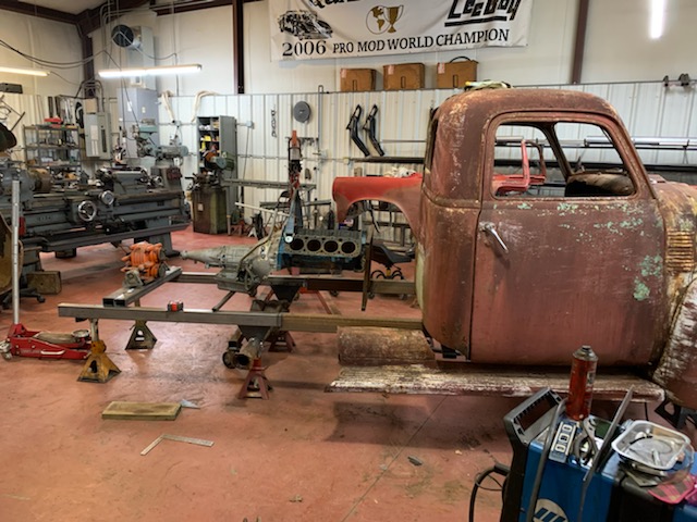

    First step was to get it all apart and cut out what was left of the old floor that we wasn't going to need anyway. My right hand man Tom White handling that. Wheel Stander.jpg

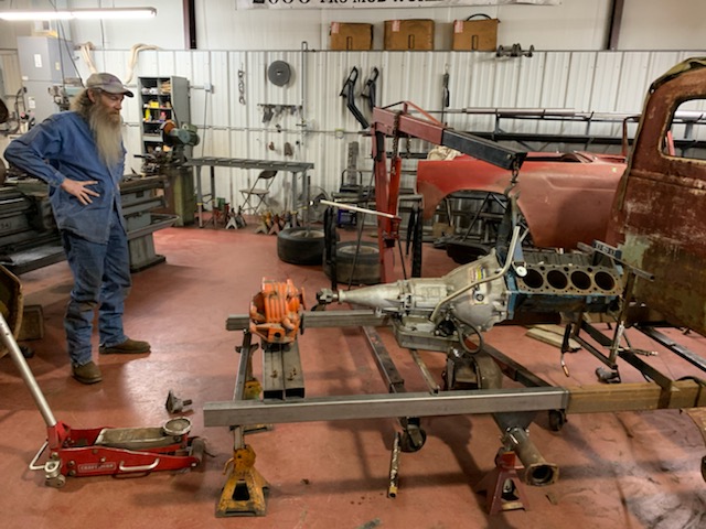

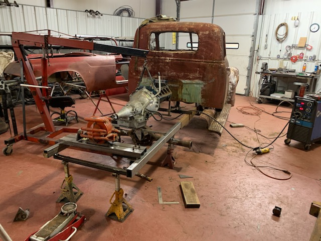

    Chassis repairs done, setting at ride height with engine, trans, rear end and V- Drive mocked up ready to make mounts. Tom White checking our progress.
    (I know it's a sissy automatic but it's a wheel stander what else could I do)

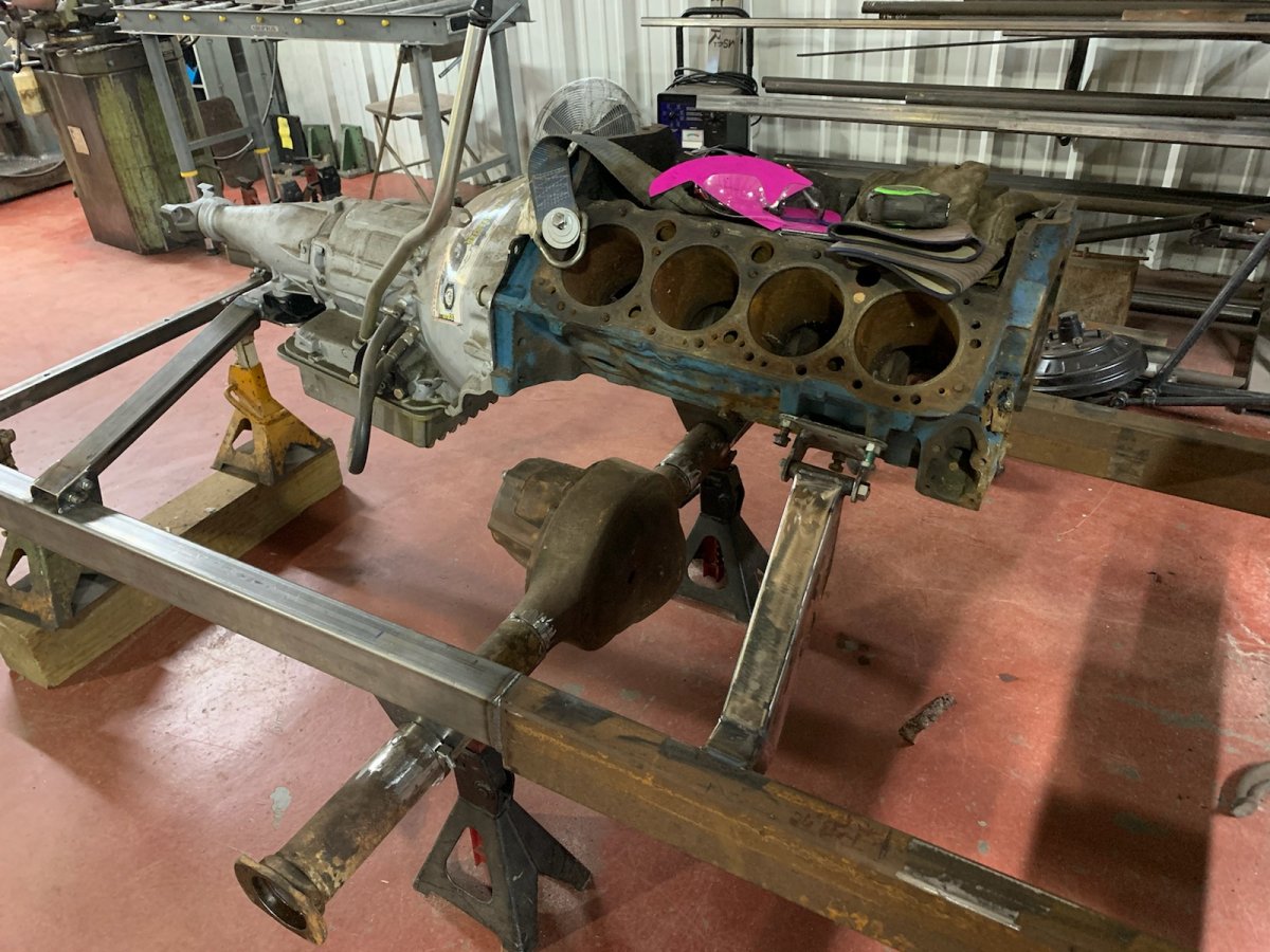

    With everything where we think it needs to go we made mounts. My first wheel stander build so I really don't have a clue. Note the trans cross member made to clear the drive shaft that has to come back under the trans to the rear end yoke.

    How does that work? Two speeds in reverse and one forward? Or does the v-drive make everything right. Noticed the diff is flipped over. Or am I thinking double backwards. LOL. Lippy

    Posts: 2,025
    Quain Stott
    The V-Drive makes everything right. It's also 10% under drive so I'm thinking a 4.10 gear will be about right. I seen some that are running off the coast side of the ring gear and that can't be right for long term life.
