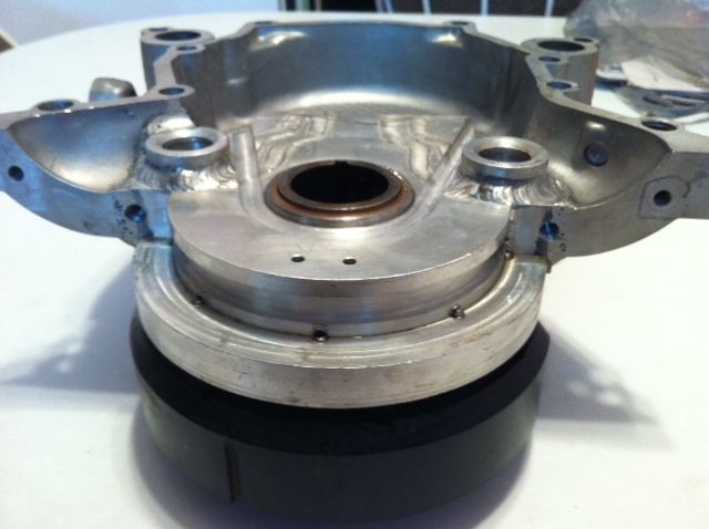

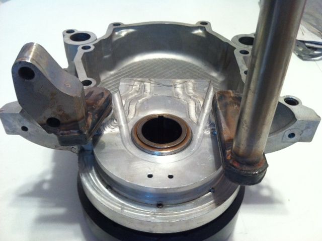

    Below are a few pics of a project that started in my mind about 20 years ago. It was an effort to change the outward profile of SBF's with regards to early car swaps. I wanted to design a system that removed all the perceived problems with swapping front oil pumped SBF's into mainly early Fords with transverse spring front suspension. There is an interference problem with oil pump to crossmember clearance in stock frames/chassis mainly with `35- `40 Fords. Today the easier solution is simply modifying the crossmember by moving it down slightly and using a de-arched spring to maintain proper ride height. Back then I was trying to remove the excuses that people used as reasons why some form of brand x engine was used to repower their early Ford.
    This is a crank driven Gerotor oil pump, integral with the front timing cover. It eliminates the stock oil pump, driveshaft and front sump/bump oil pan. I don't have any video of it running because at the time I did not have a digital camera or video machine. I did have it running and it performed very well. A few individuals with an interest in early hot rods at Ford Motorsports (called that at the time) were quite interested in the outcome of this thing. Unfortunately I was not able to secure enough funds to bring this to fruition.
    One might notice that the current V8's coming out of Detroit employ a similar oil pump configuration. I got the idea while thinking of the front pump assembly in an automatic transmission and the crank driven P/S pumps of the mid 60's Lincolns. This was an attempt to meld the two together to pump engine oil and thereby creating an even more compact and tidy profile for the small block Ford.
    So here we go with some pics.
    prototype of assembly front view
    and from the inside
    from the front cover off
    close up of gears
    exploded view
    drive hub
    gear on hub
    fairly good packaging
    assembly
    pickup and delivery plumbing
    all together

    Nice! Any pics with it installed? What kind of pressure does it supply?
  6. Henry Floored
    Joined: Sep 18, 2004
    Posts: 1,370
    Henry Floored
    I think I have one or two scans of small photos of it all installed on my test engine. I gotta dig around for them. As far as supply pressure goes we had it arranged to be adjustable on the prototype. I think we dialed 20lbs hot at idle and only tested up to about 3500 rpm with the engine freewheeling. Never did get it on a true dyno. If memory serves me correctly she went right up to 50lbs + at speed. Final pumping pressures and volume was one of the expensive steps to be learned in dyno testing. I came close a couple times with interested parties but never could tie the knot.
