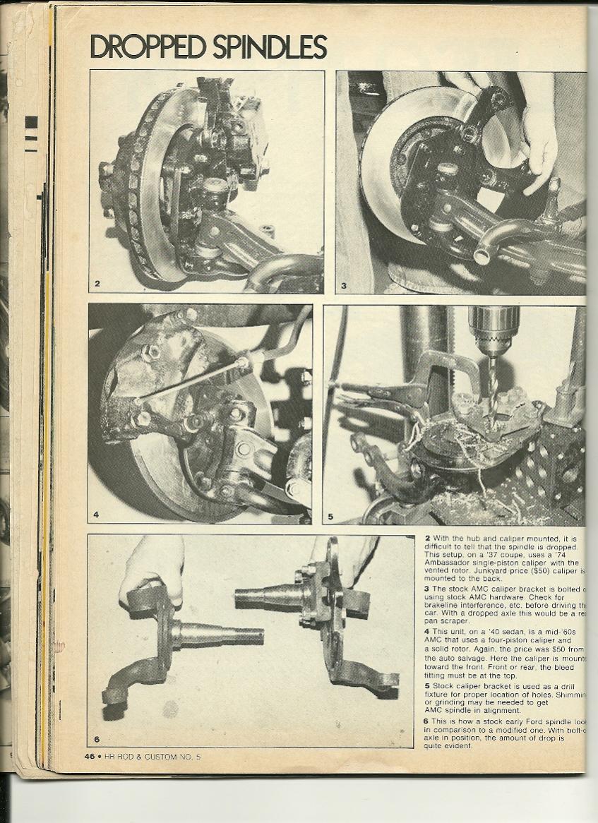

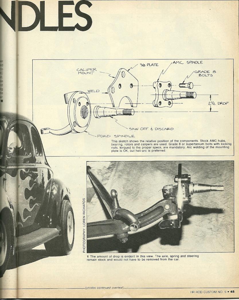

    As far as the dropped spindle thing goes, most these guy must not remember the AMC thing from the pages of Rod&Custom about 35 years ago. If I have time I'll dig up the article and scan and post. It mimics what AMC did on millions of cars for years, so I wouldn't have a hard time with that. It also gives a set of 11" disc brakes too. I have done this before, but like I said, never on a truck.
    The other thing, I wouldn't be too upset about mounting the axle on top of the springs either. All of the weight hanging from the U-bolts wouldn't be a detriment when you think of the fact that 99.5% of passenger cars with leaf springs have most of their rearward weight hanging from the U-bolts too. I'd be much more concerned about steering geometry and axle to frame and oil pan clearence before Physical forces with that move.

    Okay, here's what I'm thinking. I did this years ago on my '48 Plymouth spindles and know others that have done this as well. Seems that when I started out in this stuff, you didn't just call the hot rod store and order what ever you needed to make things happen. With that said though, I by nature am completely crazy about hardware grading and quality, and stuff such as testing of welds meant for suspension use. Oh, matching weights of donor parts with inteded use vehicles as well. I would not want some one else to repeat the above ride. I might add that although the article sources mid sixties AMC stuff, it remained the same all the way to the end in '87 or so. Matter of fact, caliper on the later stuff is the same as G.M. Pretty sure rotors were too except for 5 on 4 1/2" bolt pattern.
