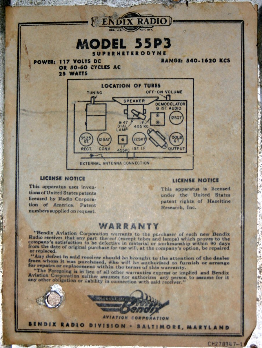

    Below is the label on the bottom plate, showing the specifications and the tube line-up. Notice the RCA license notice (they had a patent on superheterodyne receivers) and the "Bendix Aviation Corporation" logo at the bottom. The frequency coverage doesn't include the 1620 to 1710 kHz range that modern radios cover -- at the time this was made, that was a police band.

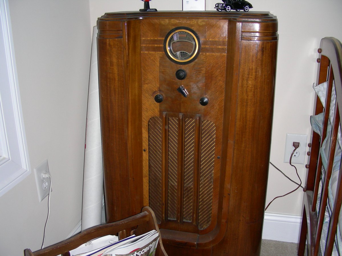

    This one is my favorite. A 1936 Philco 610F.
    As was common at the time, the Model 610 was sold in a number of different cases. This was the console version; there was also a fancier console with a phonograph, and a couple of tabletop versions. This version sold for $49.95 at the time, equivalent to over $900 in today's money. No doubt this was the centerpiece of someone's living room, the way a big-screen TV would be now.
    It has three bands -- the standard AM broadcast band, a police radio band (now an expanded part of the broadcast band), and a shortwave band. The tuning knob is two concentric knobs, one fast and one slow, for fine tuning.
    Electronically this is another five-tube set, but this one has a transformer and is generally constructed more carefully than the All-American Fives that would come later.
    The dial is quite lovely, translucent with a shadow mask pointer:
    On Halloween I have a tradition of setting up a short-range radio transmitter and playing Orson Welles' 1938 broadcast of "War of the Worlds" on this radio.

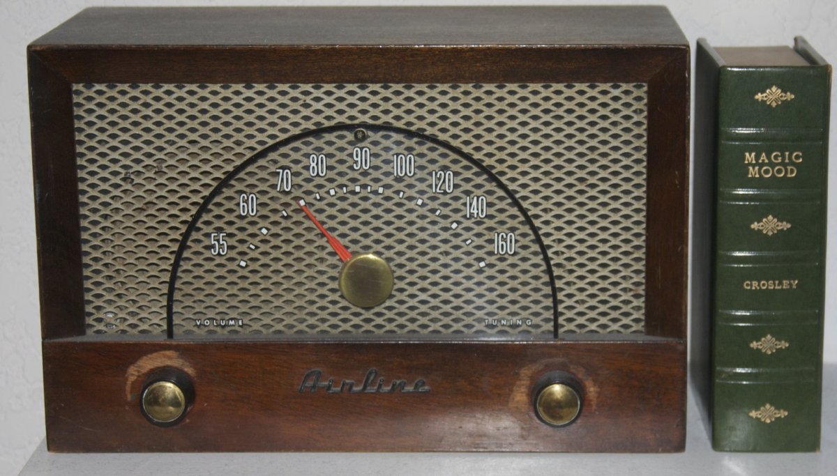

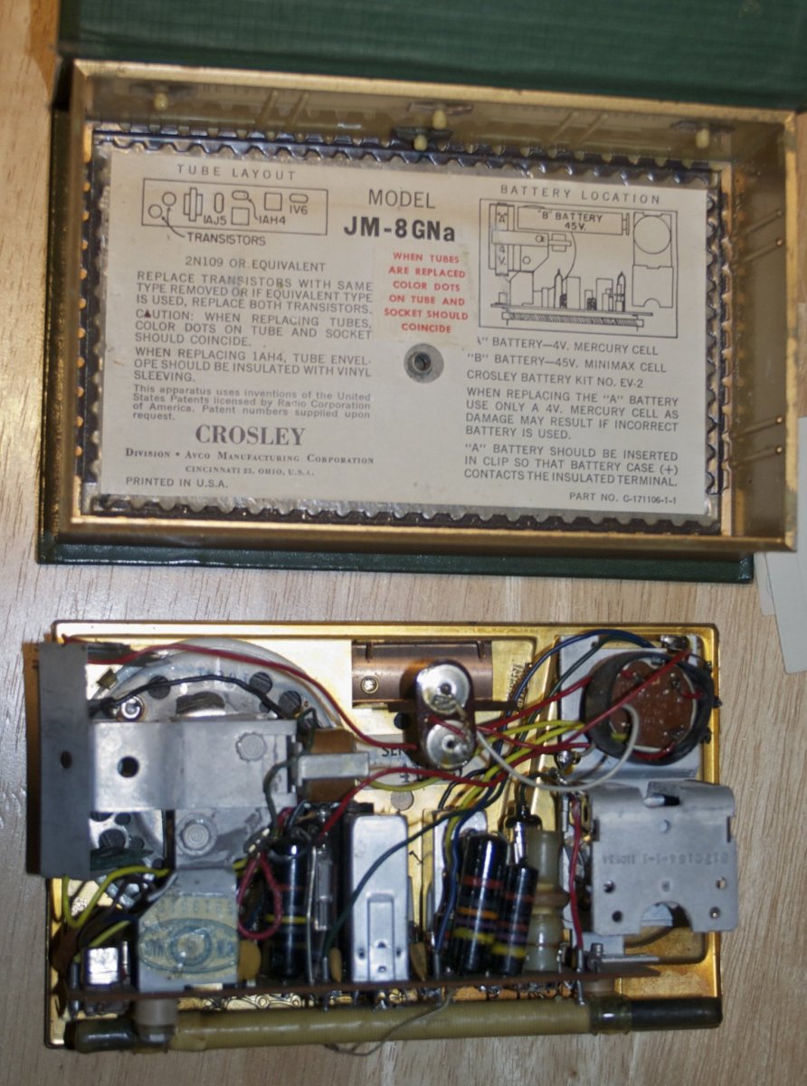

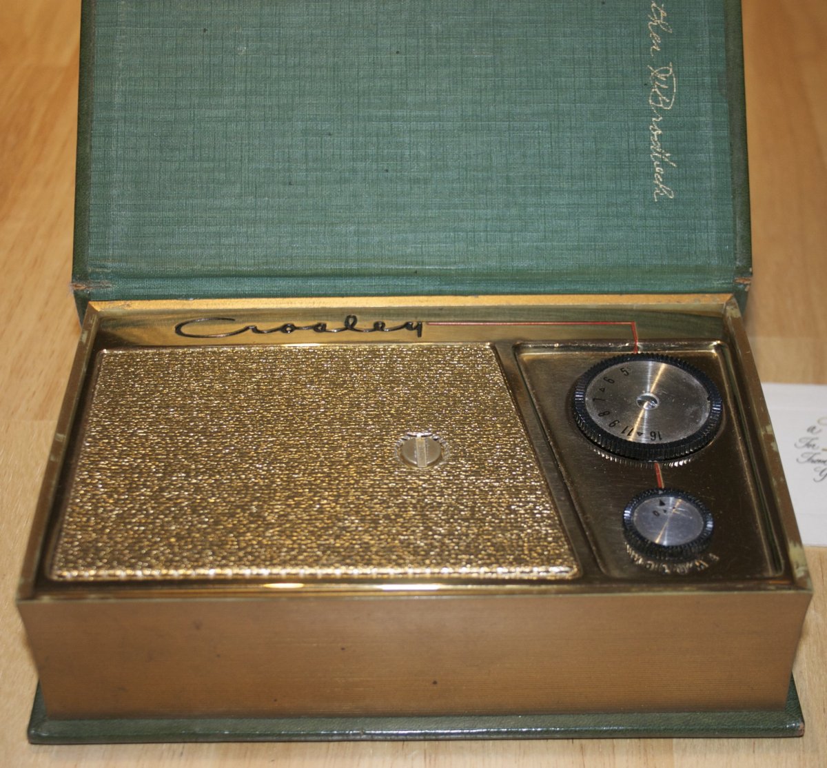

    Here's an interesting one -- a Crosley JM-8GNa portable, in the shape of a book. This is what collectors call a "novelty radio."
    Battery-powered tube portables were nothing new by this time -- miniature tubes made them possible, but they were still fairly bulky and power-hungry. This one, though, used a new device called a "transistor..."
    This radio was a hybrid, using two transistors in the audio amplifier stage while the balance of the radio still used tubes. Partly this was due to a lack of expertise using transistors in RF stages, but it was also because these transistors were still very expensive. When this radio was introduced in 1956, each 2N109 transistor cost the equivalent of $20 in today's money. One thing to note here is that, like the tubes, the transistors are socketed. I don't know if they were unsure if they'd be reliable, or if this was just what people expected after years of swapping out dead tubes. We hadn't quite gotten to the era of "no user-serviceable parts inside."
    This is the only radio that I've shown so far that I haven't restored to working condition. 45-volt snap-top batteries are a bit hard to come by now, as are 4-volt mercury cells. ;) But it came from my grandfather's estate (along with the Philco console) so it has sentimental value, plus it's a nice conversation piece.
    This gives you an idea of how compact this radio was -- I've placed it next to a typical tabletop radio of the era (a Montgomery-Ward Airline 25GSL-1814A.)

    Unobtanium type batteries aren't too much trouble. The "B" or plate voltages are low current for example. Snap together 9 volt types in series to get what is needed.

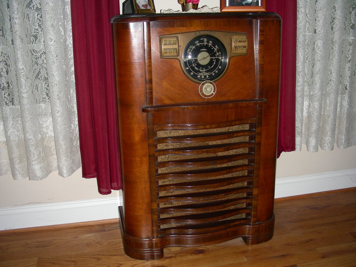

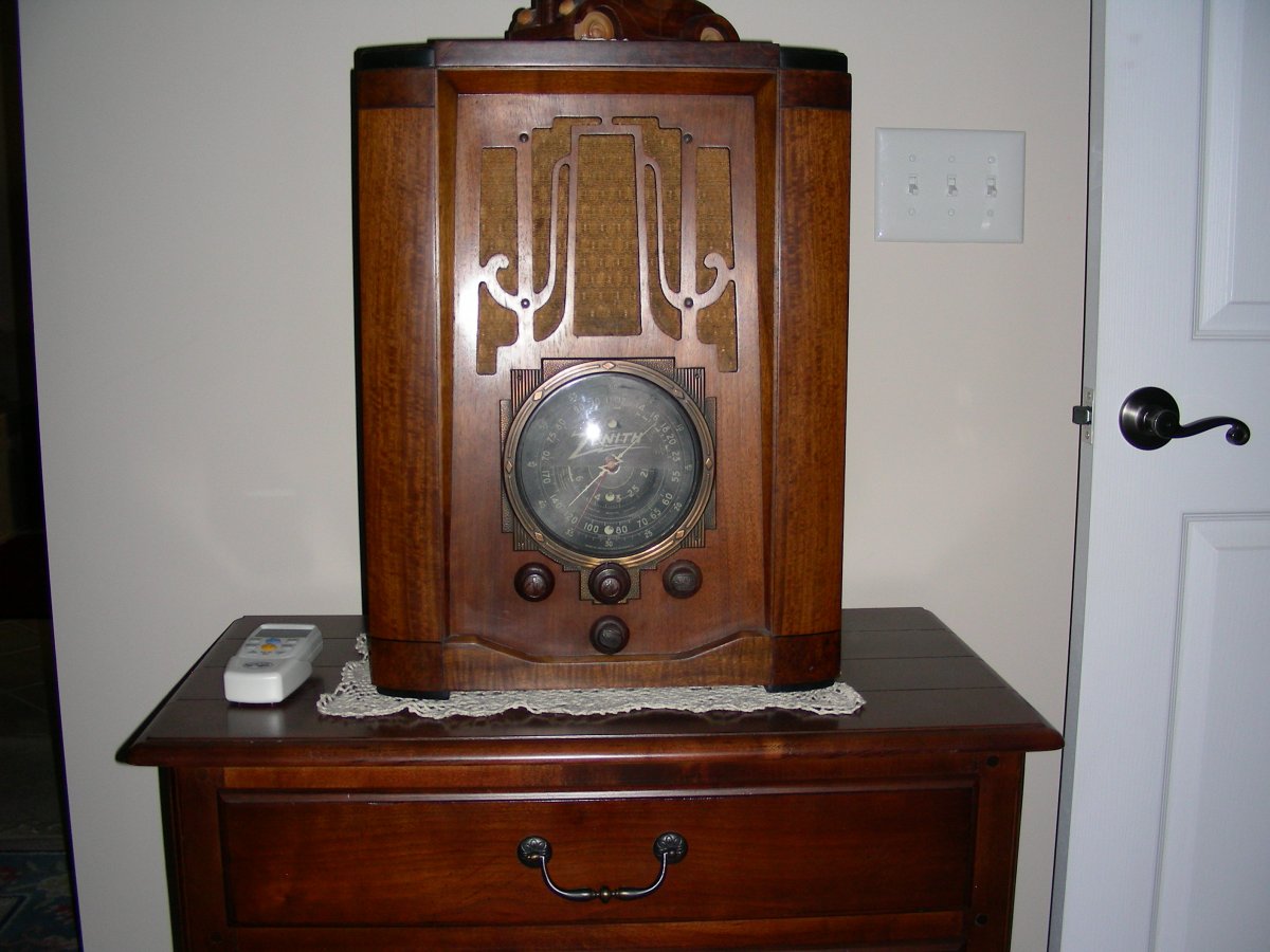

    My Zenith long distance console radio,

    That console has a green tuning eye. Always thought those were cool. Tuning eyes don't last very long in use, and some have gotten spendy.

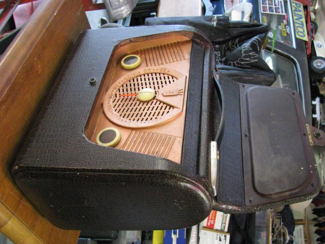

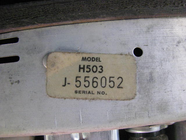

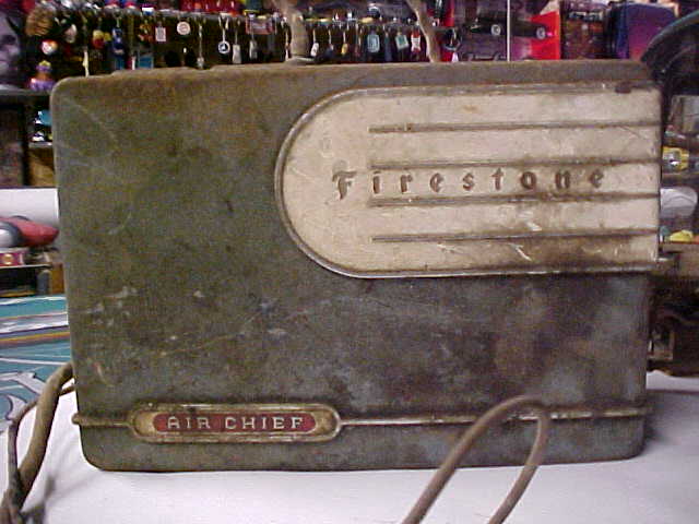

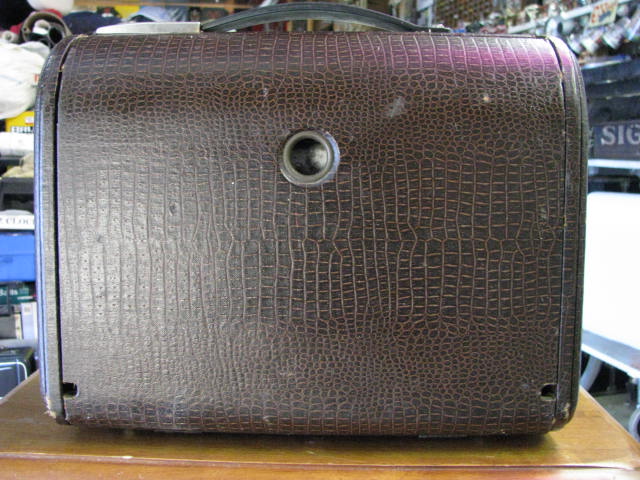

  19. Here is an old Zenith and an old Firestone car radio in pretty much relic condition. The Zenith works for about 30 minutes and then dies. ZenithRadio 001.jpg ZenithRadio 002.jpg ZenithRadio 003.jpg ZenithRadio 004.jpg ZenithRadio 005.jpg ZenithRadio 006.jpg ZenithRadio 007.jpg FirestoneAirChief1.JPG FirestoneAirChief2.JPG FirestoneAirChief3.JPG FirestoneAirChief4.JPG

    That Zenith portable used a selenium rectifier if I remember right, prone to problems by now. A 1N4007 diode should get you back in business.
    In higher current versions like used in TVs, everybody knew when a selenium rectifier failed, they would stink up the whole house pretty bad.

  26. Thank you for the info;I'll check it out. When it's playing it has a pretty decent sound for a portable.There was a battery that went into it at one time but it was missing when I got it.Found it when I was,"sidewalk treasure hunting " once.

    I think that one uses the 1L6 pentagrid converter tube, these were a high speed miniature tube at the time. It's easy to blow battery tubes messing around with line voltage. They had only a nominal 1.4 volt DC filament.
