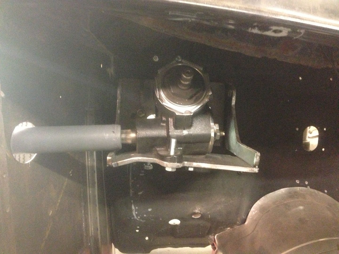

    some of the work i have been doing on this car lately has been not photo worthy, lots of welding and grinding on the floor pans, and sub rails. but i started working on the steering box a little today. it is a reversed corvair box, i am going to run it as cowl steering. so i have to make an extension to get the pitman arm to the out side of the body,and make the pitman arm.
    here is the draft of the plan
    all the pieces machined, after a few hours turning handles lol
    close up of the pitman arm i made
    the mess i made
    everything bolted up on the work table, there will be carrier bearing installed when the assembly is installed in the car

    Is the extension splined?

    yea it is splined and the extension is hollow so when the pitman arm is removed you can use the stock nut and lock washer to hold it to the box

    i have had a few questions on how the steering out put shaft extension is held on so i snapped a few pics of it today, you can see the one end is splined to fit the splines on the box, and the other end is hollow so you can use a socket and extension to install the nut and lock washer to the end of the output shaft and hold it all together

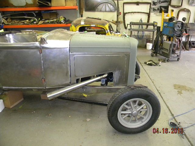

    started making the new hood sides
    it is two separate panels so it doesnt have a big hole under the headers
    think i might remake the filler panel under the header, the louvers look funny

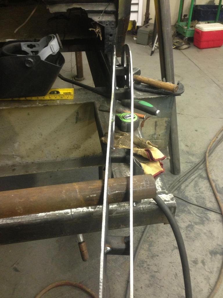

    today i feel i made one of the hardest body panels i have had to fabricate. it is the rear corner of a 51 chevy school bus. this thing took all day to get half way close, but turned out pretty good. both the reverse compound curve and the rolled bottom edge fade out to flat on the side

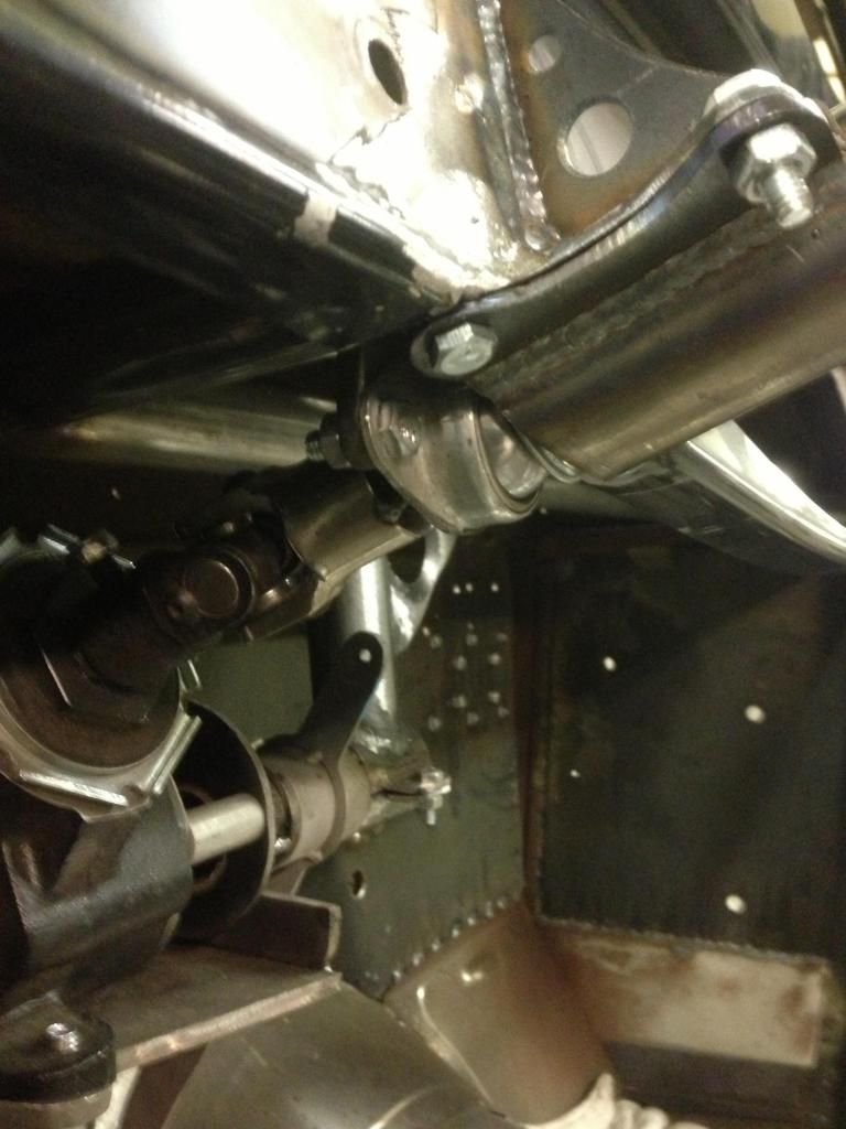

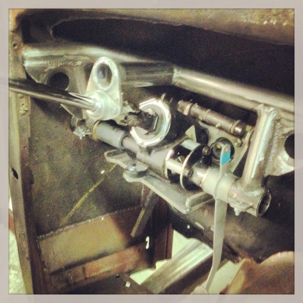

    then moved on to more work on the pedals/ steering. it is all going to be one unit under the dash. here is the pedal assembly with the steering box mocked up to it, you cant see the pedals in the first pic, i took them off to make it easier to get in and out of the car
    pitman arm on the car for the first time

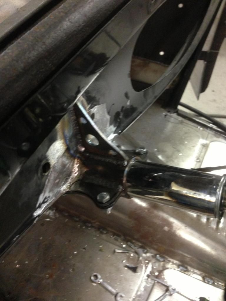

    bent up a tube that welds to the cowl/ door post, i will be attaching brackets to help support the steering/ pedal assembly
    more of the supports coming together. the collar to the right with the upright will be split in half horizontally with tabs welded to it so it can be bolted together. this way the steering box bracket can be removed if need be. the collar to the left of the clamp collar is a pivot that will be part of the gas pedal (cardboard template of the pedal can be seen)
    here is a close up shot of how the bracket attaches to the box, using the 3 bolt locations that hold the side cap/ adjuster on. using spacers and plate to attach the tube to. you can also see part of the pedals in this pic, still need to attach the brake pedal arm to the pivot

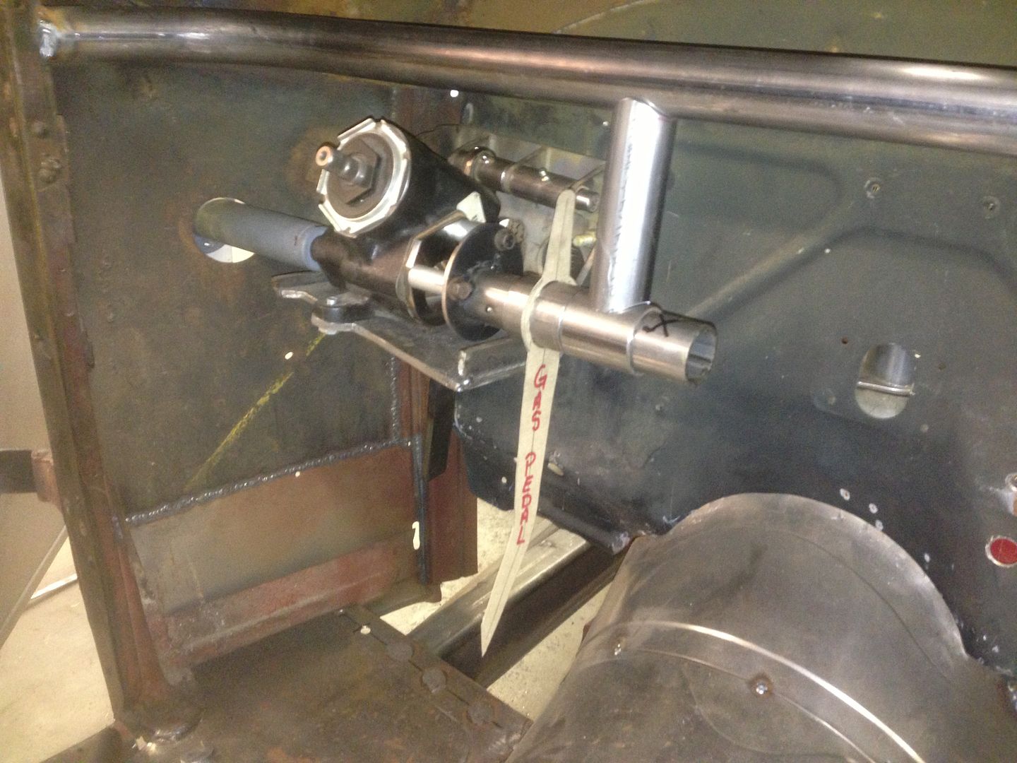

    been working on the steering a lot more, trying to get it all fabricated and working. so here it is after a ton of hours
    had to make a custom brass bushing to support the steering shaft, a huge thanks to Josh Shaw for his help on a saturday afternoon machining job
    the clamp to attach the bushing to the tube work
    starting to look like something
    made some brackets to support the steering shaft from the wheel
    then had to make a steering column clamp to support the column and steering wheel
    and the finished product, just need to finish up the pedals

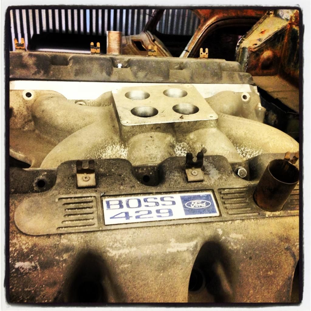

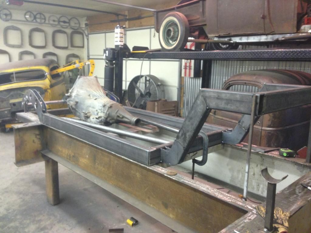

    so this week i have been working on 38 ford truck, kinda an O/T type build, but i thought many of you would like the fabrication and especially the engine

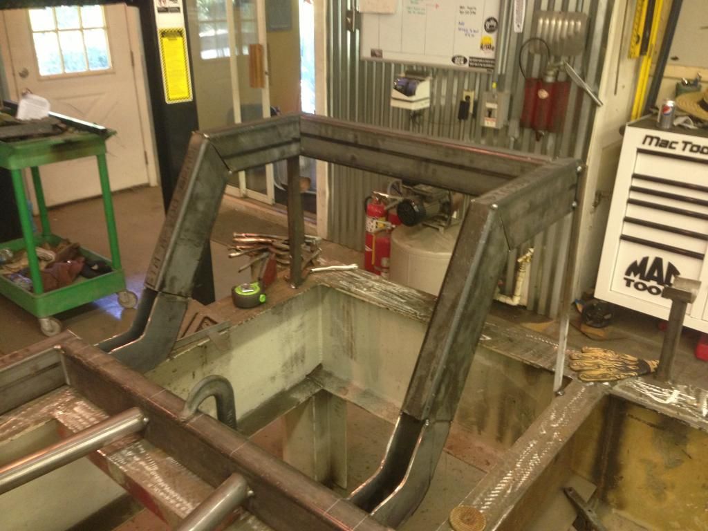

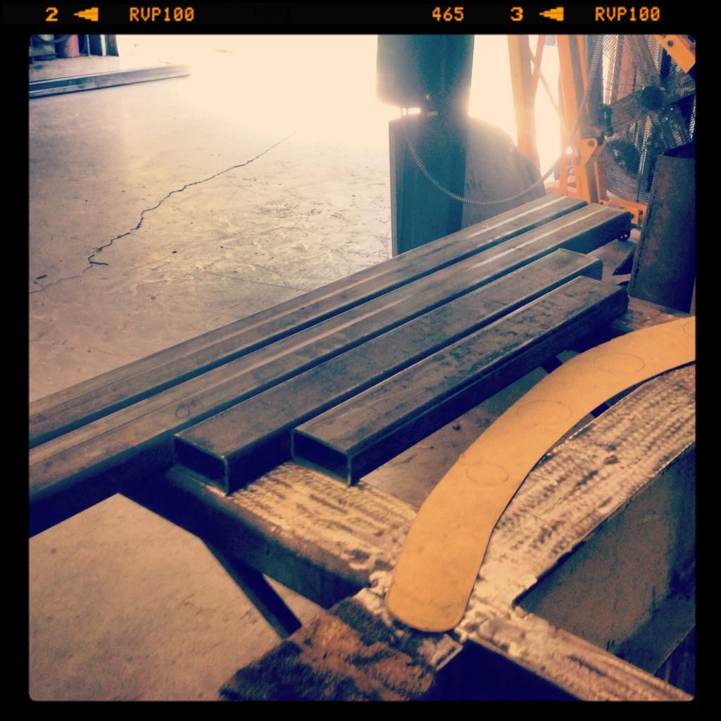

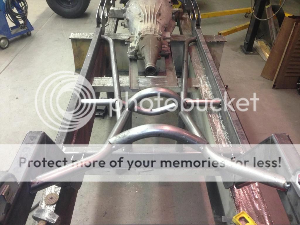

    started cutting the 2x4x3/16 wall tube

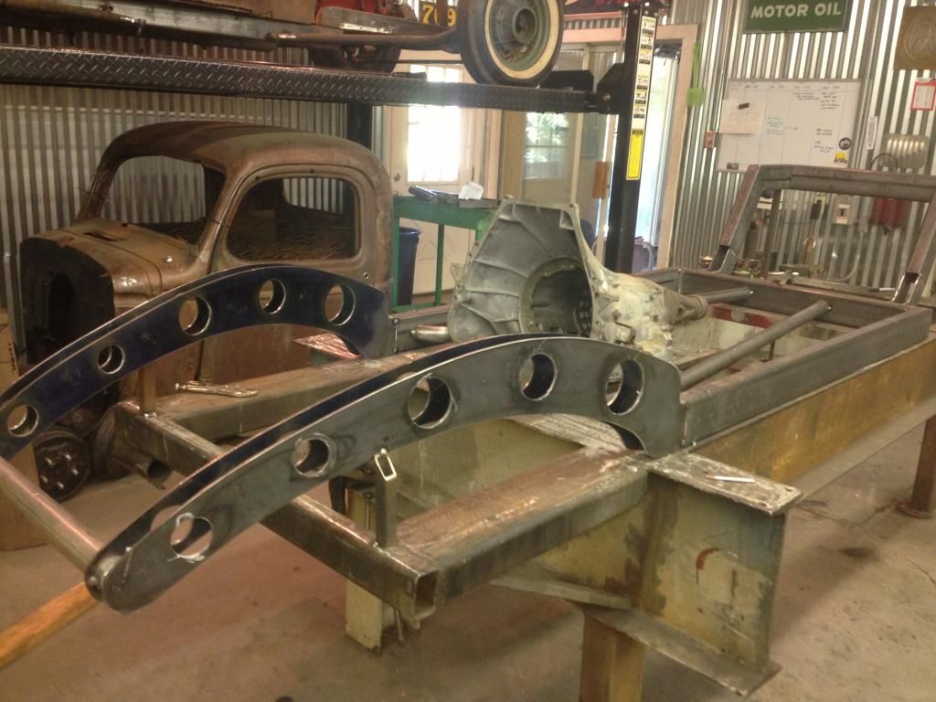

    made some wood patterns to plasma cut out the flat plate sections for the rear of the chassis
    got a lot of the chassis tacked up on the driver side, used a template for the front of the frame that the owner provided

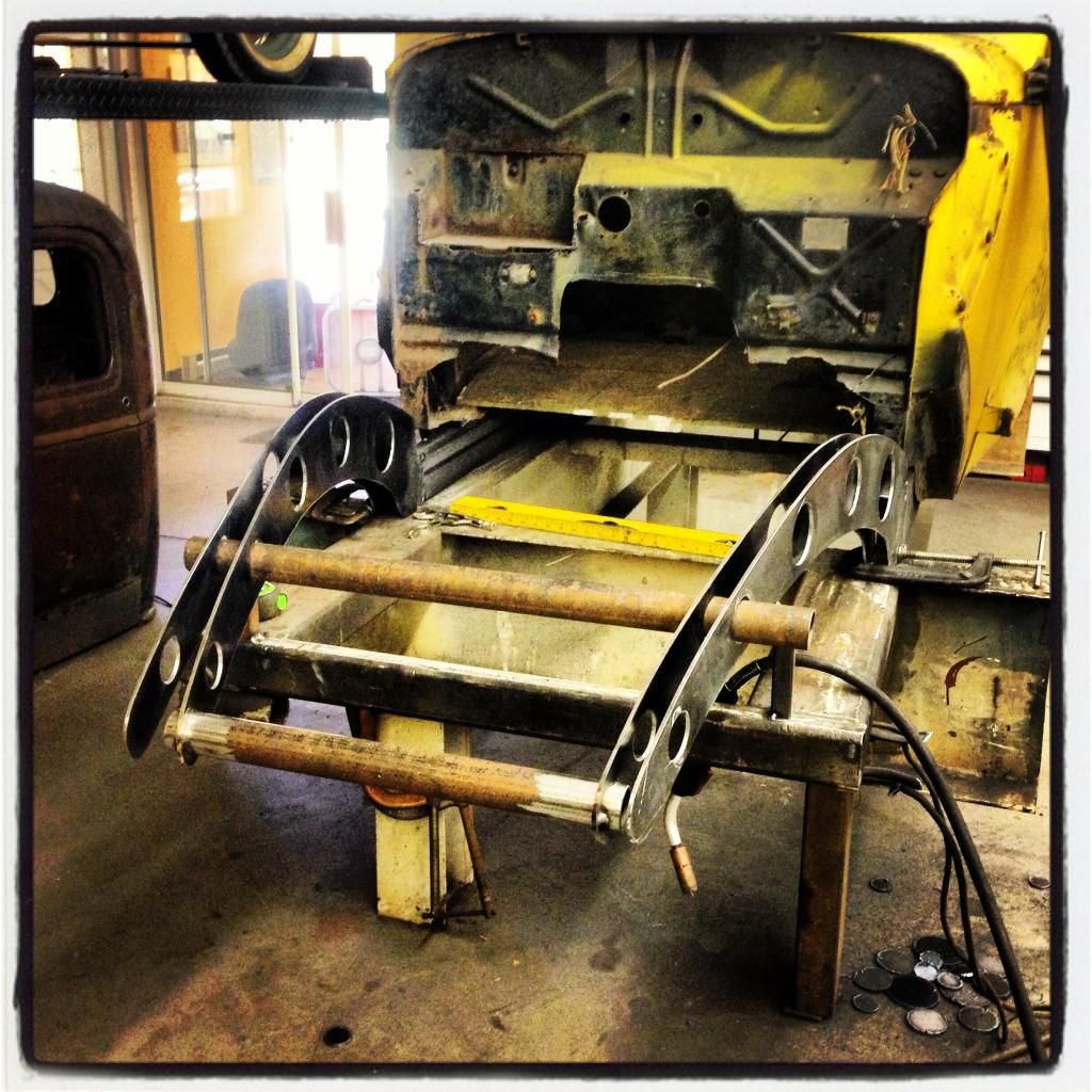

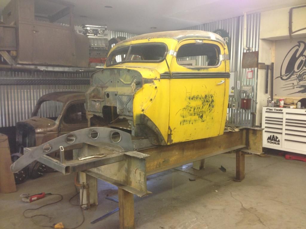

    then moved on to setting the cab on the chassis so far to make sure it has the look that the owner wants
    rear of the chassis is going to be pinched in for the wide meats out back

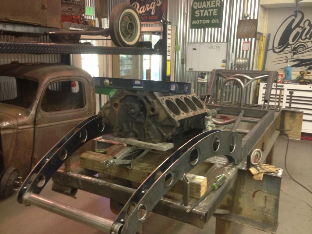

    then set the block up in the car to see how it was going to lay
    then tossed on the hood and grill shell to do some more looking
    cut some 1x1 tube to use as spacers on the front frame rails, using the mill to make sure they are all the same
    welding in all the spacers

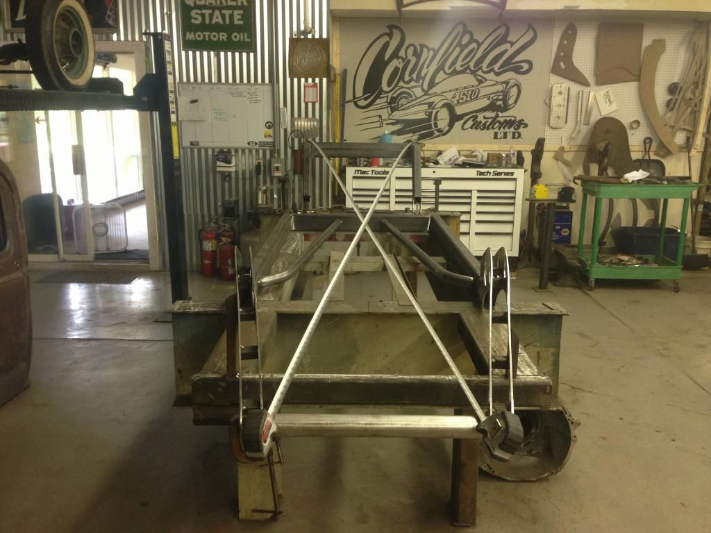

    the front rails all tacked up and squared up, took the cab back off to do some tube work under the cab and finish up the perimeter frame
    here is a front shot to show how the front rails are bowed
    first thing this morning i double checked the frame for square before i moved to more tube work and setting the engine and trans

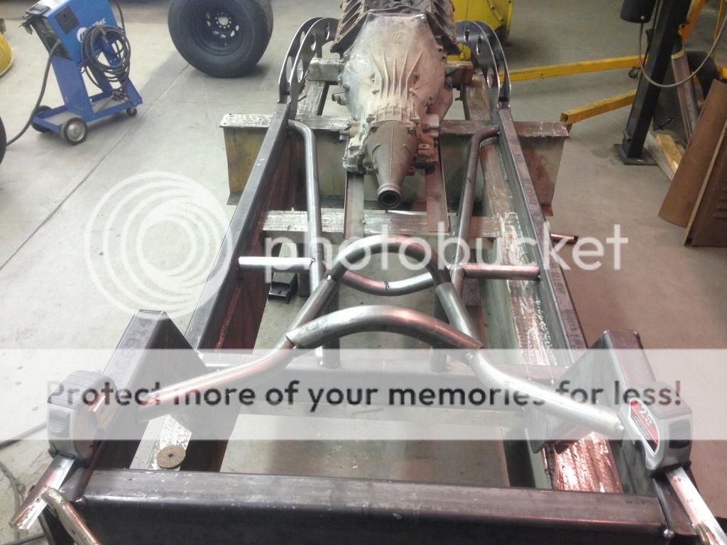

    motor and trans set up, centered and leveled out
    /albums/r689/cornfield_customs/photo8_zps2d533971.jpg[/IMG][/URL]
    and some tube work on the center section, and rear of the chassis, more to come
    started making the motor mounts today
    cut out the plates that bolt to the engine
    then cut and bent the frame side mount
    used some cardboard to fill in the gap
    plate cut and drilled, still need to plate the top and bottom to make it an i beam
    driver side
    passenger side
