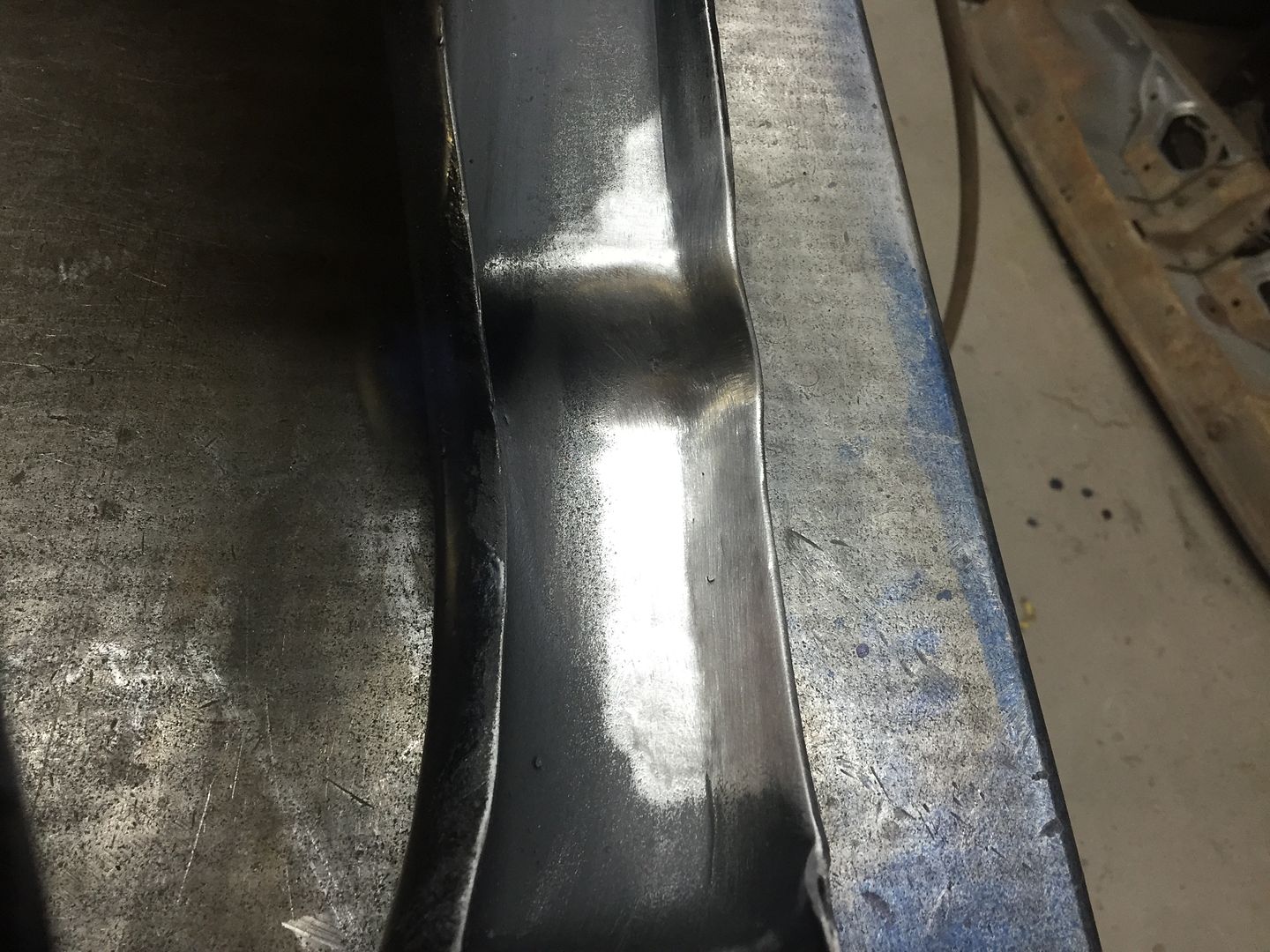

    been super busy the last few weeks fixing a model a coupe body, i will post pics of it when its done.
    anyways, i had to make some new door skins for some 32 ford sedan doors for Bobby Hilton.
    used the English wheel to put all the shape, then switched over to the power hammer to put the half of the belt line in.
    here is the door i started with
    here is test fitting the over sized skin on the door
    before i could wrap the edges i had to make new bottoms for the doors. these were not as much fun or interesting to look at compared to the skins. took about 30 mins to make the new bottom and a while longer to trim and fit them into the doors
    tacked in place
    all welded in
    so with the door frame finished up it was time to finish the skin up. so i marked the door frame on the back of the skin, added .375 around that for the hemmed edge. trimmed everything up, then used a hammer and dolly to turn the flange up. then continued hammer and dolly work to set the hem on the frame. all that was left was to cut the weld seam in the center of the belt line. cut the seam, tig welded it up, ran over it with the hammer and dolly once and sanded down the weld. didnt really do much on metal finishing the weld seam, due to time and bobby wanted to finish them off.
    here is the finished product of the first door. like i said no metal finishing was done so they are not 100%
    jakespeed63, Stogy, AHotRod and 6 others like this.

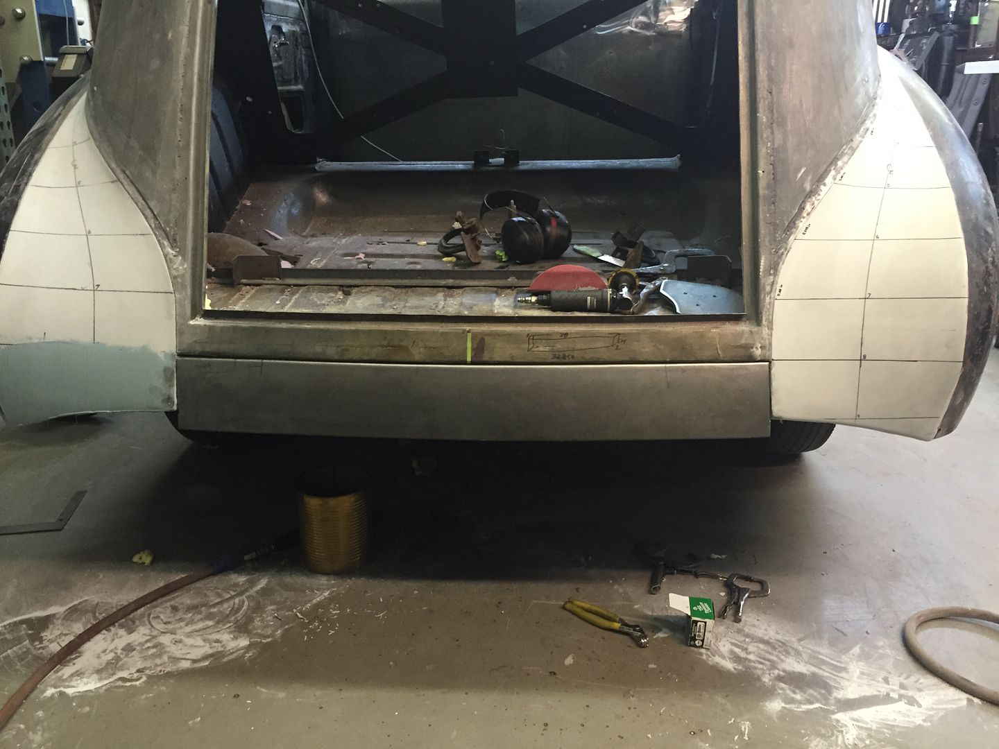

    finally have time to make a post. a lot of stuff has been going on in the shop and moving forward on projects. a lot has been done on the Wyke 32 sedan, i hop to update that thread this week. but here is some progress on the sheet metal work on the darrin town car i have been working on
    we had to make some filler panels to tie in the fenders into the body. there was nothing there to pattern, so i made some bucks out of foam, then covered them in a coat of body filler.
    after i got the one side shaped how i liked it, i patterned it to make the match for the other side
    then came time to paper pattern the buck and transfer that into steel
    i didnt film or take any pics of the shaping process, but it was all done on the power hammer with a linear stretching die set to get the reverse
    and then there were 2
    i had to just get the panels shaped, the customer is planning on finishing them himself
    also had to make a roll pan. it looks fairly simple but was a little more complicated than it looks.
    also had to make a new package tray, set the hinges up, and finish the inner deck lid frame. i had my employee Ryan get those finished up
    in this pic you can see that the inner deck lid has been finished. the blocks in the top corners is .375 thick steel plate that is riveted to the inner lid. it was drilled and tapped to give a solid mount for the lid hinges
    i still have to make the outer skin on the lid, but that might be down the road some
