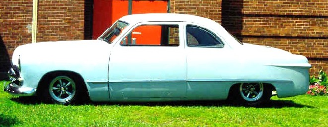

  3. I used a maverick 8" axle under my 49 ford. Worked fine and I lowered the car a lot...had to do some driveshaft tunnel work but I wouldn't have if I hadn't lowered the rear about 5 inches.
    8" ford axles have a good choice of gears and several posi units also. Mine came with 3.00 gears for a good all-around compromise in gearing.
