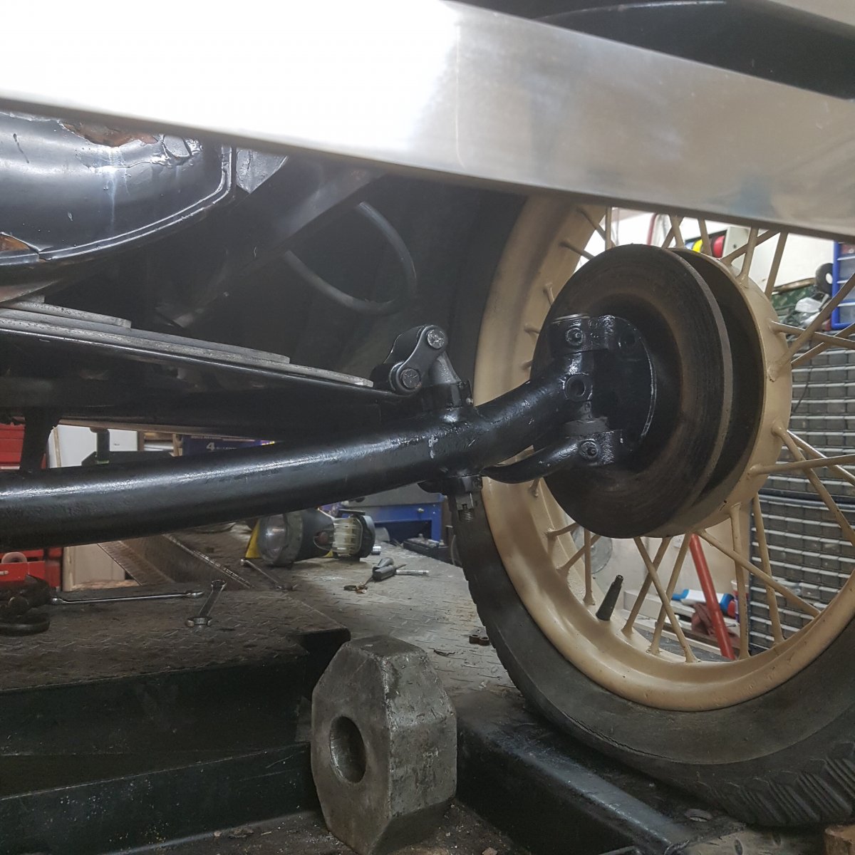

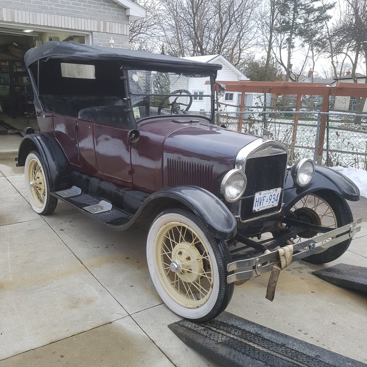

  1. Fixing a few problems with my 27 T touring.
    Moving on to the brakes now .Car has 78 chevette calipers a volvo rotors , 42-48 rear brakes and a 40 s master cylinder , firewall mounted .
    Shoulds I run residual valves ?
    Proportioning valve ?
    My father put this stuff on the car in the late 70s early 80s and I am going to leave it this way .It is a v8 60hp

    My concern here is that the 1940's master, being a drum brake, single circuit master cylinder, it probably does not deliver enough volume to properly actuate the front calipers, and thus you are likely effectively running on rear brakes, only.
  7. Would a 1946 ford master have a risidual valve ? Original car would be 4 wheel drum .
  8. Calipers are quite small , single piston , maybe 1 3/4 - 2 inch piston .
    Hnstray likes this.
  9. gimpyshotrods
    Joined: May 20, 2009
    Posts: 23,331
    gimpyshotrods
    If I remember correctly, the bore of a 1948 master cylinder (that goes with the rear brakes) is 1-1/16".
    The master cylinder bore for a 1978 Chevette is 3/4".
    Those two numbers are not even close.
  10. gimpyshotrods
    Posts: 23,331
    gimpyshotrods
    They are 1-7/8".
    I appreciate your desire to leave this as-built, but it is not likely to work particularly well.

    Your current master cylinder is right in-between what GM typically uses for around 3" (2.94) pistons, for manual brakes (1") and power assist (1-1/8").
    Your caliper pistons are 1-7/8".
    We already know that the bore of the master cylinder (sets the pressure) is okay for the rear brakes, as it is matched to the type of brakes. That leaves the calipers as the variable (master cylinder volume aside)
    Short of bumping the caliper bore to better match the master cylinder bore, I am not sure what to do here.
    Changing he master cylinder bore will make it incorrect for the rear brakes. If you dropped the master cylinder bore to 3/4", to match the front calipers, you'd be facing backwards at the first hard stop.
    Do you know what year the Volvo rotors are, or how thick they are?
    I would swap the master cylinder for a dual circuit one, that is set up for disc drum, with the same bore. Then, I would change the calipers to GM "metric" ones (with new brackets), possibly with pad spacers, to fit the Volvo discs.
    That way, all of the bores/pistons/cylinders are fairly matched. From there, you can assess of you need a proportioning valve.
    57 Fargo likes this.

  29. Kerrynzl
    Joined: Jun 20, 2010
    Posts: 2,964
    Kerrynzl
    We're not needed here.........You are doing fine on your own [​IMG]
    To the OP ...
    A stock standard Chevette would "out brake" your T [so if you set that as a safety benchmark it would be a step in the right direction.
    It scares me the thought of Single M/C's but I have a 57 Chevy that is the same.
    Just make sure ALL your hoses and hard-lines are better than good condition if you stay with the single M/C
    With a firewall mounted M/C you don't need a residual valve for the callipers [only the drums need them]
    Now to get the rear proportioned to the existing front callipers, You would need 9" Drums and 3/4" wheel cylinders [ your existing rears are 12" drums and 1-1/8" wheel cylinders]
    So you would need to change the M/C to 7/8" and the rear drums and backing plates, which ends up totally re-engineering your car.
    You have basically given yourself the correct solution! Change the front brakes to compatible Ford brakes [12" drums and 1-3/8" Wheel cylinders]
    It will out perform the skinny tyres you have ,and still look period correct.
    Cool car by the way!
    egads and gimpyshotrods like this.
