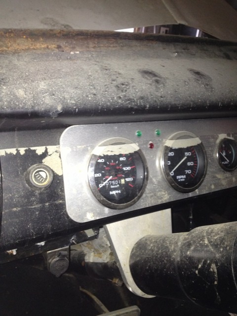

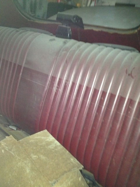

    ImageUploadedByTJJ1352652913.865598.jpg ImageUploadedByTJJ1352652956.534062.jpg
    Just had the chance to see my car after Sandy. As you can see there was a little water damage. I pulled 3 gallons of water out of the motor, pulled the plugs, turned the motor over to get the rest of the water out put a new filer on and oil in. We almost got it started but we ran out of light.
    Is there anything else I should be doing any help would be great

  4. Don't forget the trans and rear axle...they'll both be full of water as the water-line on your car's seat shows.
    The front wheel bearings have seals but I wouldn't trust them, especially to salt water. I'd check them for water too. Hit the driveshafts
    U-joints with a grease gun to force out water/force in lube.
    If that was salt water, sit a lawn sprinkler under that car for a few days if the weather is above freezing now. And as long as there was already water inside that car, I'd go ahead and take the garden hose to the entire inside of the car...what do you have to loose at this point? Hose that baby out.

    Hopefully your gauges, stereo, etc. will be ok. Electronics don't usually suffer water. As to the upholstery, well......

  8. A good idea for the interior is use a couple of box fans on high and the window rolled down. HRP

    Do as the others have said. Also pull off the brake drums. There will be a lot of dirt in there. Check out the radiator. If you had running water thru your garage it will be full of mud and weeds in the fins.

    I have some experience with flood cars, both "low water" cars (floor boards) and deeper submerged vehicles. The most critical element is time. The faster you get everything opened up, cleaned up and dryed, the better your results will be. So called "fresh water" is bad enough, it has dirt, sand/silt in it but if it WAS saltwater, DOUBLE the emphasis on timely disassembly and cleaning.
    As for the upholstery, if you keep it in place, fans, dessicants etc. are a waste of time. STRIP the entire interior of any component that was wet and dry it in the sun if possible or in doors with lots of air circulation if need be. Don't be surprised though, if the interior is smelly and is toast.
    Wiring can be saved if ALL the connectors are opened, cleaned thoroughly and dryed. Reassembly with dielectric grease or, at a minimum, WD40.
    You can try salvaging the guages, radio, etc, but like the upholstery, don't be surprised if they too, are shot.
    A deep flood car CAN be saved, but it is a LOT of work to do it right. The body and major mechanical parts are the easy part. It's the electric and soft trim that is so vulnerable.

  20. Not so much the whole car,but EVERYTHING electrical! time to re-guage and re-wire.
