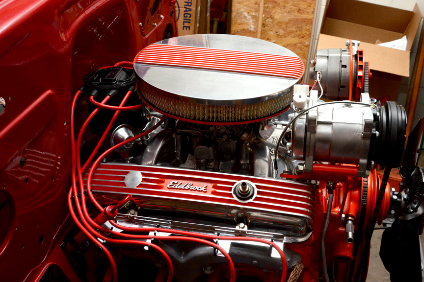

  1. Yes, it needs two places on the engine to ventilate it. right now it's like a furnace with no cold air returns.

    I wasn't blaming the pan. I would like to use it. I like the looks of it plus I don't have a stock pan. Oil comes from three of the bolts and runs down the side of the pan on the drivers side at a pretty good rate. Those holes do not go thru to the inside of the engine. How does it get there? I'm almost positive it is not coming from the front seal as mentioned in a previous post.

    If ventilation is an issue I can put the grommet in the valve cover with a pcv valve but where does it hook on the intake or carb. It has a tunnel ram and two Holley 450's.

    Well, I found the problem. I finally got time to work on it today and upon cleaning up the aluminum oil pan I found several cracks along the mounting rail right were the leaks were. Brand new JUNK! Now I have to scrounge up a stock pan like the one I took off and gave away.
