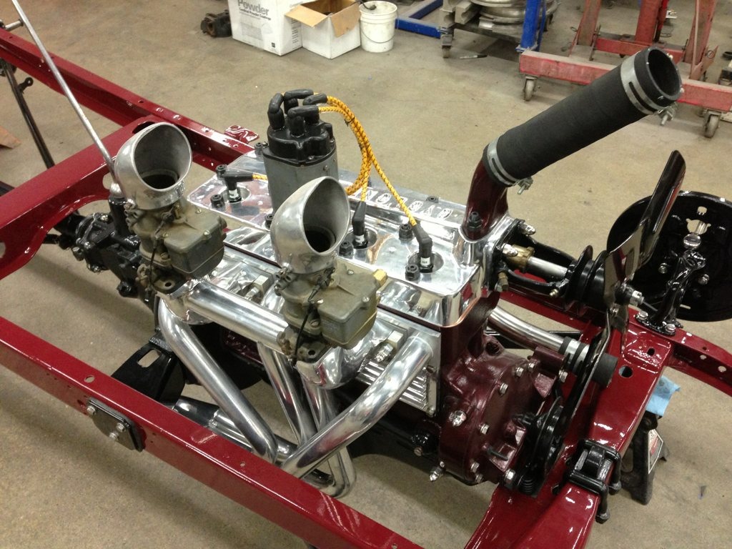

  3. Very Nice, what's the specs on the banger?

    How do you like the exhaust note? Thinking about a similar setup.

    Cyclone head, no name 2x2 intake, 97s, stainless valves, flat top pistons, modified oil system, max sr. Header, wico magneto, sealed pump, mild cam, ImageUploadedByH.A.M.B.1369970017.906016.jpg I have a 39 Trans with lightened flywheel that I am swapping in next week

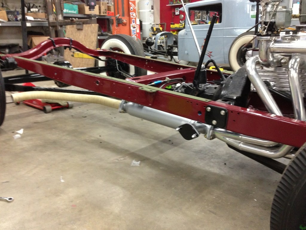

    It sounds mello till wound up a bit... A split dual has a little more sound but i like the clean lines of one pipe and I have a cut out... ImageUploadedByH.A.M.B.1369970147.705945.jpg

    What width is the front axle? looking to do a similar build.

    Stock model a axle drilled and dropped 3 inches... Narrowed it about 3/4 each side...
