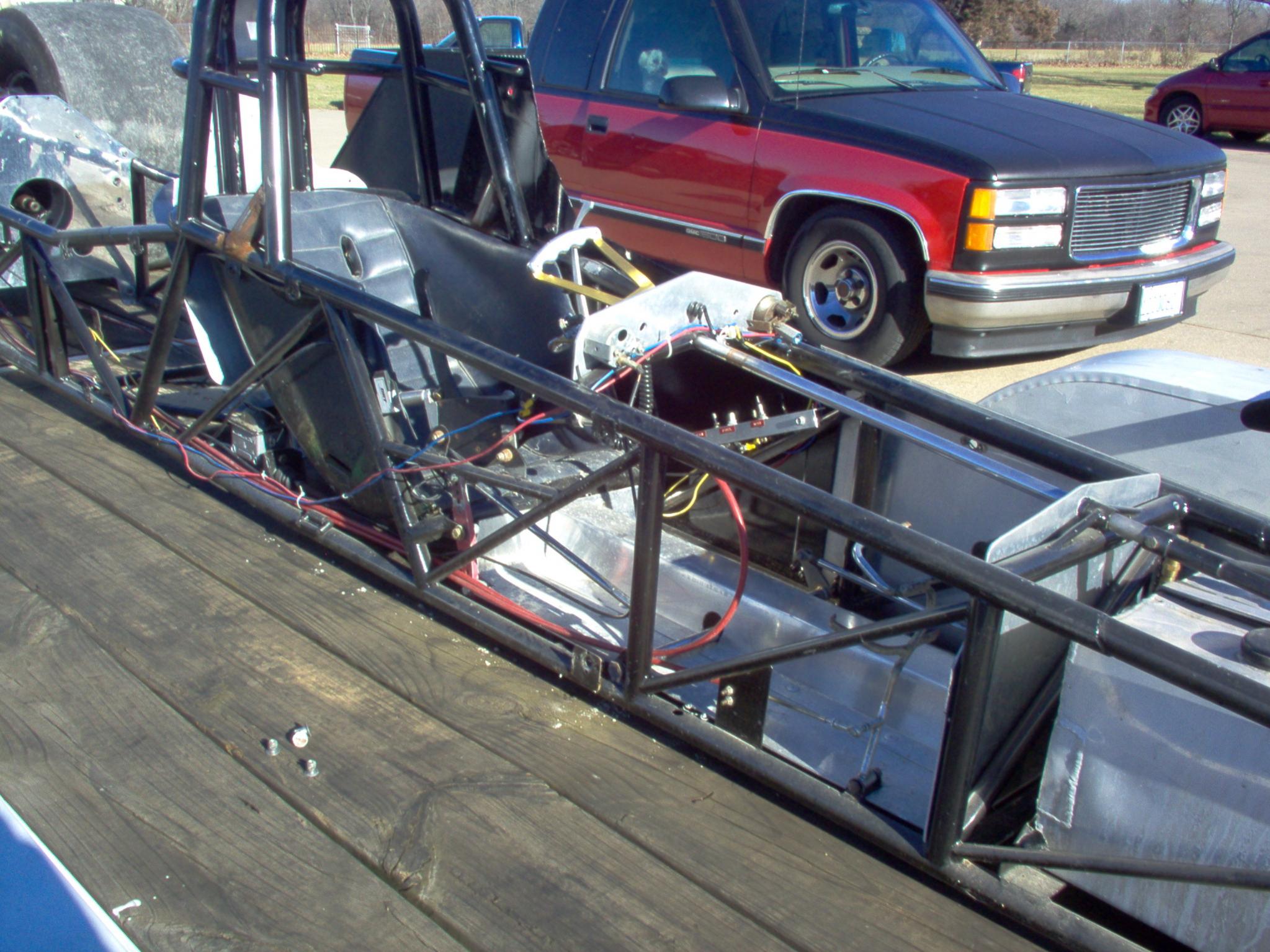

    At this point, pictures are all that is needed. The only reason for me to have the car itself would be for tube sizing and sonic. From the pics we see that there is no shoulder hoop as described by the specs nor any uprights and diaganls within the drivers area and the front rollbar hoop is straight up and it is bent and unsuported where it is welded to the upper bar. The front and rear section is of no matter to me because that part is not involved during the certifecation process, although the rear section is of poor design if the builder considered it finnished. So taking that into account whereas one needs to repalce 90% of the tubing from the front firewall to the back, why put in the time or money to do so, and for that sake a couple hundred dollars more to finnish up the front frame section.
    Don, without seeing the rear end housing or the front axle assy and by not knowing what he paid for it , there is nothing left on that car with any true value, The steering wheel? $10-maybe, MQQN peddle? can by a new one for $38 (hyd are prob shot anyway), would you use a 2+year old m/c thats been left out in the open, and the steering box is some iron automotive type and not a P&S. So for you, what would be the right price?

    Because on this site,some people are of the belief that If they own/build something that it gives them the right to do anything they want with it, which includes being able to race it anywhere.

    "Have you ever looked at some of Garlits early chassis?"
    That was almost 60 years ago.
    Racing is inherently dangerous, but why not build the safest chassis that you can? Just a question.

    Maybe the car was being built as a sand dragster; it's probably been bounced around through several people, who all did their "thing" with it, and now it's yours. Am I wrong, or is the front end set up for a transverse spring? In the late 80's, shortly after the Econo-Dragster concept caught on, I bought a RED, that had been a FED originally. Whoever had done the work was'nt a chassis maker by any stretch of the imagination, and I put it back to it's original FED configuration (and no, I'm not a chassis maker either). This was also at the time when NHRA started going "overboard" with rules. Every week had a new set of rules; restraints having a 2 year outdate, requiring an SFI flexplate AND an SFI flexplate shield (?), multi-layer fire suits for different classes (fire's fire, right?), and on-and-on. It's why I finally quit drag racing, shortly after finishing my RED, Super Comp Dragster. IF you have an outlaw track to run it at, build it; if not, it's yard/garage art. I think you'll find, with drop link style steering, the steering will be too "quick" for a RED (Garlits did also). Stick a flathead V-8, or a GMC six in it, and have a little fun. I still have my 3 layer fire suit, but no use for it any longer; it does'nt even fit now. Butch/56sedandelivery.

    good thing thats not either. spin on filter, and side mounts.

    1) Any idea how the rear portion was formed?
    2)
    i would have to disagree with this philosophy for the following reasons:
    a) Any car operated in any situation---even on the street poses some level of risk. Why take on necessary and avoidable risk? There was a time when no fire suits, breather masks/respirators were used. Should we go back to that to prove how brave we are?
    i don't think Darell Gwynn with that philosophy either.
    Yes, you are more of a man than i am. There is no dispute there. But i can still move under my own power. Why is this?
    3) Actually, the car could raced all day at slower than 10.99 (or whatever the certification cut off is) at a sanctioned track. Or quicker at an independent track.
    i personally would not attempt to drive it until thoroughly checked out and gone through.
    Perhaps the best thing at this point is to have it go through nhra tech. Then see/understand---thru the tech sheet, exactly what needs to be changed/added to pass certification.

    any dragster must meet the minimum specs as outlined in either the rulebook or spec. sheet regardless of ET, It is required that they must be inspected and tagged (every 3 years) if they go quicker than 10.99.
    Otherwise one could build an 11.01 car out of conduit and braze it together

    I hate to jump in as one of my first post being here. But for real if you were to roll into an NHRA sanctioned track. Even if you were planning on running 18 second passes, they would tell you to load up and go home. I am sorry but that car is really not worth scrap metal. Ive been running pro comp 7.90 dragsters and super comps for many years and I do know what I am talking about. Not to mention the bar behind the head with the dimple drilled holes, are equivilent to what comes on swing sets and BBQ grills. Also from what I can see there has NEVER been a rear end and or a motor mounted on that chassis, wheres the mounting tabs for either of those components.?

    Ya'll are crazy getting all worked up about this. This guy just posted his snag he didn't say he was headed to the track. That said... I am pretty sure this was built/re-built for sand drags..>>>>^^^^^ it has a damn radiator!!! I'd like to see the other parts and under the skin, please...... jez now that we have judge jury and executionererered this guy. I'll probably never have my old parts hoarder what did he get that I didn't itch scratched on this one.

    You don't want to try and race that car, That's a backyard home made chassis, not even a kit car.
    I can tell by looking it's not built safe
    Who knows how thick the chassis is besides it's most likely rusting from the inside out.
    Man there are way too many Rear engine dragsters for sale cheap that you can buy for less money than it would take to complete that thing.
    I have Clayton Harris's ex Top Fuel car complete roller for $3500 and it has a complete mag Dana, chrome front end, rear wing, and it's been updated with a new cage and modern body.

    I wouldn't scrap it, I'd put it together with a mocked up dummy motor, some old wheels and tires and paint it up and sell it to an automotive shop or Drag Strip or even a Sports Bar to be used as a sign.
    Widner Automotive in Colorado Springs used to have an old rear engine car as a sign on top of their building that was real cool looking.
    I would say someone had good intentions when the started building the car... Before 1988 NHRA didn't require sportsman chassis to be certified.
    You could go out and buy just about any old car and race it as long as the safety equipment passed tech... NHRA didn't even require dated seat belts before 87.
    I'd almost bet when someone was building that chassis years ago the certification rule came along and knowing they didn't build it to specs they gave up on it.
