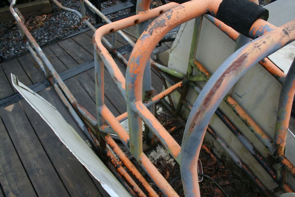

    So a few days after Christmas I was cruising through CL and saw that a "vintage" dragster chassis had just poped up for sale and decided it was worth checking out. So long story short I wind up buying this thing and am currently trying to find some history/knowledge on it. Guy claimed it to be a front engine dragster that was converted to a rear engine that was never completed some time ago, but I find that hard to believe. I do not see any evidence of motor or trans mount in either configuration of the build. However the chassis does have a steering box, butterfly wheel, wilwood master/pedal assembly, moon hydrolic gas pedal and miscilanious brackets up front for what looks to be a moon tank. Along with the chassis I got a bitchin old chrome front end with wire wheels and a narrowed and chromed ford 9 inch. I am mainly looking for any identification of this chassis, year make class anything like that and if it has the ability to every be raced again.

    Looks homemade and the square body looks to be a later deal.

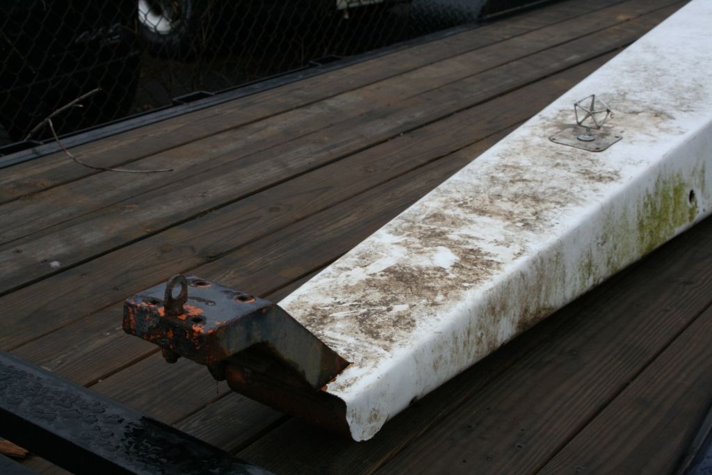

  4. Judging from the sheetmatal work it is just a backyard or home grown job. If there is no marking on it is any kind and especially of you don't find a certification tag on it anywhere it is probably just that a project for someone who thought they wanted one and eithet ran out of steam or money.

  6. Almost anything can be raced, it simply depends on how fast you want to go with it. I echo the issues identified previously. I would be concerned about rust on / in the tubes as well as the design. I see no K/X support on the side rails and if you want to go reasonably fast then you will definitely need to add bars to the chassis.

    I think the components you scored could be reused but not the frame. Not only have the rules changed a lot in recent years but the frame has not lived a sheltered life, from the looks of it. Personally, I would be afraid to use it.
    But the front end, rear end, steering, and a few other parts are probably worth what you paid, so it wouldn't be a complete loss.

    X-2 The chassis appears to be mig welded (from here) and I'd say the tubing would best be used to make a welding table or something around the shop. The good news is that the chassis itself is cheaper than all the parts that go on it. One can whack together an old school chassis (chromemoly) in a couple of weeks, for not too much expense. :D

    Well after another look maybe partly welded with Mig, partly Tig but either way ready for new tubes......

    No offense, but I wouldn't strap myself into a frame that has been sitting outside for god knows how long and rusting from the inside out, even if it was only set up to run in the 12s. A frame failure at even 100 MPH is not likely to have a happy ending. Like many of the others, I agree- take off the usable components and build some new pipe.

    Use it as "WALL ART" because as what others have said, I would not trust it being put into a bind at all.. Can you say "SNAP"....... I do like it though.....as "WALL ART".

    Well, irregardless if the tubes are rusting from the inside (likely) and how the frame was put together---is it structurally sound, will it hold up in a crash?
    It probably wouldn't pass sonic testing anyways; The tubes are likely either the wrong size and/or thickness and/or missing in spots to pass nhra/ihra certification to run quicker than 10.99 e.t.
    You could completely redo the frame. OR find an independent track and race as is, but that is likely playing russian roulette safety-wise.
    Anyways, i find the rear of the frame interesting---how it narrows down. i think i know why it was done. But how was it done? Where the tubes already in place and then bent. Or were the tubes bent, then welded in using a rosette type weld?

  15. Just looking at how odd and LONG that rear section is, I'm thinking it was built as a jet car. That cute little rear wing kinda says so too. I'm pretty sure it was never an FED...none of the cage or frame tubes is set up correctly for that. Good luck getting it through tech... None of those mid rails that the cage attaches to look like the right size tubing. Pretty cool oddball find though.

    How was the rear part of the frame done?

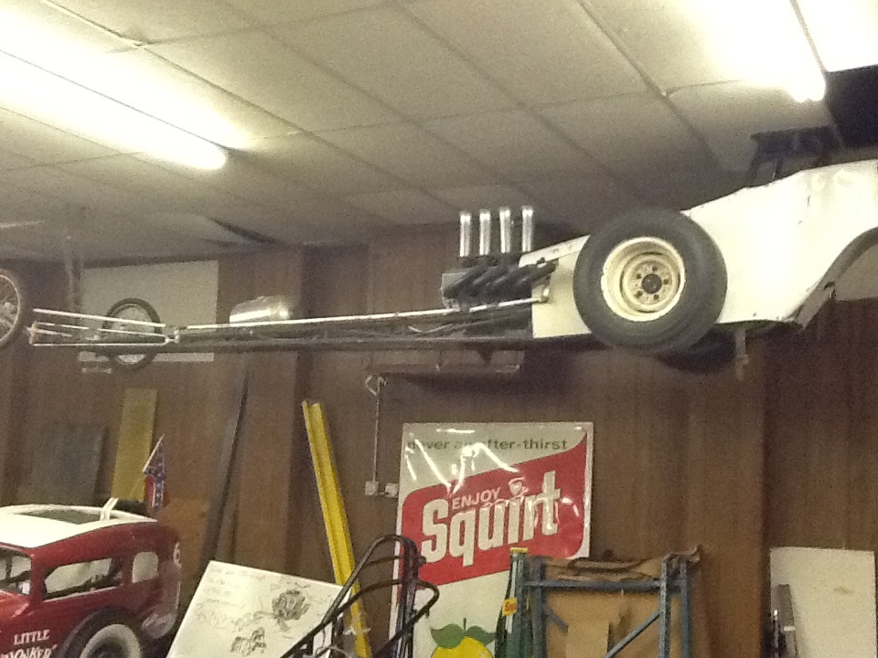

    it really doesnt look safe at all. Put it on the roof of your garage mocked up! :p

    I have been doing this stuff for 30 years and you need a dose of reality so dont get mad at me, get mad at yourself for buying it without knowing what you are looking at,Get mad at others also without clue egging you on on how bitchen it is, get mad at the guy who sold it to you. Hell, I am trying to save you some money here and to treat this as one of lifes lessons.
    The frame does not conform TO ANY LEGAL STANDARDS---PERIOD
    The guy LIED to you about being coverted from a FM car
    Sitting out in the east coast weather for so long has made any part on there unusable and/or unsafe.
    SO you got a housing and a front axle (and those pieces could also be in question) unless you posess the skills needed to install them you are going to have to have the work done for you ,and I dont think any respected shop with the know how is going to even touch it.

    Bruce may be a little lacking in tact but he is correct. The frame layout on this thing does not come close to complying with any chassis standards that it would need to meet to be raceable and the back half is very suspect with those unsupported bends where it narrows down. If the front and rear axles are good build some new tubing around them but please don't waste any time on this thing.

    I like the k-car hood emblem! Cool garage art. Paint it up and hang it from the rafters!
