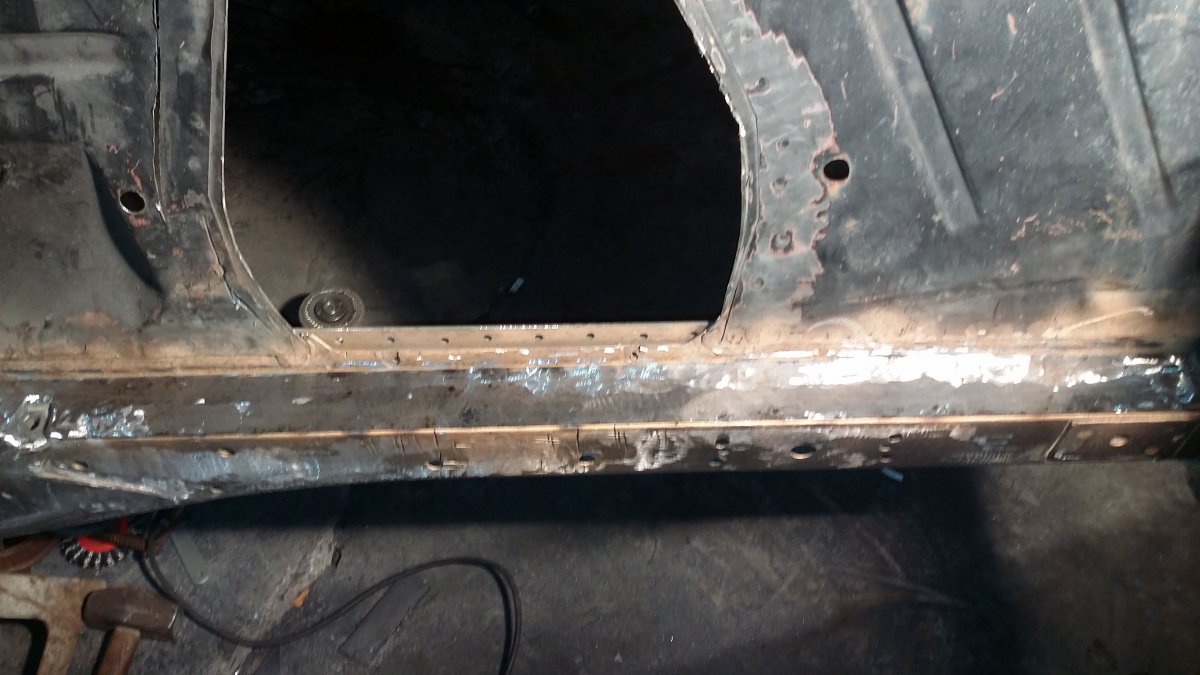

    Ok, I was just curious, thats all. Thanks for the answers. Got back out today to make a couple plates for the frame again. Got the outside done with the 4in and 10in cut out and welded together. Oh btw. Sorry about all the pics, jusT excited how good this is turning out and HOW FUN IT IS. 20170124_173722.jpg photostudio_1485287014482.jpg 20170124_201228.jpg 20170125_115810.jpg 20170125_125720.jpg 20170125_125741.jpg 20170125_161128.jpg and top done today, onto the inside tomorrow then the bottom.

    20170125_161128.jpg Can someone please tell me, out of all these factory holes on the inside of the drivers side frame, which ones I will need to keep and also, should the stock steering box be used? It worked fine when it was in but should it be used for this project meaning turning ability and strenght or go with something different? Thanks

    Which holes you might need will depend on all the parts you plan to put on the car. Do you know what engine you will use? what suspension? how you plan to run the brake lines? and wires?
    The steering box selection might also depend on what suspension you use, and what engine you choose might affect that...Ford motors mostly have the distributor in front, which means the oil pump is in front, which means it has to have clearance for the pump in front (although there are rear sump pans, which still stick down pretty far in front). The exhaust might or might not be in the way of the steering box, too. You might be able to build headers that clear the steering box, or maybe not, it depends where the exhaust ports are on the engine that you choose.
    In other words, by doing the bodywork first, you are putting the cart in front of the horse (to use a bad analogy).
    Maybe you ought to slow down on doing the stuff you know how to do, and start doing the hard part, which for you is probably figuring out the mechanicals.

    Keep all of the holes. You can weld them up later.
    Drill out your bumper bracket holes, too.
