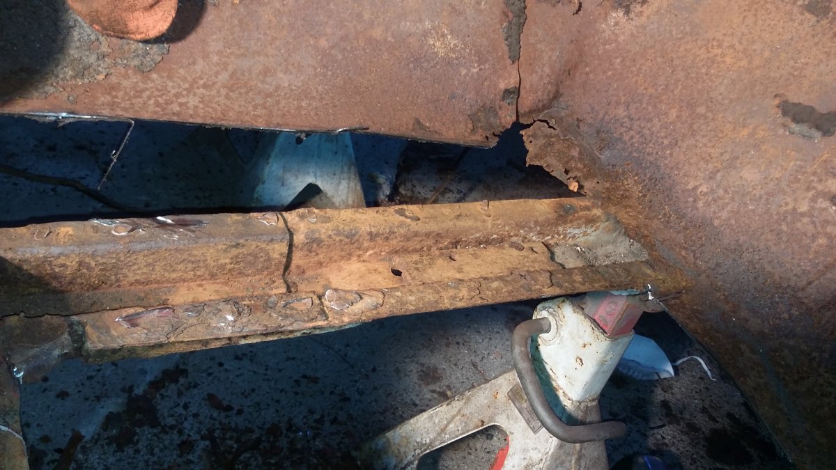

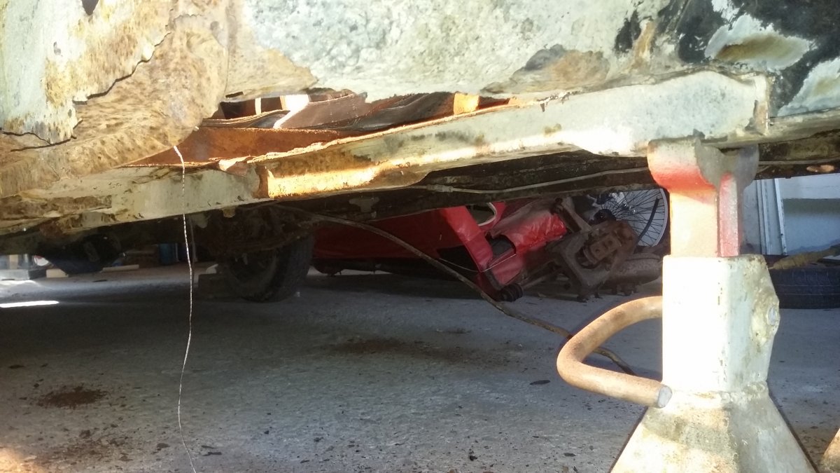

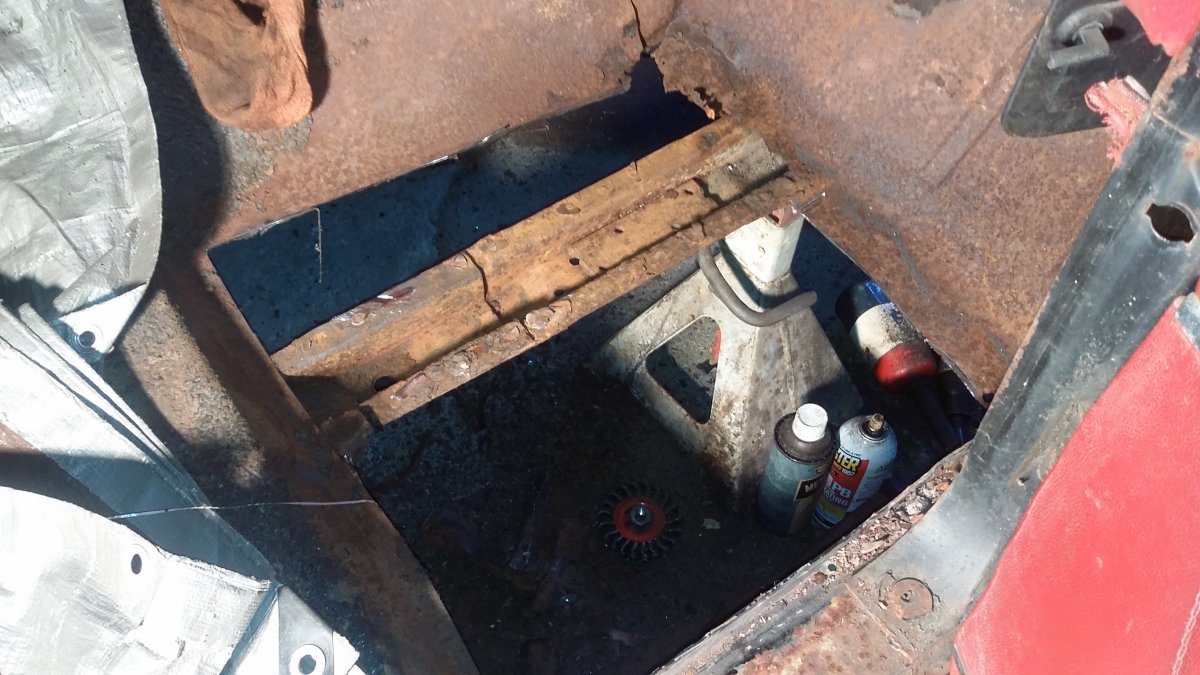

    So I did some cleaning up on the front frame section as I mentioned in another post I made about front end help. I got to the inside of the car today and decided to cut out the front passenger side floorboard, as it had a couple small holes in it anyways, and was able to get a good look at the rest of the "So called" frame under their. HAHAHA, WHAT A JOKE, im surprised that thing could even hold up a a tire and wheel. I ah planned on welding some C channel onto it with some kind of braces but after seeing it, HELL, guess im going to try and go all out and build a complete frame front to rear and Z it as well.if ANYBODY has a link or some great detailed pics with measurments and would like to share, PLEASE feel free and jump right in as I guess im going to be in for some one hell of some fabricating frame work and could use ALL the help I can get. Here are some pics of what I did and saw today. Thanks ahead of time for ANY and ALL help for doing a frame build. 20170102_124408.jpg 20170102_124435.jpg 20170102_124531.jpg 20170102_124556.jpg 20170102_124635.jpg

  4. Yep, that's what Gimpy and I were trying to tell you; FLIMSY! In fact, that's not even as beefy as the later six cylinder cars, but in '60 the only available motor was the 144 so I guess Ford figured that's all that was needed.
    There is a thread on here somewhere (and I looked for it but didn't find it) of a gasser conversion to a '62 or 63 Falcon 2-dr post car. Straight axle and a tunnel-rammed BBC no less. He basically did what you need to do...

    Interesting, the Chevy II front frame rail (under the floor) is about twice as tall as the Ford.
    Yeah, it looks rather weak.

    Now you see what we mean. You can pull this off. It has been done before.

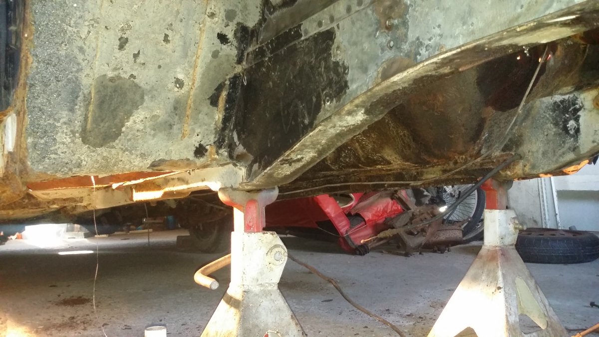

    Thanks again everyone. I LOVE the stance of the High Life and The Bird. Thats how I would like to get this one set up. As you know, this car doesnt have any torque boxes so im going to build them in. Starting up front and working my way back, im going to plate off the front of the frame then start, haha, building the frame with 2x3 1/4 in thick, or would that be to small? I dont think it will be but I have also never done anything like this either so thats why im asking. Then try to build in some torque boxes then braces from the frame to the rockers. My next question is refering to the pic. The hump in the floor that goes from side to side to the rockers, there is nothing under it so should I weld in a brace with the 2x3 in there, from the frame to the rockers for extra support or would I need it if I build the torque box? Guess I better get the jack stands moved out to the rockers and get the car level before I start cutting anymore. Please feel free to chime in on these question please and add any other info im not thinking about or overlooking. Thanks for the help guys. photostudio_1483455579663.jpg

    Not sure the rockers are going to like supporting the car.

    Your right gimpy, should I just put them under the front corners of the frame then? I just wasnt sure if I should put them under the frame since I will be working on it, thats all.

    1/4" would be a bit overkill for thickness for frame rails. 1/8" or even slightly thinner when it's all tied together with a cage would be plenty strong enough.
