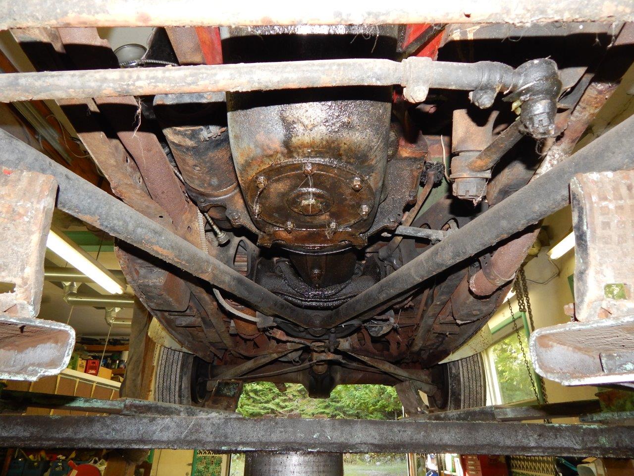

    We will see if you still like the car after I post the pictures of the underside :)
    I call the underside a "dogs breakfast", it's kinda "messy" it's functional but far from pretty, I think a clean up & a couple rattle cans of something will make it look better.. plus, I remember reading that lots of customs & hot rods from back in the day looked really nice on the side that people saw, but it was a whole other story on the other side ;-)
    Looking from front towards back...

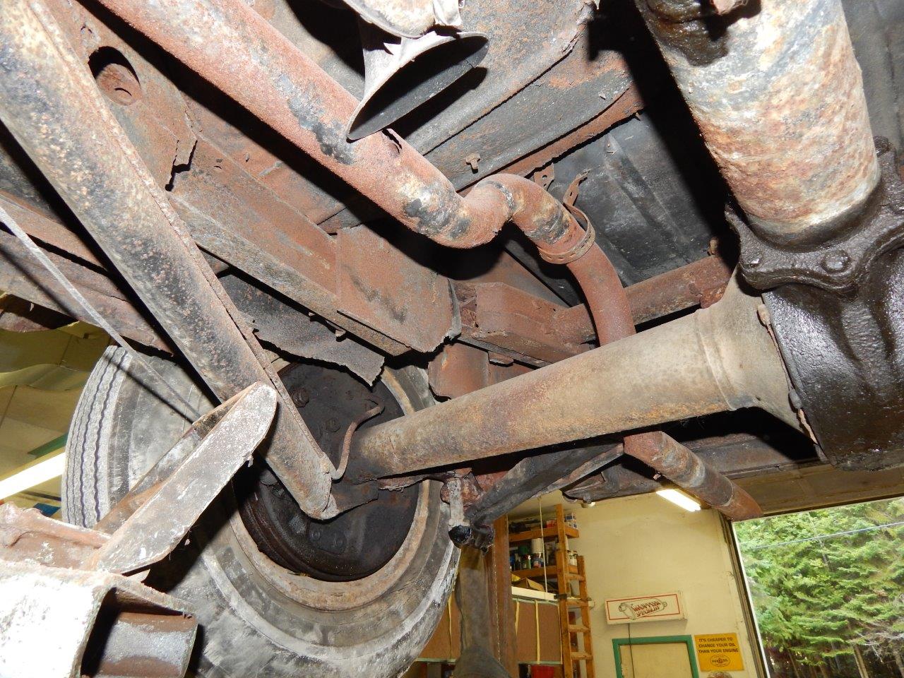

    and then the X-member from the 47 Merc was "trimmed to fit" also note the "fitting" done the the floor pan from the 47 Merc as well above the drive shaft :)

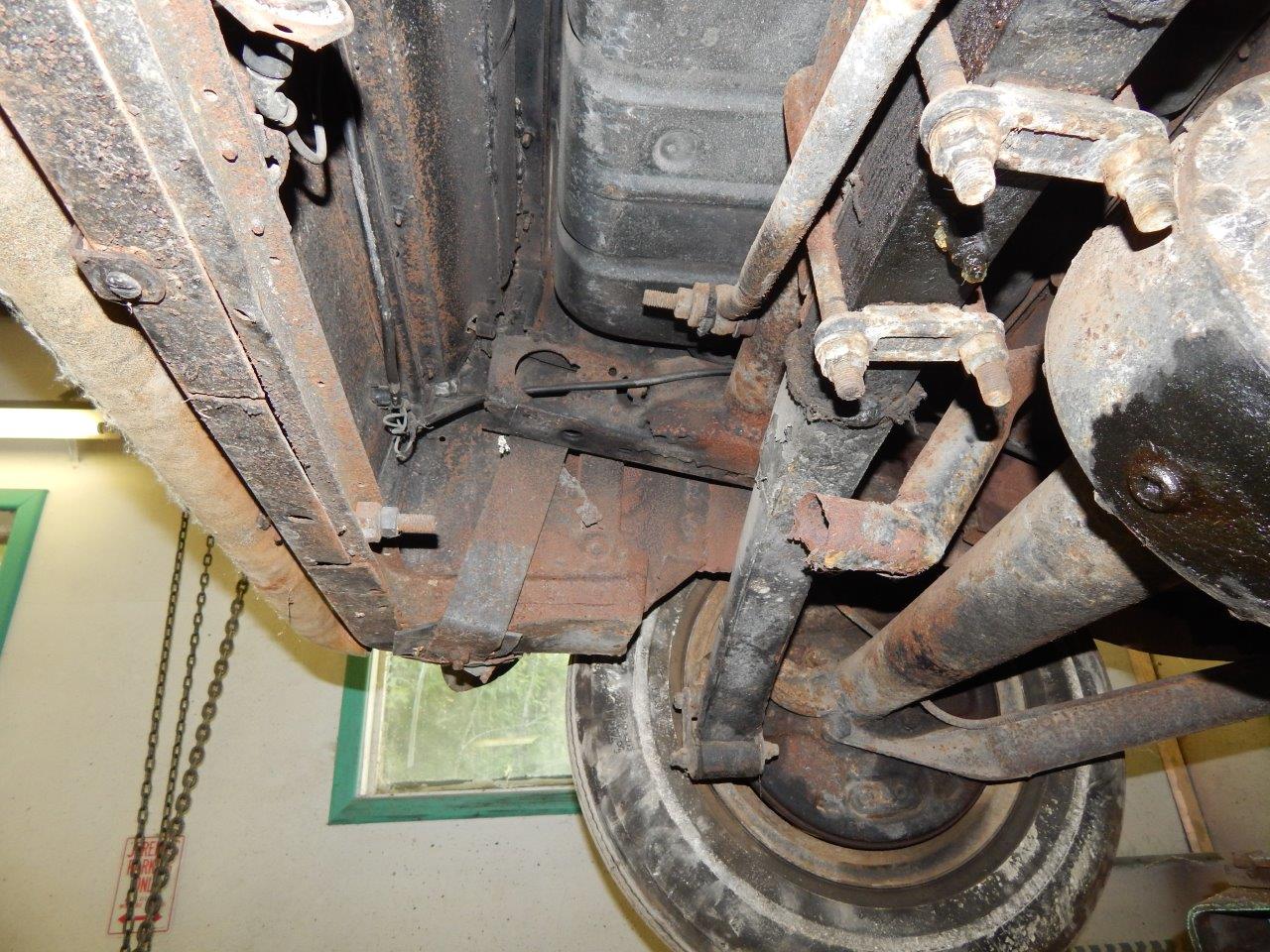

    this one shows the 1/4 plate brace that was applied when the rear frame was bumped up & the Merc rear suspension fit in...
    and then this shot showing the 1/4" metal strap from the frame rail down & under to saddle the body for a body mount on the rear... (note the remnants of the old exhaust pipe)

  12. Yikes! Par for course, for the era....though. It is what it is, and it is what it ain't. Oxy acetyl and hammer build not TIG and CNC. Oh well....so what.....the beauty queen has a hairy bush. I'm still down!
    Atwater Mike, Jrs50, Woogeroo and 4 others like this.
  13. Don't let it bother you too much.
    If the car drives straight and the body doesn't squirm around on the frame,
    just find an old gray beard welder that can tighten things up and re-weld anything that looks suspect
    or unsafe.
    Oh I didn't see any shocks on the rear.
    If you add them, use what was available in 60's.
    I'm sure some guys on here have an old set of rears that are still good,
    and probably even an old mounting kit!
    Look on the brite side, you even have cross steering and a panhard bar!
    Robert Crosse likes this.

    Okay, there more the one kind of beauty.
    And this will do.
    If it was mine I would go thrue all the welds on the frame, and fix broken, leave the rest.
    And a would'nt change anything on the body or the finish on the welds.
    But I would give it some kind of protection from dirt, water and other harmfull things.
    Those fishplating things shure is stout.
    But rather look like that, then nothing in there place.

    Agreed and original builder & second owner commented that it rode well, tracked straight etc. So I'm not too concerned, also it does have standard " tube" shocks mounted on top of the axles, and go into a rienforced top mount inside the rear wheel well lip that the fender used to mount in before the fenders were raised.. so I just have to get some measurements & get some replacements.
    Yes I will only fix what needs fixing & repair in similiar fashion, I will spray something to ensure that surface rust doesn't turn into rott, probably a normal black undercoat that wears off over a period of time, I see evidence of that being used on this car before, I dont want to go with an epoxy or POR 15 type solution as that requires lots of suface prep, and just would seem out of place on this car ( to high end) ha ha - yes we have inspections , one time only - car has to meet requirements at time of manufacture (no seat belts required etc.) no leaks into interior compartment, no exhaust leaks, brakes have to be in spec, suspension tight, no rotten holes or cracks in frame, lights working, glass in place & in condition to not impair drivers vision etc. Independant shops ( non-chain) are best to go to as they work on older cars & are more familiar with requirements for older cars, not concerned about that.

    What Tony M. said....clean and straighten, make it SAFE.
    Re-do the frame mods if there is any question at all about the welds.
    Snoopee has some fleas...so what.
    Just don't let him bite 'ya.

  25. Great story........I think your plan is right on. Not being a Ford guy, I was wondering if that
    round disc with plug on bottom of the oil pan is an original thing or a mod.

    47Plym: From the looks of it, it's a '48-'53 truck pan. It has a junk basket up under that plate.
    Denns1989 likes this.
  27. bowie is right, a sludge cleanout!
