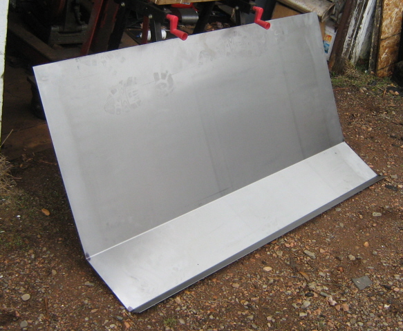

    my firewall was real crappy, plus has the heater motor sticking out and i wont be using a heater, just a fan nicely hidden under the dash to defrost the window.. I made a new firewall with 14gauge, got it bent to my specs, then trimmed it when i cut my old one out.. took a few days to do.. sure helps with a welder.It needs finishing but 100 times better then the old one.
    Go to your local heating/furnace place, get a chunk of 20-14 gauge steel (I payed 35. for my piece bent to my specs), make a template of your firewall with cardboard, support your car, cut out old, rent a welder for a weekend, tack it in place, then hire someone to come over and final weld it. a patch job will look like a patch job.
