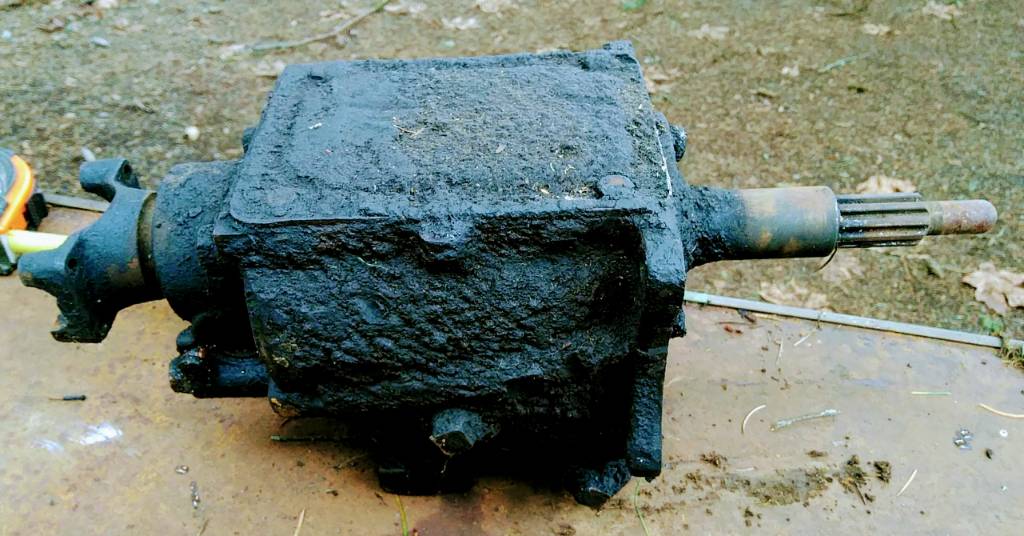

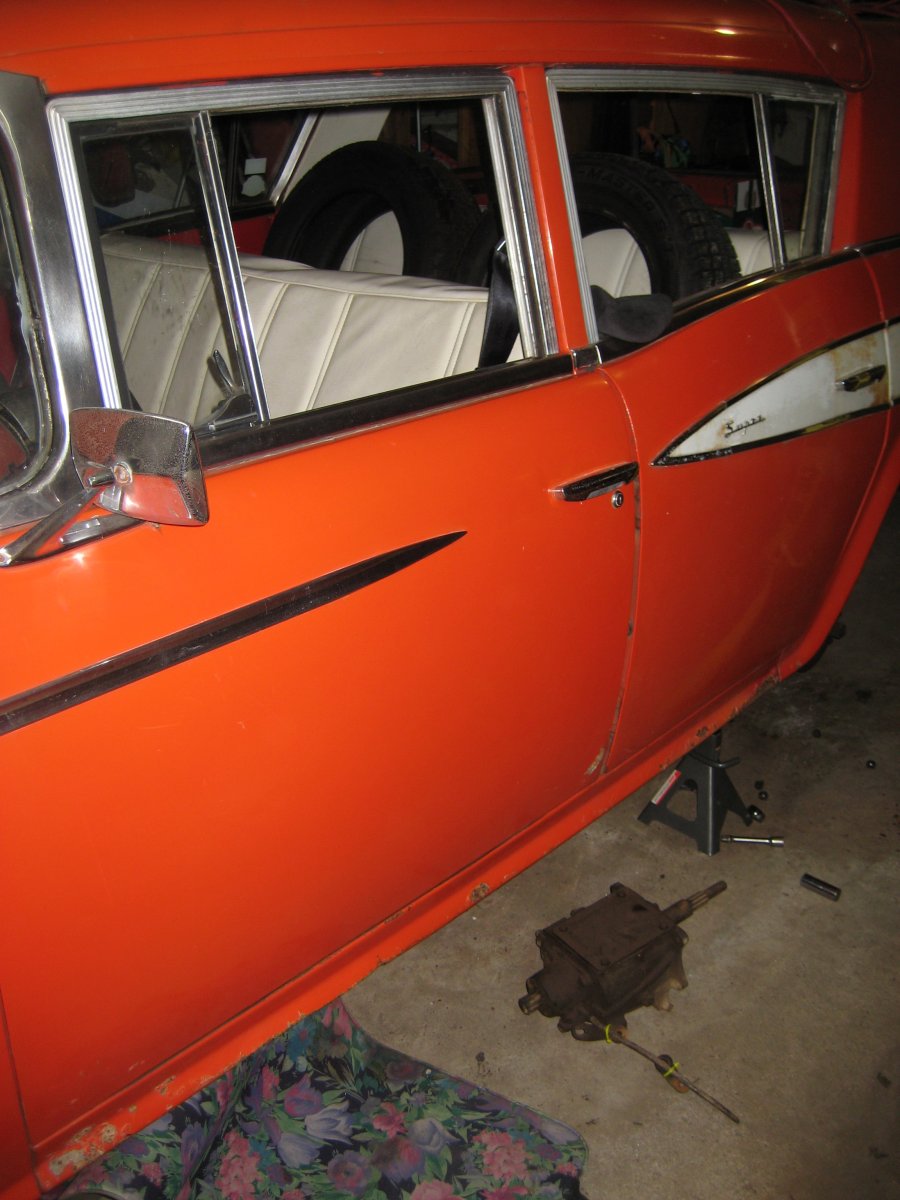

    I found that 1960 tranny from a Rambler American and plan on replacing the input shaft with my present tranny as the American is 3/4 to long in the nose and too wide in diameter.

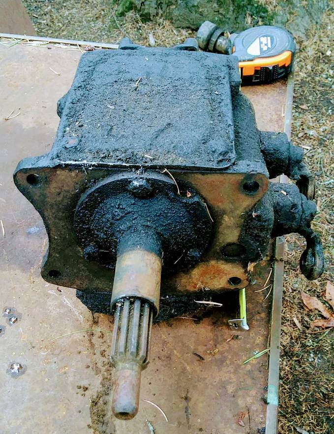

    Removed the countershaft this morning and fished these out of the transmission case. 003.JPG

    Got my small parts kit today in the mail. Input and output bearings are on the way.

    When I examined the parts that came out of the countershaft I noticed there were no washers holding the needle roller bearings in. Could that be the reason it self destructed?

  23. Is the gear machined to accept a washer? If so, I bet they are suppose to be there. Can you locate a tranny breakout diagram? That should show all the parts in the tranny. Also, there is a clearance spec on the counter shaft thrust washers. Often the case is worn allowing way too much thrust travel. In the Olds trannies this clearance is around 12 thousands. Might want to check this on assembly.

    I have the 1958 tech service manual. Yup, there are supposed to be a retaining washer on the outside ends of the bearing stacks. Whoever rebuilt this last time omitted the washers.
