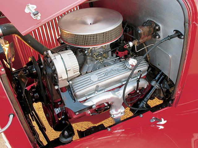

    I'm looking into fabricating a IMG_2822.JPG top pulley riser, to raise the fan, I have seen this back in the day before the water pump risers were available, any photos or other ideas ?

  3. DDDenny
    Posts: 19,132
    Ick!
    Not a great example, hoping somthing a little more finished looking like a sealed bearing in some sort of fabbed casing.

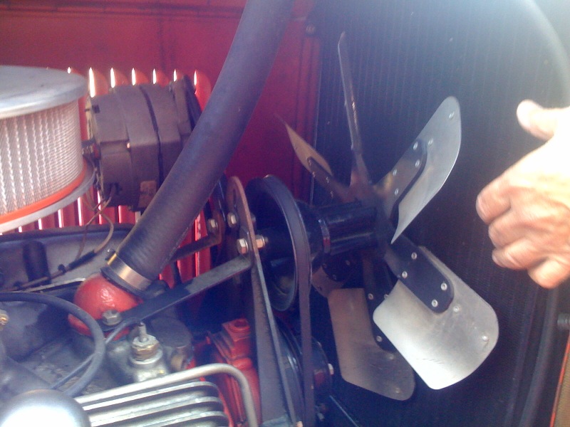

  6. Scott, the photo you posted is of the Gray Baskerville roadster, as you probably knew.
    Here's the other side that shows the fan mount much better.
    Mick

    Thanks for the shot
