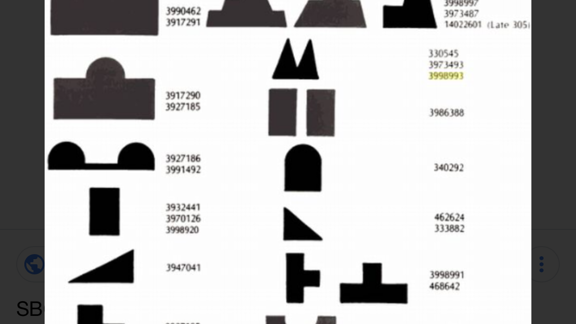

    They look like late ‘186 or ‘492 heads. Those have the camel humps cast almost right at the deck of the head, not on a rectangle. Can’t see it in the photo but does that passenger side head have a 3/8-16 bolt hole for an accessory mount?
    If ‘186’s I think they could be either 1.94 or 2.02 intakes. If ‘492’s they would be 2.02’s with screw in studs and guide plates. But 2.02 valves interfere with the small bore 283.

  22. Fordors
    Joined: Sep 22, 2016
    Posts: 5,410
    Fordors
    D1C60D90-BD70-4890-B5D3-9B4AD1284921.jpeg I just checked the “ D” suffix here, it either started life as a 283/170 in a 1960-‘62, or a 283/185 from a ‘58-‘59.
    And your latest photo confirms that they are likely 1.94 valve ‘186’s.
    Deuces likes this.

  25. The old school period correct 327 camel hump heads never had any accessory bolt holes in them. I have some in my hoard . both kinds the 194 and 202. On a 283. 602 casting 305 heads work great they are small chamber and set up for unleaded fuel.
  26. DDDenny
    Posts: 19,265
    Accessory bolt heads, 1969 and later, I had a set of 2.02's that were the "186" version, but the same castings could also be 1.94's.

    They look like 186s....
