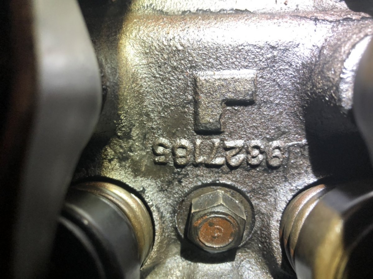

    I realize I am posting to a two year old thread, but I just now took the valve cover off a sbc that’s been stashed in the corner. The drivers side cylinder head has the strange number 9327185. The other side begins with 39.
