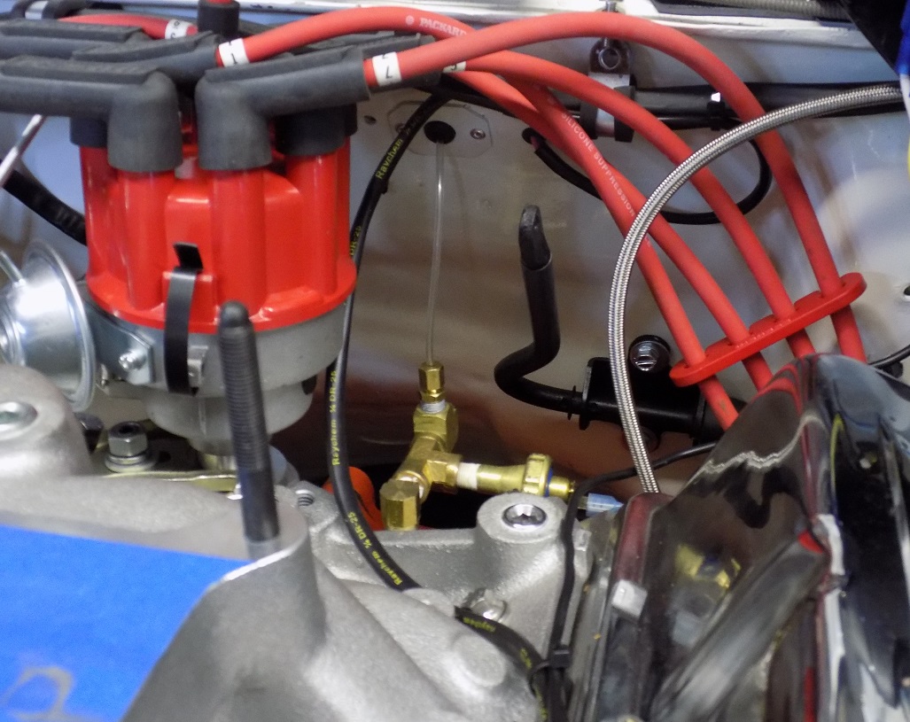

    Early engine primer, or how to discover Oil!
  26. I made up this tree for my oil light and gauge, a little busy and it pissed here and there. The clear plastic line works pretty well, I know copper is better. Now I use a galvanized pipe nipple (1/8") and a matching tee. Lots less joints to go bad, the line goes out the top and the idiot light out the side.

    I know youi changed it from this, but you got a lot of weight hanging there off that brass fitting, I wouldn't do that. Engine vibrations are likely top lead to a cracked fitting with all the weight on there.
