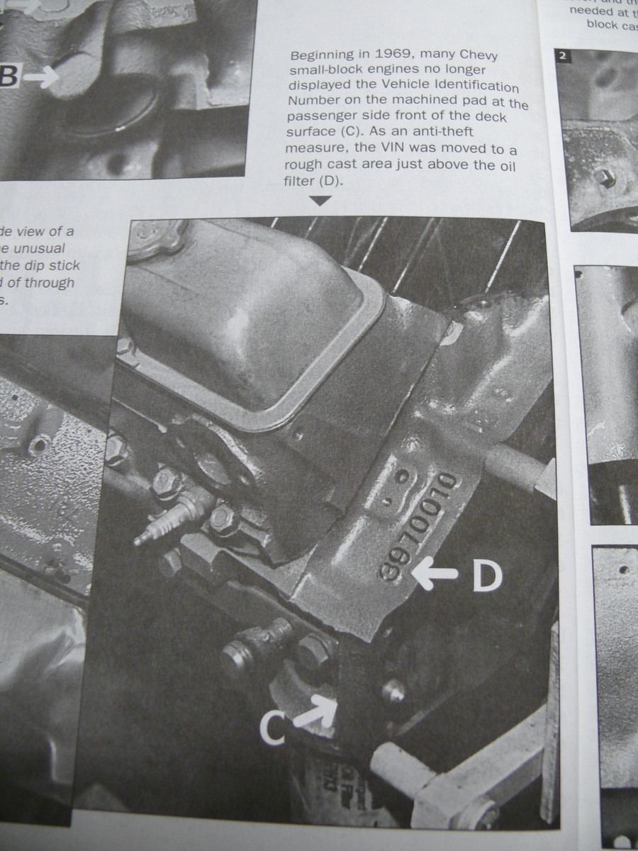

    My mistake - my book only shows 0010 as a 350
    A 302 would be a killer score. Second would be a 327 with a steel lg journal crank

    Also take pics and measure the width of the engine suffix code pad located on the front of the engine right below the passenger side head. Blocks from the '60's and '70's had a 4" long pad...early engines had a 3" pad...and late model blocks had a 1 3/4" pad...approximately.
    This 3970010 block was produced from late 1968 to 1979. If there are no numbers stamped on the suffix code pad, at least the length of the pad could help identify the year also.

    Can you get the #'s off the left front sie pad just below the #1 cyl on the block?
    I ran that piston 7009 p/n, & it looks like an original 1970 LT-1 high comp piston. If that's the case, steel crank & pink rods - killer stuff!!!!
    Can you read the carb & distributor #'s
    If it's a delco distributor cap, does it give a pat. # or "pat pending"
    Real LT-1 stuff is rare

    I went back and looked at the pics closer and you are right...it's got a long pad which tells me it is a 350 block made from 1968 to 1972. Only the date code I asked for will tell for sure. Also wish the suffix code was still on the pad.

    010 block is 350.
    No road draft tube hole ( look at the pics ! ) so its a large journal engine.
    piston part # 7009 tells the story
    so its a 350 with double hump heads and 2.02 intake valves .
    Take a look at the back of the crankshaft where the flywheel bolts up. You can see the parting line..if its a real thin, sharp line its cast. If its wide and flat its forged.
    Garden variety 350 decent engine IMO,,
    No big deal, and yes..I wish my grandpa had left me one just like it !

    7009P is the TRW number for a 350/12.5:1 piston.
    The 462 heads look like they have 2.02 valves, but I don't see the machining that was done to unshroud the chamber on the outside of the intake valve so it's probably gonna be the standard 1.94 heads that have had the bigger valves installed. I'll bet if you flip the head over, it has screw in studs or at least has the studs pinned.
    Just a guess, but the way the rest of the engine looks, it wouldn't suprise me if the bottom end has pink rods, steel crank and is balanced. Pretty standard stuff for a good engine in the 70's.

    Since it has aftermarket pistons (the 7009s will only work with a 350 crank. Yea I know it could have different length rods, but I'd bet money it doesn't) and earlier heads I don't think the VIN will make much difference. You can build as good a hotrod engine out of a truck block as you can out of a Corvette piece.
    If you really want to know what you have, pull the pan and get the crank number. Might be nice to know if it has a windage tray too.
