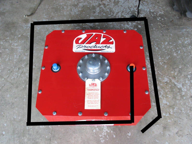

  14. InDaShop
    Joined: Aug 15, 2004
    Posts: 2,796
    InDaShop
    from Houston
    For terminating, lot of different ways.
    -Cheapest and easiest is a Chevy Valvecover PCV valve in the end of the hose for a one way vent.
    -Vented Catchcan
    -Into a fuelfilter (used like a catchcan) like the FRAM G6567
    For routing I use #1 below in my race car if that helps.
    1. Route the line three sides then down.
    2. Route the line following the FATS system (Fuel Air Trap System)
    From the vent/valve the hose extends to the left past the left side of the fuel tank on a slight angle past horizontal (See reference to horizontal and vertical reference lines.).
    Once past the end of the tank, the fuel line is routed upward, again not quite vertical, but angled slightly.
    Again the hose is routed to the right, completely over and past the right end of the fuel tank (Not quite horizontally).
    And then lastly the hose is routed downward to a level close to (or below) the bottom of the fuel tank.
    Hose routing is vital, for this routing is what makes the FATS design work.
    Again, hose routing attributes are:
    · Left-to-Right or Right-to-Left hose routing must always extend Past the Sides of the Fuel Tank.
    · Vertical and Horizontal hose routing must not be square, but rather sloped so as to allow any fuel in the lines to drain back to the tank.
    · Hose should terminate as close to the bottom of (or below) the fuel tank
