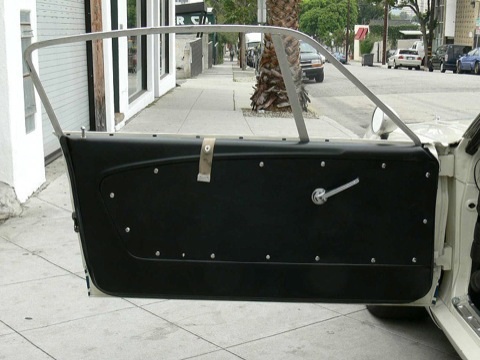

    You could do something along these lines, a canvas strap that you pull on to lift the window with a catch to hook the strap onto when the window is up.

    Seems like if you stick to the KISS principle it should be pretty easy. I'm envisioning a long vertical slot in the center of your door panels with a knob connected to the metal frame at the bottom of the window. The knob is on the passenger side and can be loosened or tightened to hold the window at the desired position.
    Or, instead of a knob how about a leather strap with holes like on a belt with a pin on the window frame. Seems to me I've seen that on an older English car.
    Just like the one that pmangelos posted!

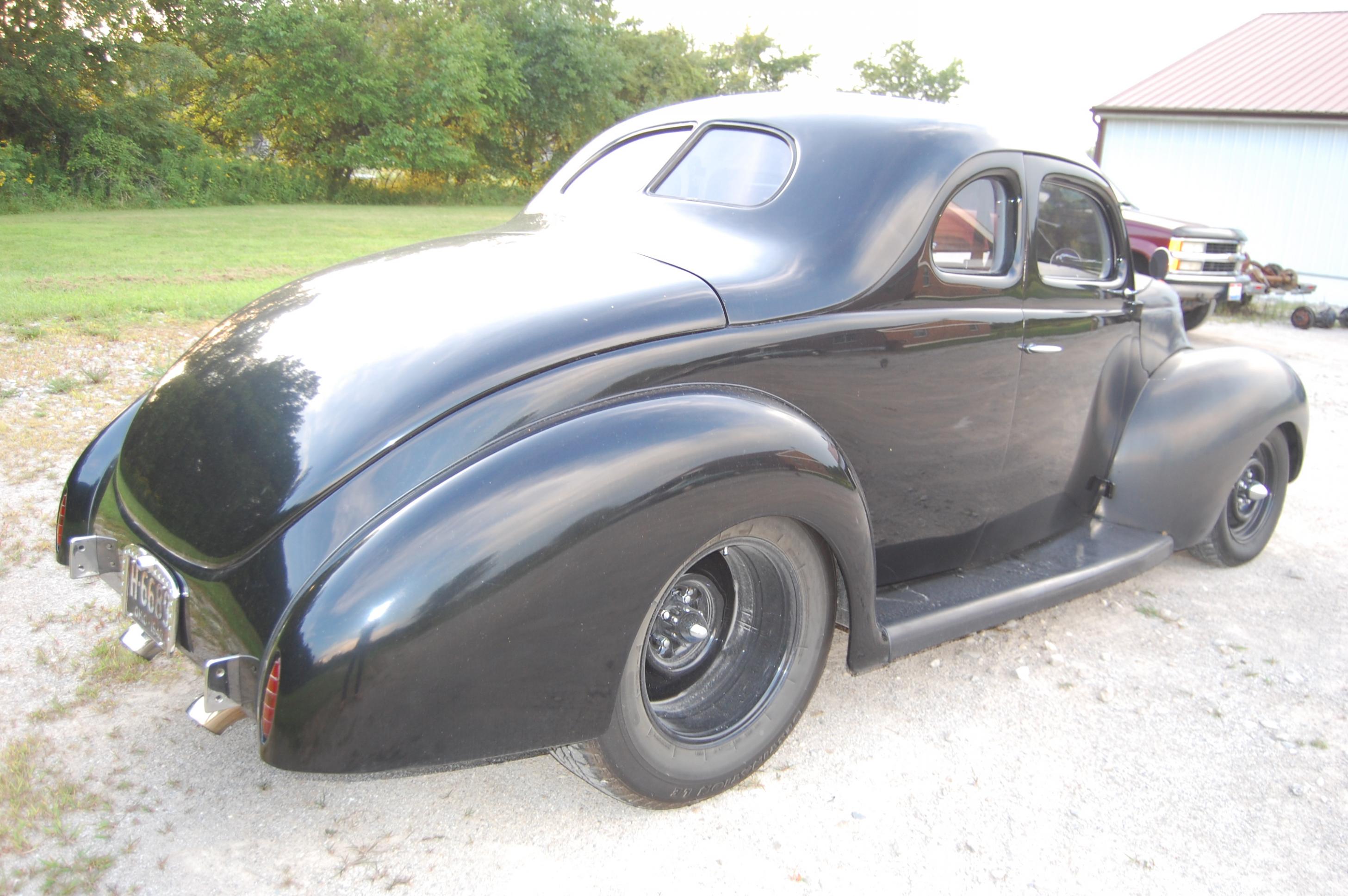

    I did this on my '40 coupe when I was a kid. I chopped the top 1 3/4", So then all the vent wing and stuff would not work. I was 15 and had very little money, so that's the way I drove it for a long time (until I was 32) :D.
    I used an old pair of seat belts...when the seat belt was latched,it held the window up. When released, it fell down on stops inside the door. It would be even easier on a Model A.
    This was an old drag racers trick That my dad taught me to save weight, so it's traditional to boot:cool:
