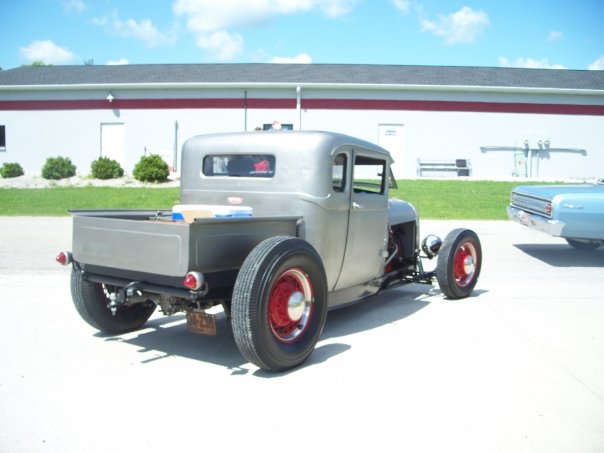

    I agree and have used tons of Langdons stuff. Its his fault that my Model A has a 322 GMC , four speed and quickchange. :>) model a.jpg
    loudbang and waldo53 like this.
