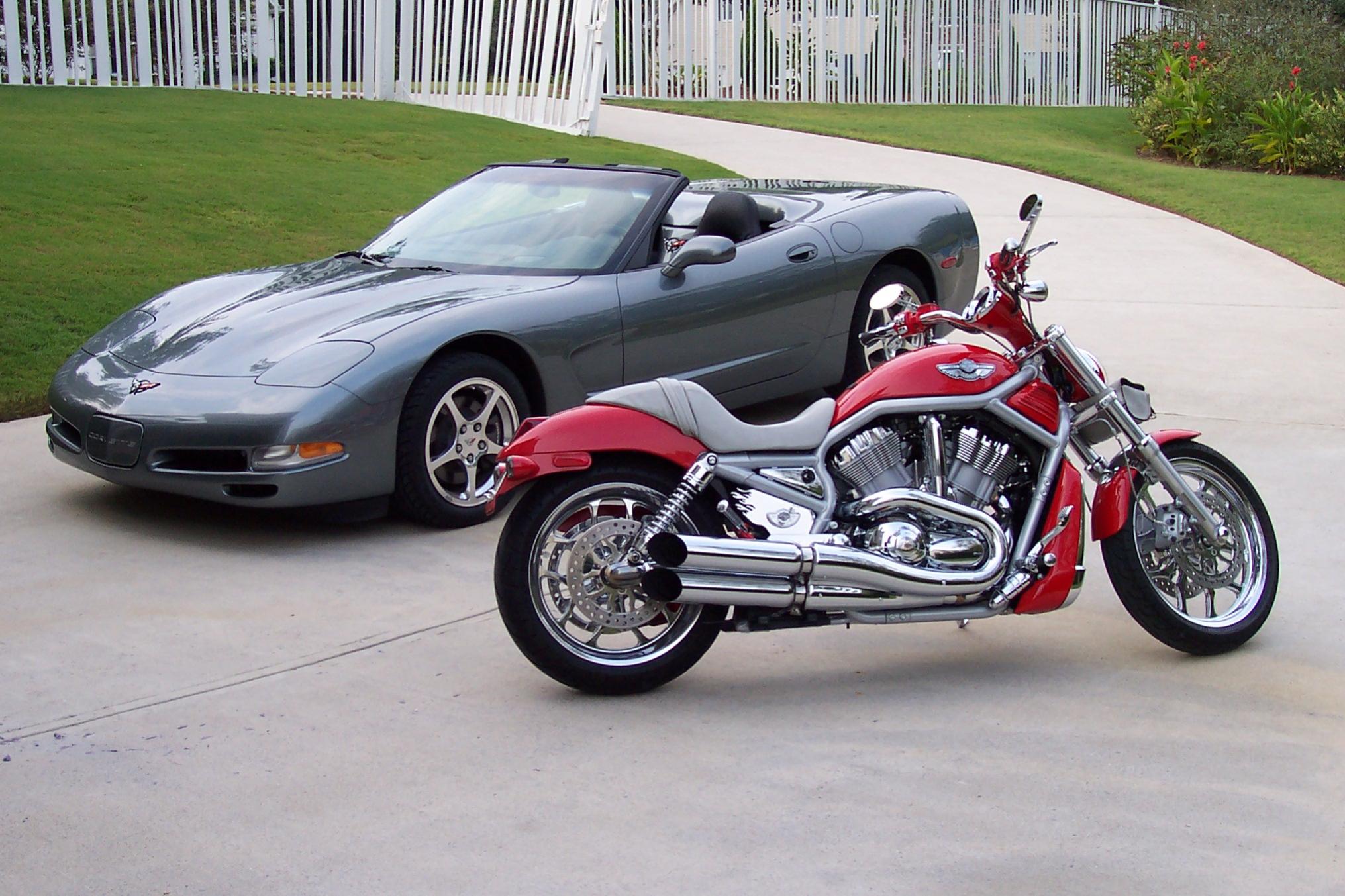

    See attached picture. The Corvette is factory paint. The Harley V Rod was painted with single stage urethane. I wet sanded and buffed it myself (viper red). It shines like a wet dxxk in the moonlight.
