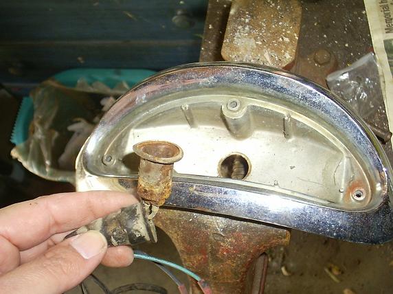

    On this car, I decided to start with the tail lights. You'll be MILES ahead of the game if you have new tail light assemblies to start with, but 55 Chevys ain't all that popular I guess (!), so nobody sells whole assemblies for them...just lenses and trim bezels! That gives us a chance to spend a few hours refurbishing the ratty original housings and sockets enough to make do! (Did I mention that this was FUN as well as "easy"?!)
    The passenger side assembly came apart okay, and with a little deft effort, I was able to get the age-old bulb out and salvage the socket. I scraped and cleaned the contacts, then coated the base and bottom end of the new Sylvania Long Life 1157 bulb with a film of No-Ox-Id compound (more on this stuff in a minute) and locked it into place. I had removed the entire housing from the vehicle by cutting the crusty old wires going to the socket, leaving a short bit to connect the new wires to (they were fine up near the socket, the factory rubber coating and boot up there kept the wires in decent shape for about the first two inches out of the socket, which was all I needed).
    Something I insist on, is that each component have a dedicated ground wire going to it. Sure, the housings, sockets, etc tend to bolt or screw to the chassis and, in theory, should be grounded through the chassis...but one extra wire to each component isn't a big deal, and the payoff is that you virtually eliminate lots of potential 'gemlins' due to a poor or inconsistent ground...especially on older, rusty cars! This ensures that your bulbs will all light, and shine as bright as they should, without dimming, flickering or just plain not lighting because of a poor ground. Any component relying on it's mounting to the metal chassis for it's ground will still be grounded that way, but the added ground wire just makes your job that much more reliable. Think of it as if you are wiring a car with a fiberglass body...in such cases, you NEED to run a dedicated ground wire to each component in order to make it work. I wire my metal cars the same way!
    In this first photo, you can see the passenger side tail light housing ready to install back in the body. Note the ground wire screwed to the metal base down near the bottom of the housing, in the unused backup light area. (This car did not come with the optional reverse lights, and I wasn't adding them. You can see the factory plug over the light socket hole where the reverse light socket would go.) Also note how the harness has enough slack in it to allow the housing to come out this far. This only makes things easier for you in the future, should you need to do any service or trouble-shooting. (The bulb can be replaced by removing the lens only, the housing does not need to come out for bulb replacement in this particular case).
    (Don't ask about the driver's side housing...the socket was so rotted that it snapped and I had to modify a universal store-bought replacement to fit...like I said...FUN!!!!)

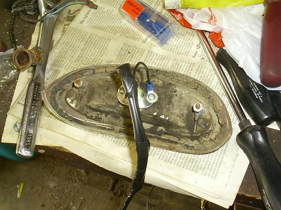

    I took a break to dash off to the local parts store for a new socket, and found two of them in stock. I love it when things go this smoothly!
    Wow...the new socket assembly sure looked pretty! Nice brass terminal ends, a length of sheathing to protect the innards of the socket and everything! How spiffy! The tabs around the socket snapped nicely into the hole, but to insure that it stays put, I opted to use the retaining ring that came with the new socket. A dab of No-Ox-Id on the tabs helped the socket snap into place and would ensure a good 'double ground' to the light bucket, in addition to the dedicated ground wire I was installing.
  11. Fat Hack
    Joined: Nov 30, 2002
    Posts: 7,709
    Fat Hack
    from Detroit
    And here it is! With a couple holes drilled and two screws holding the retaining ring in place (along with my ground wire), I had one parking lamp assembly ready to re-install!

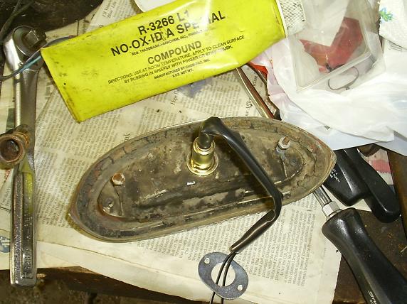

    Now, class...what do we do BEFORE re-installing any component or assembly? Anyone know? That's right! We TEST it, using that 12v battery conveniently located right in the vehicle we're working on!
    I mean, it's a brand new socket with a brand new bulb in it, so we know those sharp Taiwanese craftsmen won't let us down...but still, at the very least, we need to test each lead to determine which one is for the dim (parking light) side of the bulb, and which is for the bright (turn signal/flasher) side of the bulb.
    So, just as with the tail light assembly, we hold the ground wire to the negative post on the battery, and touch each of the other wires to the positive post individually to see which is the bright one and which is the dim one.
    Why do we do this? Read on!
    If you're using quality auto parts, the chances of instantaneous failure are greatly reduced, but in today's world, quality auto parts are getting harder and harder to come by. The local Murray's USED TO carry a brand called Cal-Trem (or something like that...Cal-Term maybe?) and I've had nothing but positive experiences with them. But, they recently switched over to Doorman electrical products, and I've had lots of problems with them, so I went to Advance Auto and bought these sockets in the form of a brand called Connect-Tite.
    You can imagine my glee when I tested the lamp only to see a quick spark followed by a puff of smoke! Upon further investigation, I disassembled the new socket after removing it from the housing found an exposed strand of wire touching the inner part of the socket, creating a dead short that arced enough to singe the socket and the base of the bulb...how cool!
    So, that's where today's segment ends! No parking lights until some GOOD old USED (or reproduction if available?) parking lamp assemblies with good sockets in them can be found and purchased! The whole experience underscores a VERY serious issue facing us car folk today...you can't build a quilty car without quality replacement parts...and quality replacement parts are quickly vanishing from the market, replaced with inferior goods from overseas! So, unless you stumble onto an old stash of NOS replacement parts, the quality of your builds is going to take a nose-dive, because the available parts just don't measure up anymore, and once-trusted brands are being taken off the shelf by parts chain bean-counters who see the cheaper, inferior products as a quick road to higher profits.
    But, this emphasizes why I stress the need to test the components before installing them. You can imagine the grief you'll encounter if you go ahead and install all these junk parts and THEN discover that they don't work, short out, catch on fire or whatever else! Better to know this ahead of time and only lose a LITTLE time and a few dollars, then to finish your project only to discover you've got to start all over again!

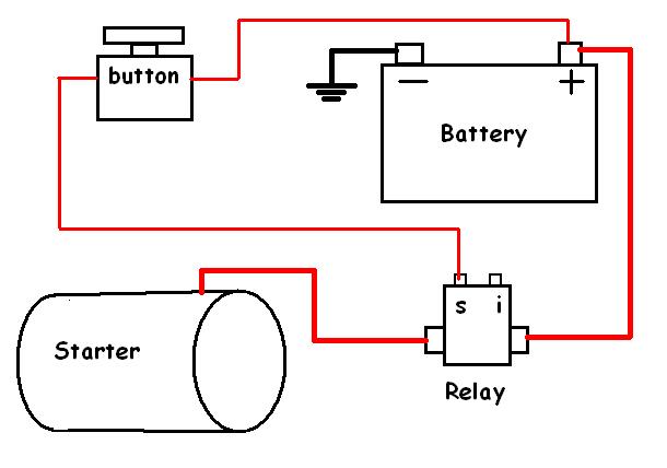

    Care to quickly educate an electricalFNG on the joys of scratch wiring a push-button starter switch for a 289 SBF? :)
  18. Fat Hack
    Posts: 7,709
    Fat Hack
    from Detroit
    That's an easy one:
    A 289 uses a starter relay mounted somewhere on the inner fender (usually). It will have a battery cable run to it from the positive side of the battery, then another battery cable (called a switch-to-starter cable) will run from there to the starter motor. A much smaller wire will be connected to the "S" (for 'Start') terminal on the relay, and there MAY be a second (sometimes un-used) terminal marked "I" (for 'Ignition'). This was used in points type vehicles to provide full voltage to the coil while cranking.
    Anyway, just use the push-button to apply momentary current from the battery to the "S" terminal on the relay and the engine will crank over until the button is released.

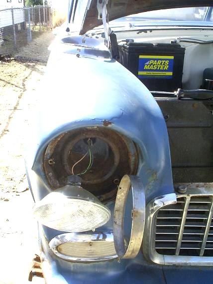

    Today we'll attempt once more to complete the Front Light Harness for this car! I started early, so there should be PLENTY of time to sail right through this fairly simple task, right?!
    Okay, whenever you go to install new headlight wiring, and/or new headlights in an old car, you're never quite sure just WHAT you'll run into, so take a deep breath and prepare to dive in!
    Whew! Not so bad on the passenger's side! I start over here because I make the harness to run from this light over to the driver's side, then back along the inner fender panel to the firewall and ultimately into the interior. I found pretty much what I expected to see here...a crusty old section of the original headlight wiring and a rusty headlight bucket. The brass-plated wood screws or whatever holding the bezel on was a classy touch, but aside from that, nothing too out of the ordinary. The retaining ring was in decent shape at least, which isn't something you can often bet on!

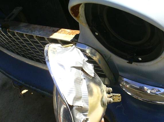

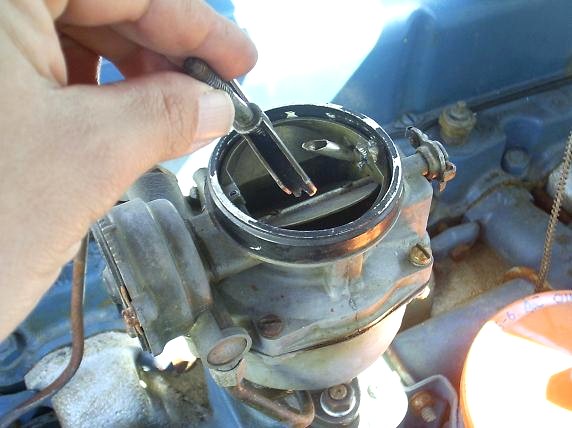

    Well, things were going along pretty good, so I was optimistic that I'd have this job wrapped up in no time! So, with that mindset, I went to remove the air cleaner so I could get my cordless drill in position to pop a couple holes for the nylon cable clamps I installed to keep the harness for the passenger's side out of the fan.
    Hmmm...the air cleaner was kinda wobbly...I wonder why that might be???
    The problem was quickly obvious...the rocket-scientist previous owner had somehow managed to snap the 'bridge' off the carb (where the air cleaner stud goes) and just sort of...you know...left it like that! (Although he did thread a sheet metal screw through the carb to I guess catch the broken part in some imaginary way???).
    FUCKING AWESOME!!! :mad::rolleyes::D
    Add one more thing to the list of repairs! I have an idea of how I'll install a new air cleaner, but that'll come later...in another tech thread!

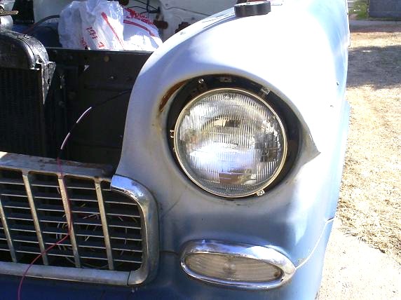

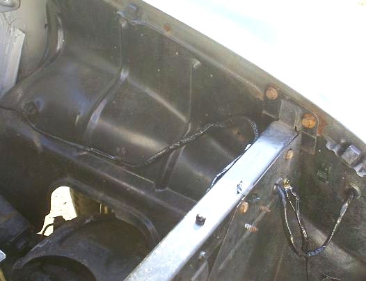

    The wiring for both headlights (as well as the parking lights) was fed through the grommet on the driver's side, and the like-colored wires were spliced together and ready to hook up to single wires running into the passenger compartment through the firewall.
      40.2 KB
      265

    Now, with the Front Light Harness complete and tucked neatly into place, we have a simple, sanitary and reliable harness that will be connected to the proper sources inside the car when that segment arrives! At this point, the vehicle's lights (front and rear) are all wired and run back to the under-dash area for final hook up. That part is pretty easy, as you'll see later...and isn't normally as time-consuming as the harness installation is.
    We'll still need to address the engine wiring and charging system before we can complete our total re-wire, so stay tuned for that fun and exciting chapter...coming soon to a HAMB near you!

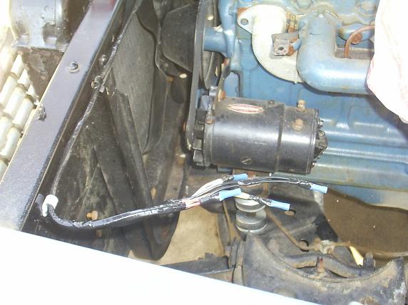

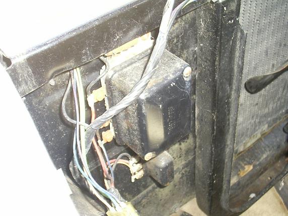

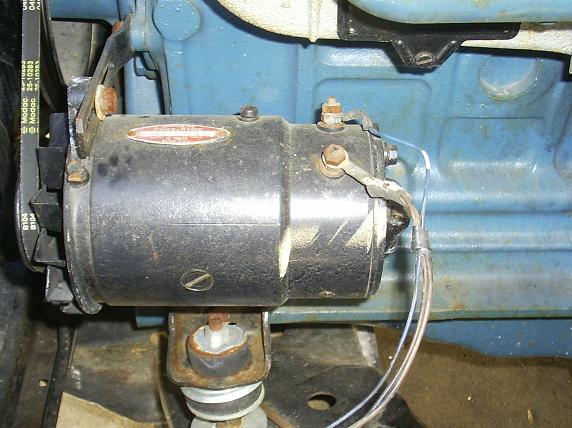

    Okay, we got more parts...and it isn't raining or cold today, so work can continue! :)
    I decided to axe the generator and regulator in favor of a more modern (1970s era) internally regulated GM alternator, so I needed to find a bracket to mount one to the old 235 Stovebolt engine. Luckily, Tman suggested placing an inquiry to Alan Grove Components and I was able to order one for this exact application (1955-62 235 and 261 engines) for $60 shipped. That left me with some down time to get that old boat-anchor generator off the car!
    (Now you're starting to see why it can take a while to complete a re-wiring job...you often have to stop and replace, restore, fix, upgrade or modify components, sockets and such along the way. But, in the end, you'll have a dead-nuts reliable electricl system, so the time spent NOW will save you much grief later on!)
    Removing the generator is a simple task, but be forewarned...they ain't light!! :D
