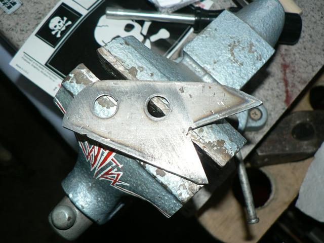

    Welded square tube to round tube, which was heated and oblonged for a little bit of adjustment.
    Upper support plate, plasma cut out of flat stock.
    Mount ready to be installed.

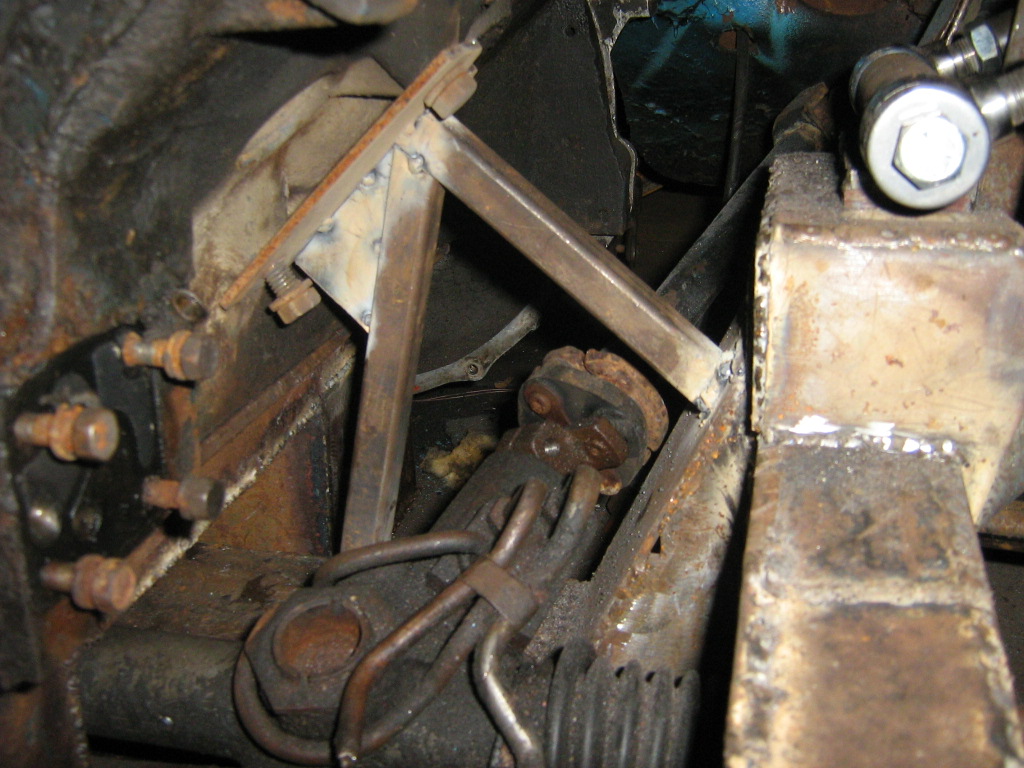

  13. Yes the steering box fits right next to the drivers mount, you can see the box in the first pic.

  16. Here's a shot when I started tearing down, you can see the steering box and the linkage. This is nowhere near as tight anymore as it was in this pic with those old nasty mounts in there.
  17. Looks good. You might want to consider some front-to-rear gusseting. That engine weighs A LOT when you punch it or have to slam on the brakes. If it was all solid you probably wouldn't have to worry, but that factory isolator will let the thru bolt twist a little if the mount tries to bend.

    Interesting use of a Falcon/Mustang/Cougar/Maverick/Comet steering box mounted in stock style position and steering down the side rail by moving the pitman arm 90 degrees on the sector shaft rather than the usual ahead of engine mount cross-steer or upside down mount with pointing up pitman arm for fore-aft steer.
